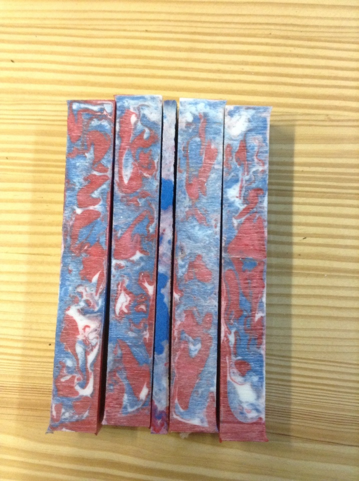

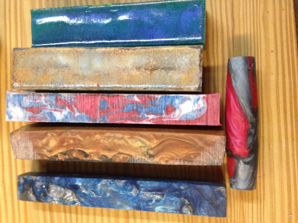

Would you please post some pics of your blanks for viewing? Seems like a great idea to share. Thanks.......Jan
Left to right. Blue and silver with pearl ex macro pearl, black and gold, red-white-blue, silver and gold, blue and green with purple. Bottom is red and silver.

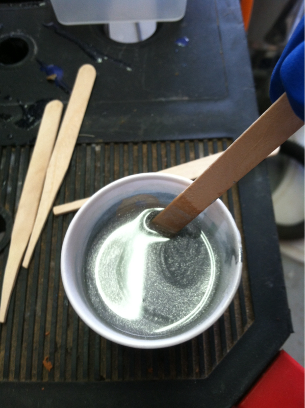

First test underway! I stopped in Walmart today and bought some folk art brand paint. It is acrylic water based paint. I like the color better than the apple barn that was available. When I added it to the poly resin ( silmar41) it thickened very quickly. Enough that it did not mix with the 2nd color, I was using pearlex. So I poured I to molds and put it in pot.
Potential problem!!! There was a little more resin than my molds could hold so I just left it in the cup. It's been over 3 hours and it is about twice as thick as when I poured into molds. Considering its in the upper 80s it should've pretty hard by now. If it ever hardens it will make a pretty color but not holding my breath on this one!

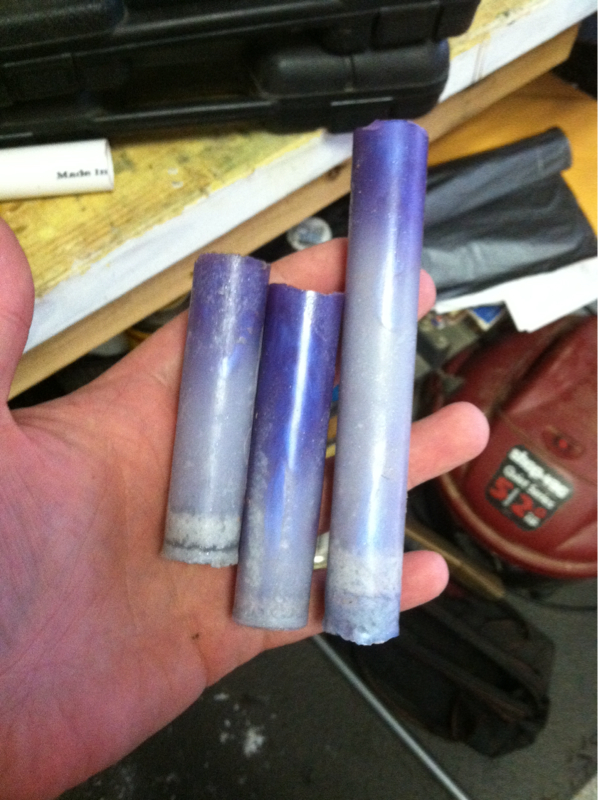

Failure!
They did harden after a couple hours under a heat lamp. But the color is a different story.

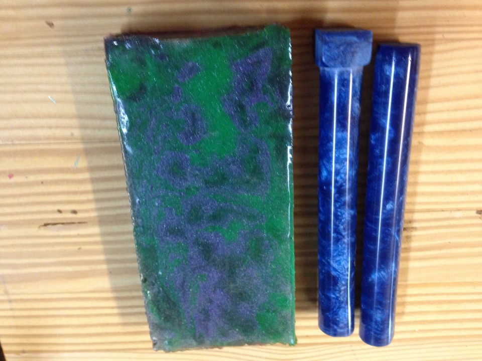

Here is a pic of the blanks I poured with the acrylic paint. The color separated and the purple which was pearlex went to the bottom of the mold. I'll try something different tommorow. Experiment continued...

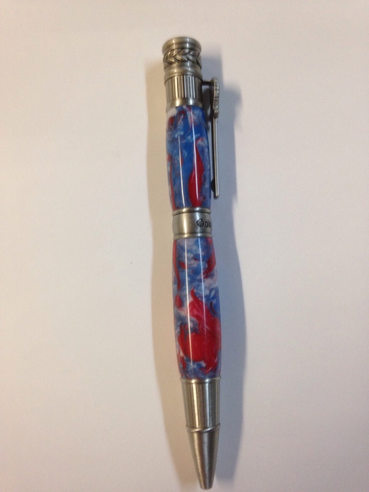

I don't understand it. :( I just poured some more a couple days ago and set them in the sun the next day and they cured just fine. Here is the block and a pen I just finished from it.
Here is the pen. I usually cure them either in the sun if I am doing something else, or with a spare heat pad because I am impatient.

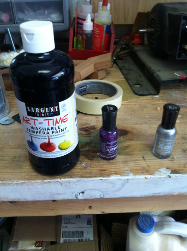

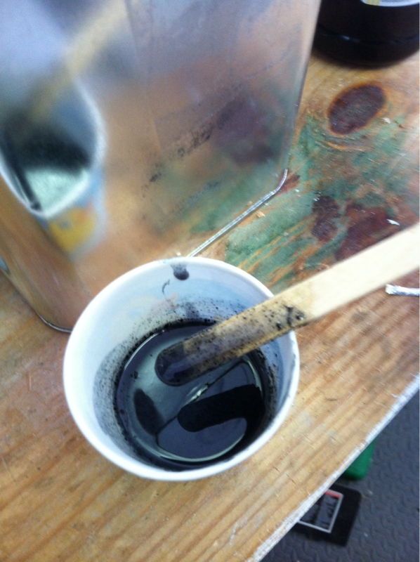

Test #2 included nail polish and liquid tempera paint. I could not find and powder tempera so I thought I would continue this experiment with what was available.
The liquid tempera did not color. It mixed then separated from the resin.
The nail polish mixed well and looked great.

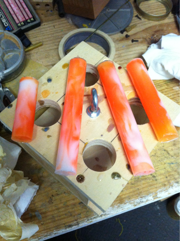

However, there are ways around the problem if you need an exact color. For example, the Tennessee Orange that preacherman is trying to copy can be done easily if you can get paint that is an exact match. All you have to do is mix a blank using white & clear. Then just back paint the blank volunteer orange.
Now I realize that people wanting to do 50 pens a weekend don't have time for this except if you drill and paint 50 during the week, and do the pens on the weekend. But how many want 50 pens the same color. Especially Tennessee orange. :rolleyes:.

50 in Tennessee orange would not even be enough! I will make some of these within the next few week that are a better match ( I have the paint) and I will have very good success selling them. But when it comes to red, I think I would rather see one in Crimson :tongue:
