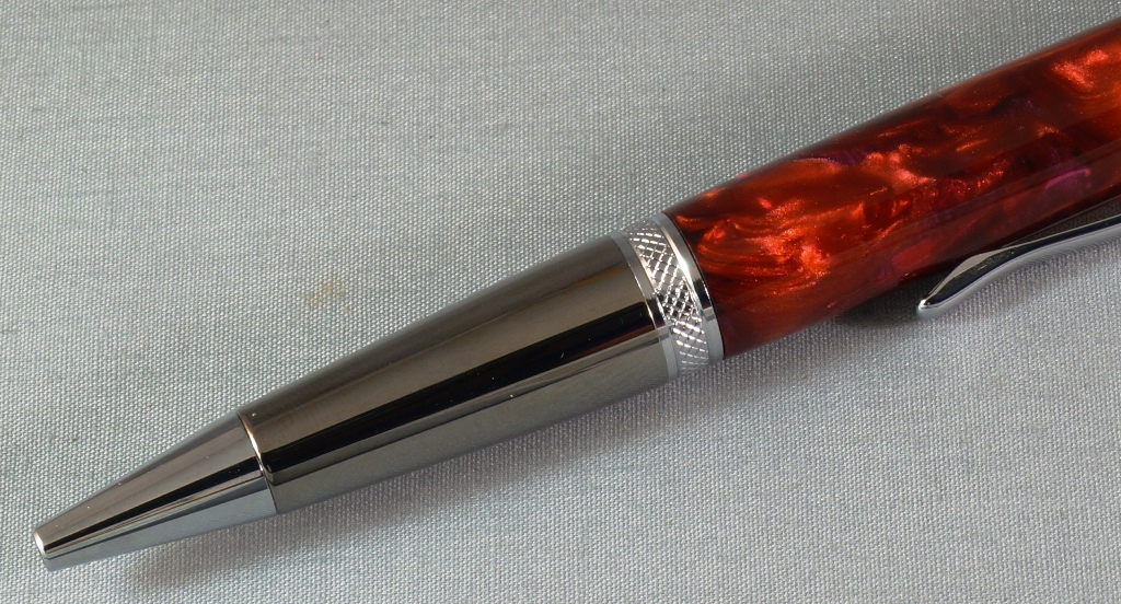

When I started tying to get better pictures, I bought a grey piece of fabric, and used it as a backdrop. When my pictures weren't great, the fabric was fine. And if I use a pen stand it's fine. But if I have the pen laying on the fabric, and want to do a close-up, the fabric looks just plain ugly.
As you can see, it shows everything including stains. Plus, every time I put it up, it gets wrinkled, and I have to iron it before I use it again. So I need something that won't wrinkle, and I can clean off, and doesn't have the ugly fabric pattern.

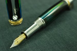

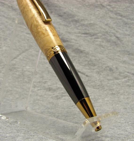

I just found today that a grey background does wonders for my photos. It actually helped my camera bring the pen in focus and so far I've not needed much in post processing to be true to color.
With a white backdrop, the pen was over exposed most of the time.
This is just a grey t-shirt clipped up in my light box.

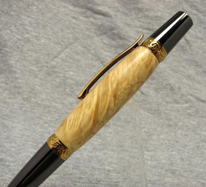

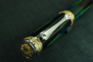

I've been using a medium grey shirt that I didn't wear very much for individual and group shots like this one. The texture is a little smoother, I think, than the fabric in your photo, show more texture from the lighter streaks weaved in with the gray.
Then I think the darker color, coupled with lower light and shallower DOF may help for not showing discolorations and texture when I get in close.
I also like Eric's suggestions of different materials, which I hope to get around to trying some day myself.
ETA: Be sure to click on the photos to get to the larger versions stored in MPA to really see the up-close details.

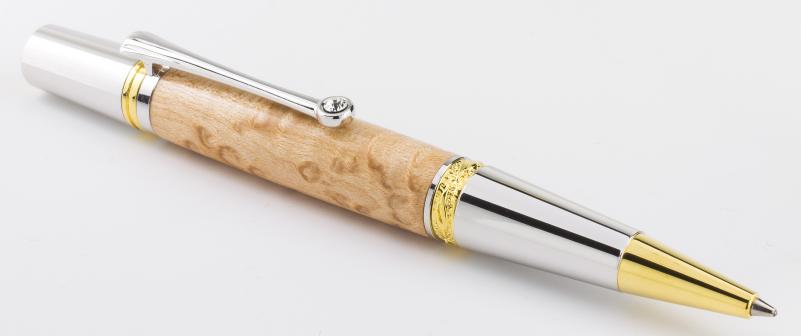

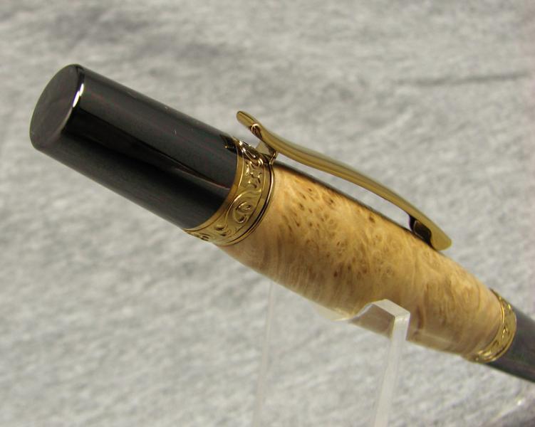

I made a box out of plexiglass that I got at the local home center. Then I spray painted it white. I made a good size block of wood to set the pen stand on and sprayed it white, too. That makes a nice, neutral background that doesn't compete with the pen for top billing. Light coming through the white paint diffuses pretty well and the open front allows direct light if I want highlights - see the sample pic
attachment.php

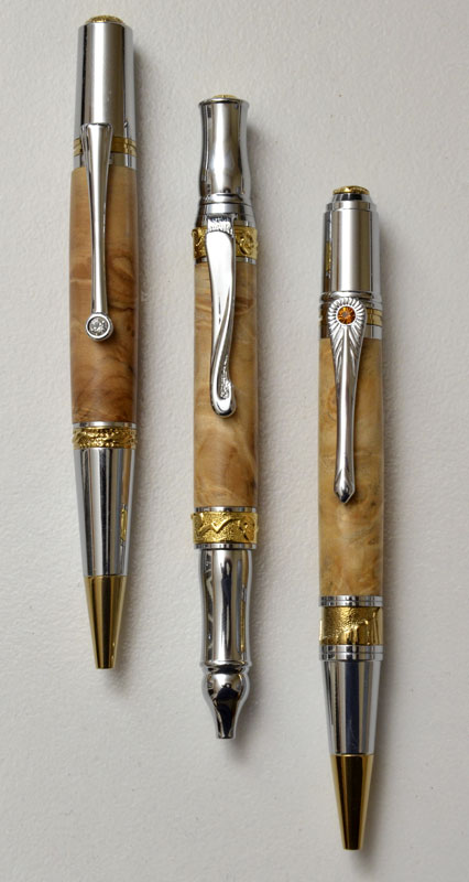

Most people use poster board material. Others use mirrors or tiles. The key is to keep it clean and free of dust. Hard to do with mirrors at times. I do not like the reflective look when looking at a pen.

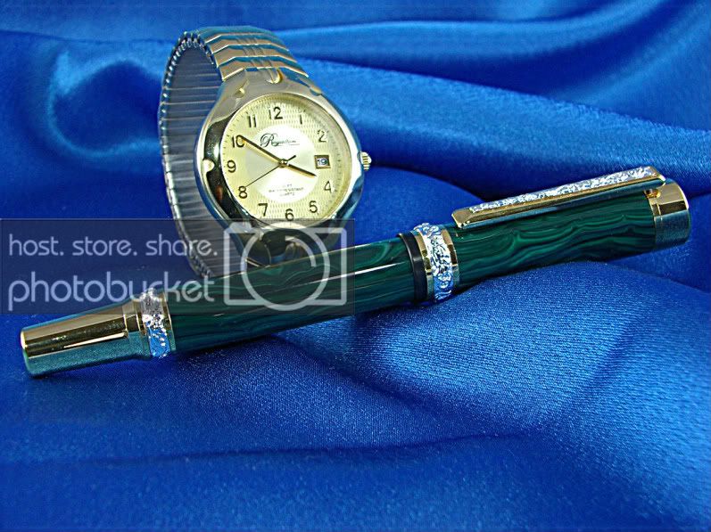

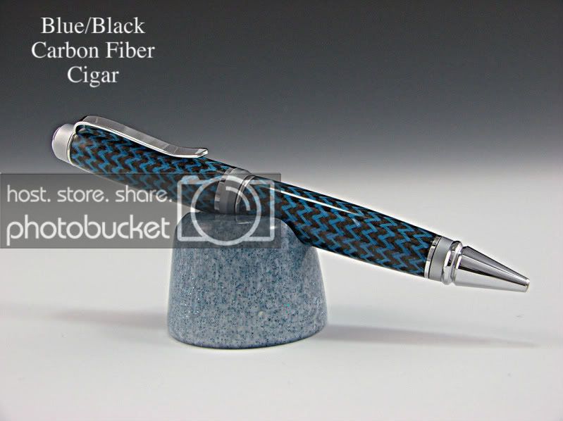

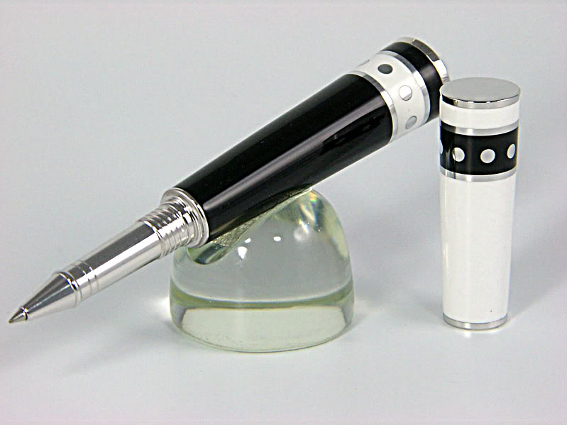

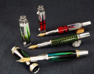

I have used many different things. I probably currently use a grey poster board the most. Just need to match the camera to the setting. Could get tricky at times. Here are some examples of things I used over the years. Things such as graduated photo boards, blue material, blue painted backboards, an artsy look with blue material.
