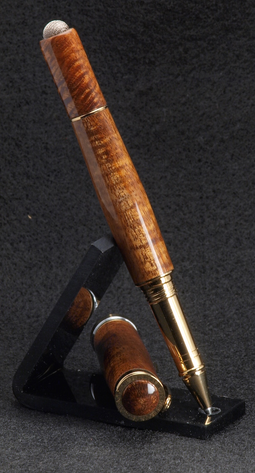

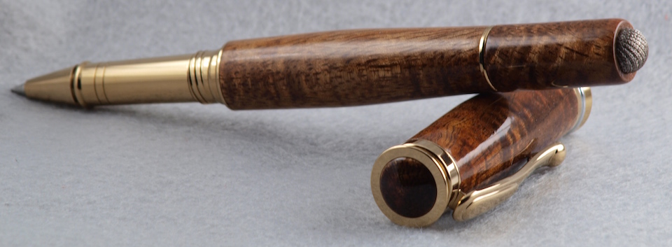

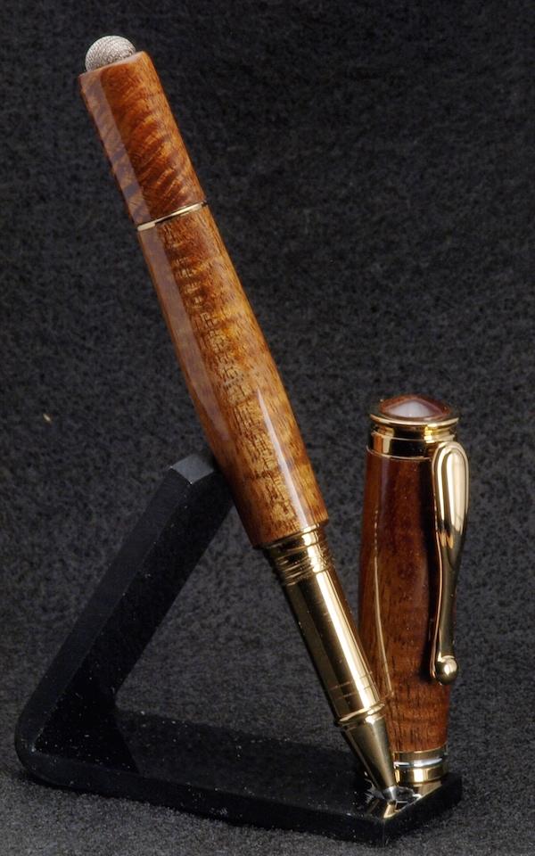

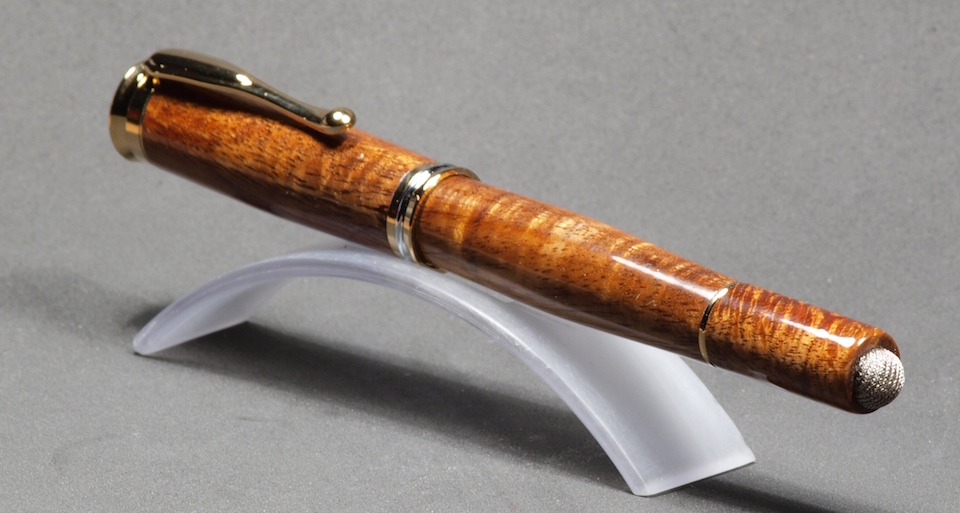

I had a Retro from Lau Lau and thought I would modify it to hold a stylus nib.I was excited about the experiment and how to fit everything together but now I'm not sure of the looks and proportions.
I turned down the finial to fit a 3/8 inch tube. Then turned a small aluminum slug to fit inside the tube. The slug has a smaller diameter to fit the pocket in the nib. I glued the nib to the aluminum slug and pressed it into the tube. The tube has a sliding fit on the finial. The blanks are curly Koa. The Koa used for the stylus end has the same diameter (0.480 in) as the finial ring. The end is drilled and turned to hide the tube. Unfortunately, the drill bit drifted a little during drilling.

Looks interesting, I like the idea of it.
I think if you had matched the wood grain from the barrel piece to your finial it would be little more seamless.
I also think the curve on the barrel piece lends to not making the entire thing look like one piece. Perhaps if you turn them together they will have more of a fluid line.
Just me $.02.
Great concept piece though! Before I read your description, I thought you had made the stylus piece to look like a handheld microphone. That's what it reminds me of.
Best,
Michael
I think that is a neat design. I have thought of adding a stylus to other pens, but have not attempted any thing. Thanks for the idea.
Craig Chatterton
Puyallup, WA
I agree with Michael on the design shaping and the grain alignment.
Otherwise, I would give you an A+ for concept, effort and execution!
Beautiful curly Koa and finish!
Very handsome pen...definitely makes it more utilitarian without comprising its elegance.
I go back and forth between straight CA (when I am willing to take the take sanding) and BLO/CA when I don't want to spend so much sanding. Would you mind describing your BLO/CA finish process? I also can't achieve anything hight then a semi-gloss finish when I use BLO/CA.
I did buy the small HF lathe just for applying the CA and allowing it to cure (without tying up my primary lathe.) This has increased my patience (or allows me to be impatient without sacrificing the quality of the CA finish). :-)
Mike -- hard to tell with the photos, but looks like the stylus tip will have to be held quite vertical or it will hit the rim of wood around the tip. If when you try the different angles, that i the case, think about tapering to a thinner border around the stylus tip to give a bit more relief.
Very nice "proof of concept" effort. The Koa is such a nice wood to work and finish.
I think the idea and execution is great. I agree with others on the taper of the barrel. I hadn't thought about what Ken said about the lip interfering with the stylus. But that should be easy to fix on your next one if it's even a problem.
How long is it compared to a standard retro?
Does the barrel come apart? I'd be interested in see the parts, and how you accomplished the modification. Pictures always help.
All in all, you did great! :good:

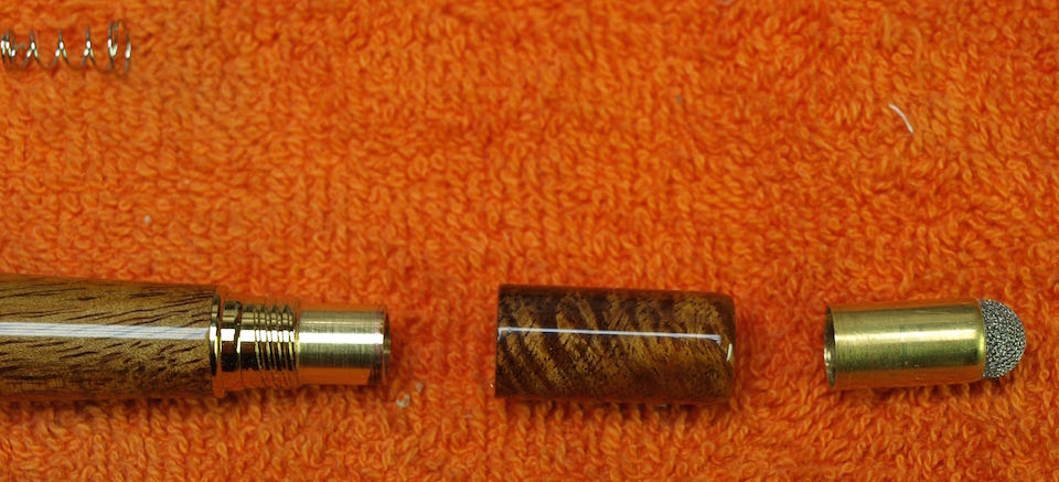

Here is a photo of the parts. The stylus is glued to an aluminum disc that was pressed into the tube. The OD was turned to match the OD of the finial ring (0.48 inch). There are three bores in the Koa. One is slightly smaller than the stylus diameter to hide the edge to the tube and that is about 0.03 inch thick from the outside. The second is tube diameter. The third matches the OD of the step in the finial ring the depth is as deep as the threads on the finial.
