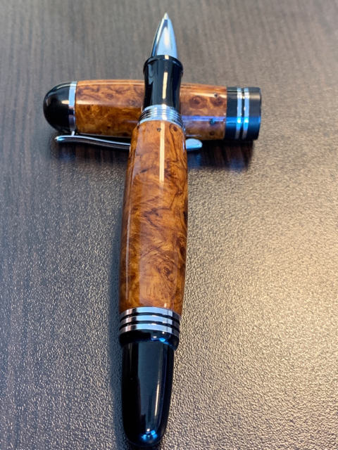

Hey All

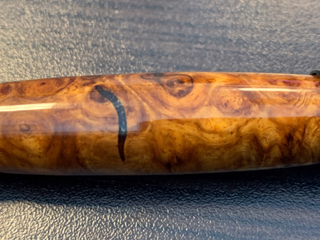

So, last night I started with an absolutely stunning piece of Amboyna Burl. As I started working it down on the lathe I found that the centre has hollows that looked like they were created by insects.
That left me with 2 choices, proceed and finish the pen or scrap it for a new piece of wood. Given that Amboyna Burl isn't cheap, I decided to forge ahead and finish the pen.

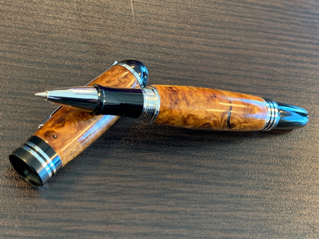

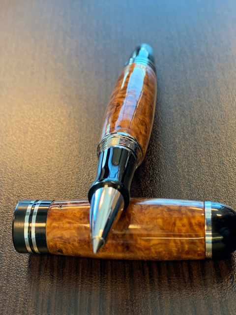

I have to say that I'm glad I did. The pen turned out beautifully and I think the flaws add some character.
What do you do when you encounter large voids or other flaws in wooden pens?
Here are a few pics of the finished pen:
"Pen Turning on the Rock"

Wow...that Blank is Stunning. Very well done.:biggrin:

For your pen - Your remedy is excellent! Subtle, filled the void, did not detract from the basic grain. Well done. Nothing further was needed.

First off beautiful pen! It appears to be a Churchill, one I like the looks of. I've learned to keep shavings from whatever blank I'm turning in a dixie cup, if I get a small void I add thin CA, pack with shavings, and apply more CA. It usually takes a few packs to get the void completely filled. If it's a larger void, I use epoxy with finely ground coffee beans mixed in. For anything larger than a shaving brush the void stays there and usually adds a nice organic look to the piece.
