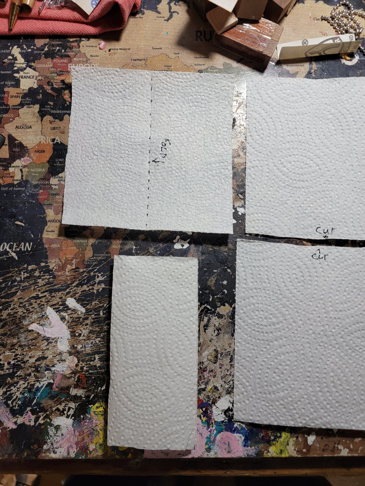

From time to time someone will ask what we use or how we apply our CA finishes.
I'm sitting here watching paint dry.(Actually CA as I haven't turned my shop heat on.)

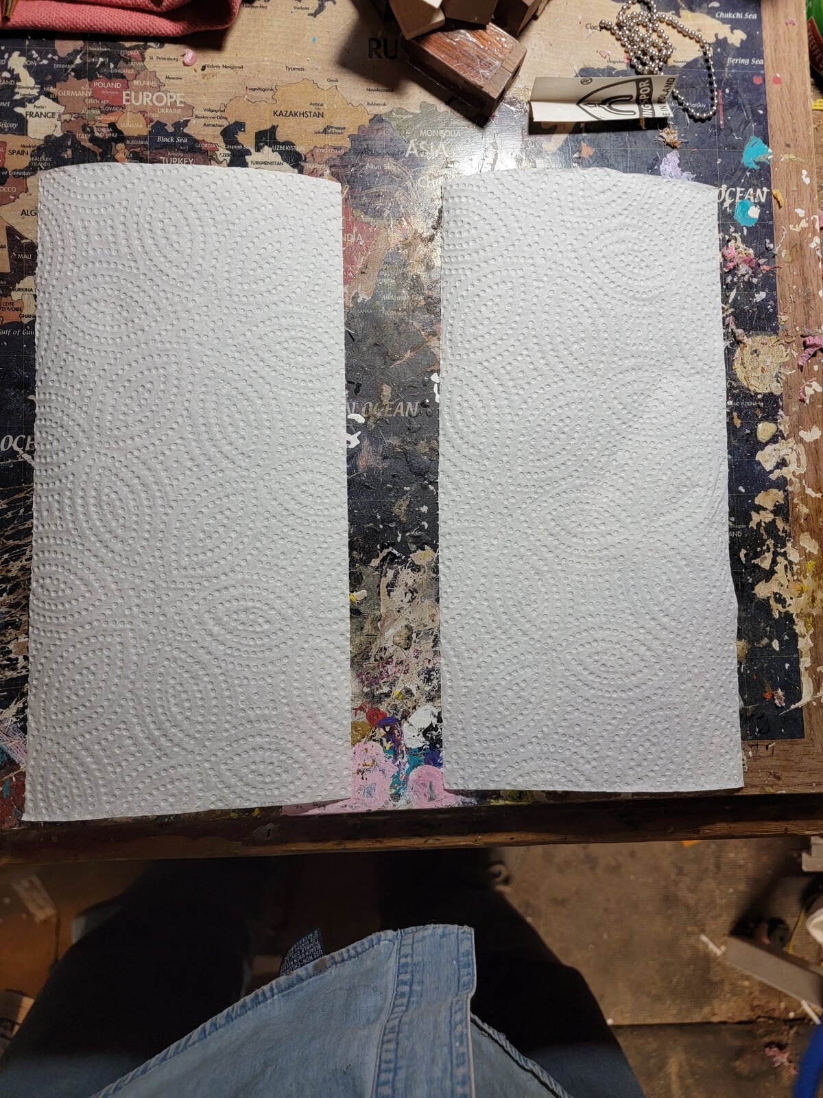

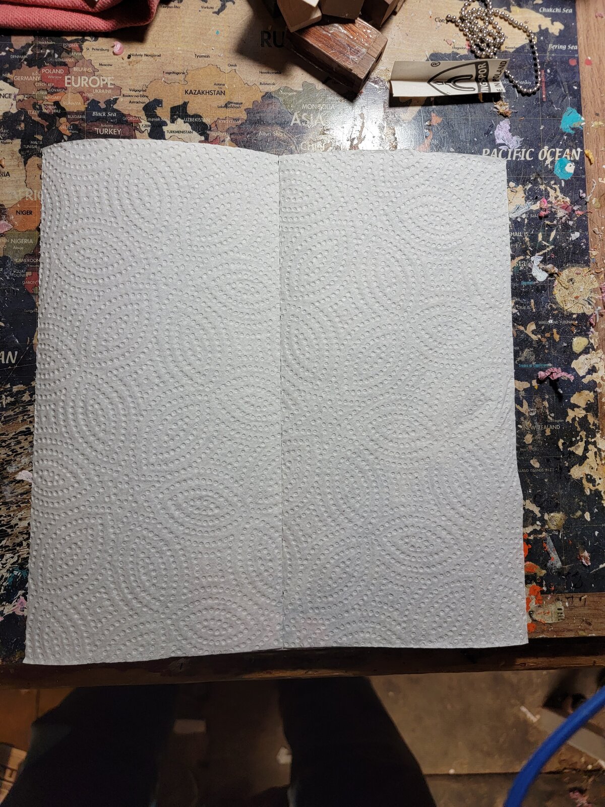

I thought I'd post a few pictures of what I use. Get any good paper towels that tear into the half sheets.

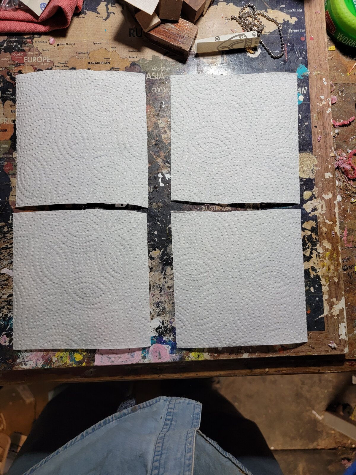

1.Tear a sheet in half.
2. Cut that half in half.

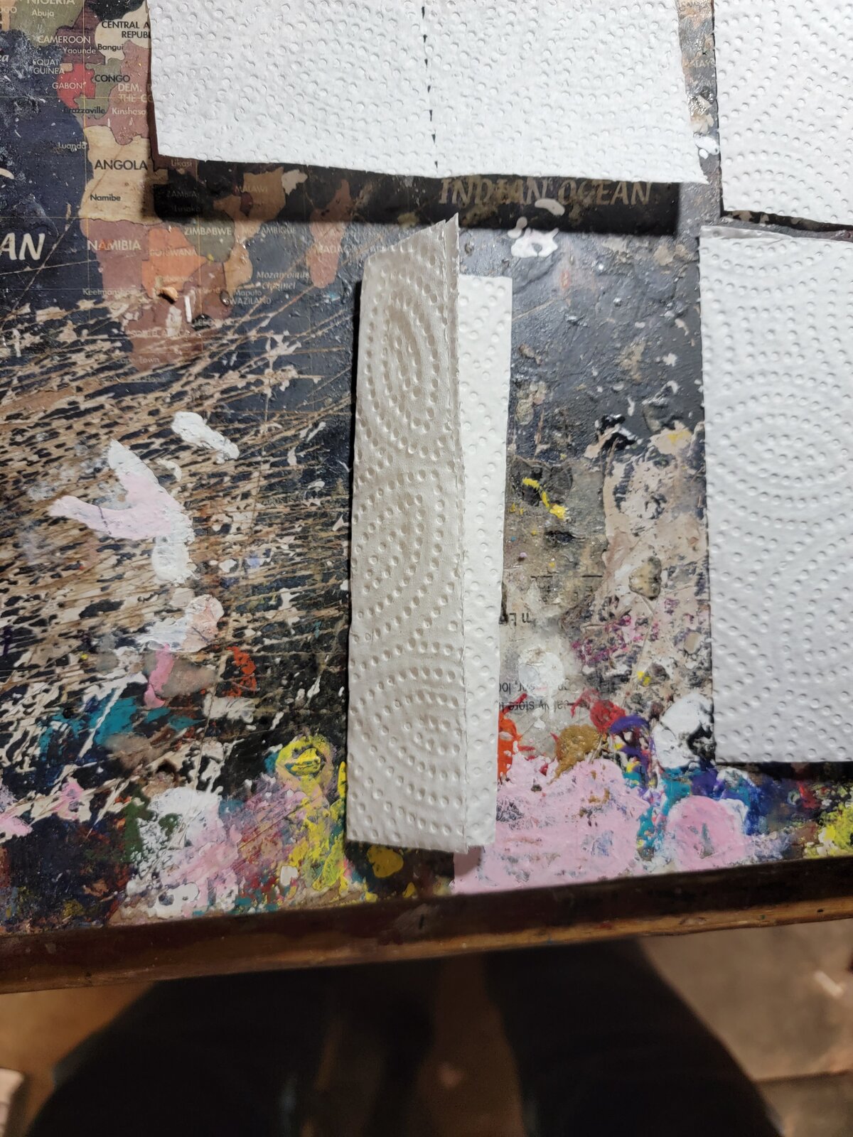

3. Fold that in half. (At this point I stop folding. and stack them in a dispenser I made.

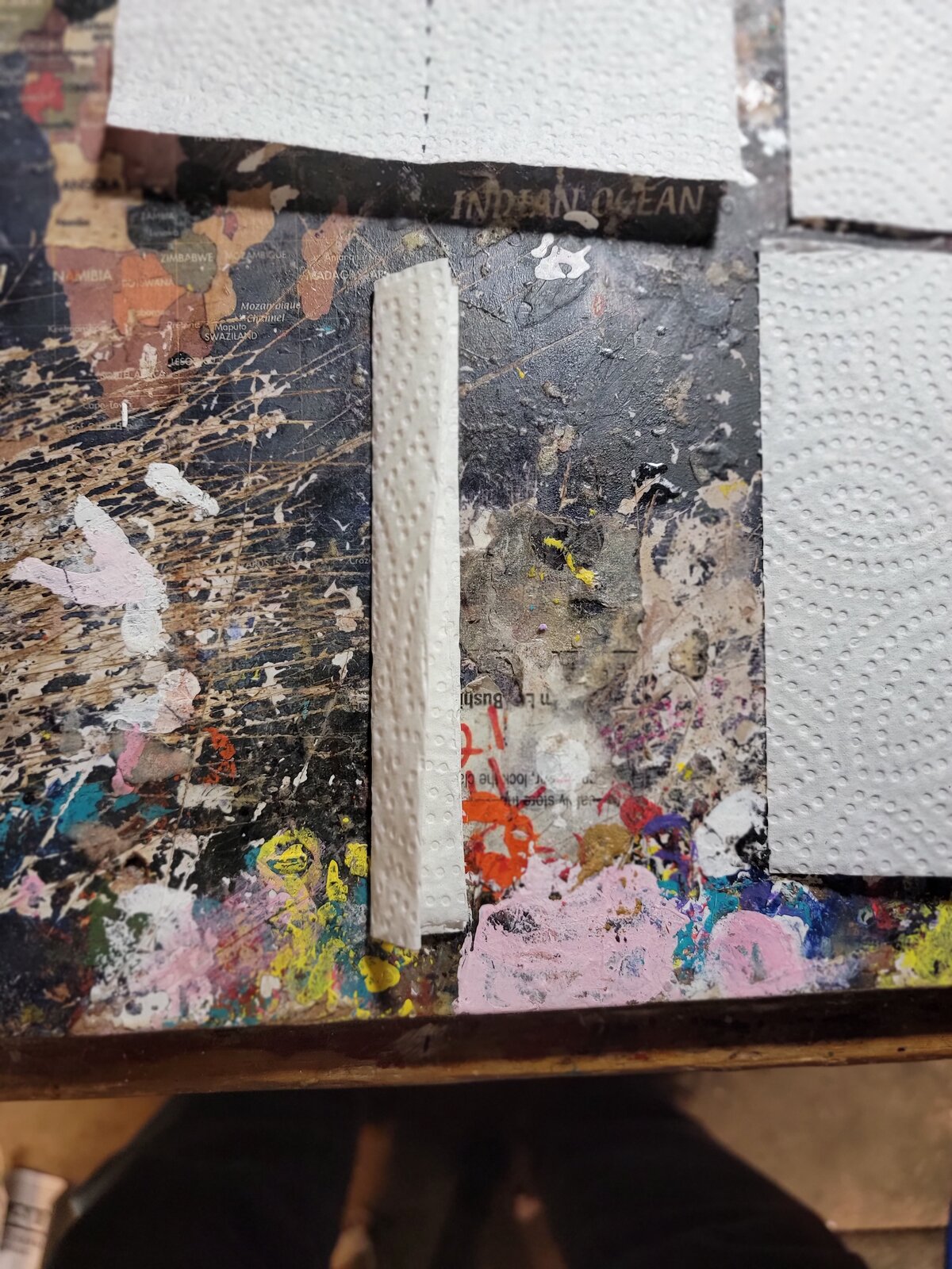

4. Went ready to use select a folded sheet and fold that in half twice.
You'll have a thick strip like in the last picture.
I get about 8-10 application spots on one strip.

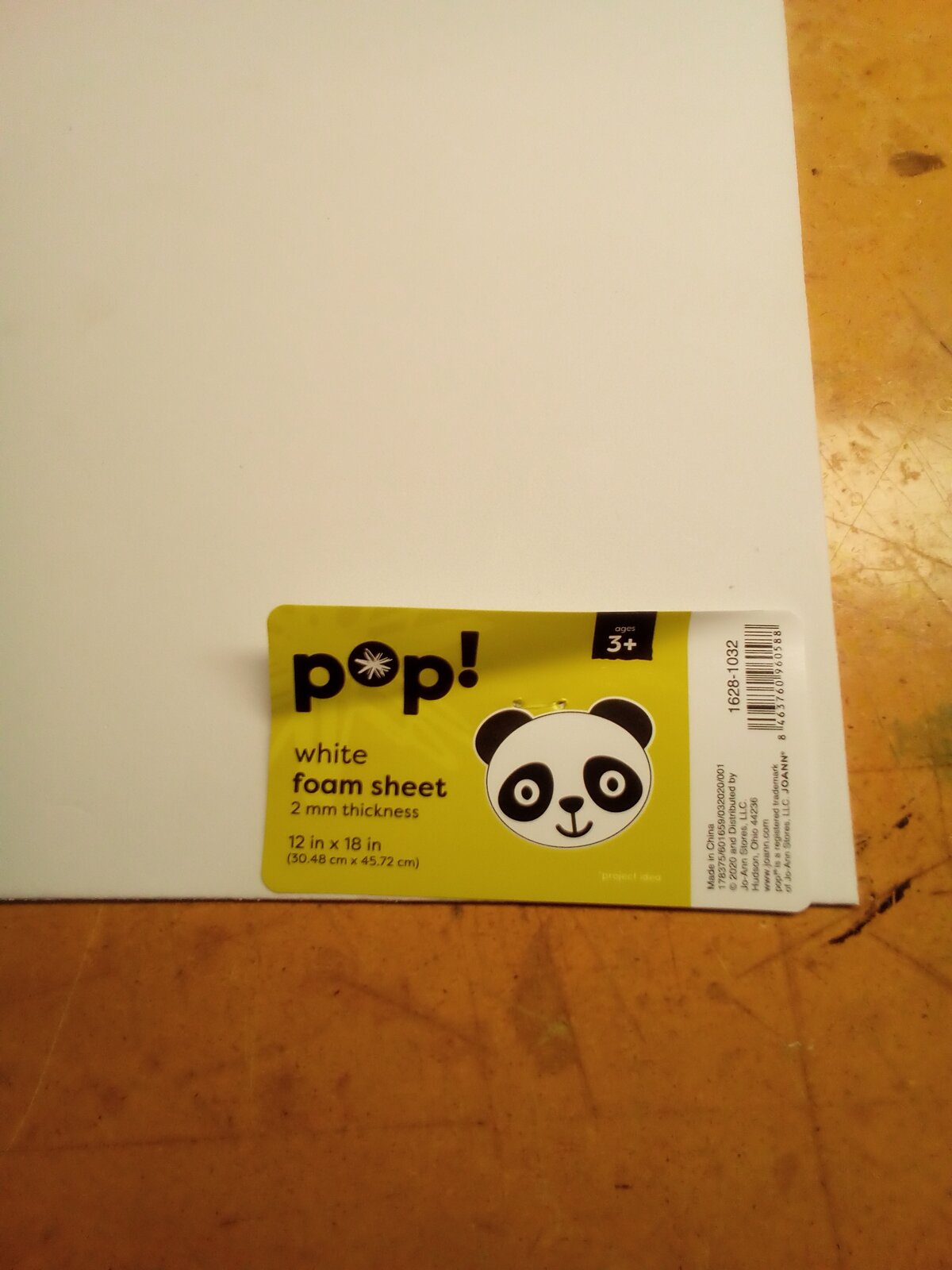

Craft foam is the best for applying CA.
Does not absorb or react to it
Goes on so smooth you are tempted not to sand it
About $1.00 a sheet

-> Settled on GluBoost and craft foam.
Craft foam makes CA finishes easier to apply than other applicators, with zero wasted CA and little mess. Craft foam is cheap. You can finish many pens with one sheet of craft foam, cut into small pieces for applying the CA.
