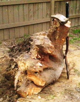

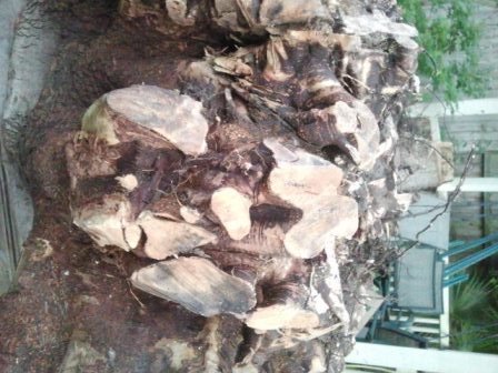

At the end of April, my neighbor cut down a maple tree (those pictures are in an earlier post about sealing green wood), the main trunk is now cut up, sealed, and drying on my patio. As soon as I can, I will move the pieces into the shop. But, now, he has cut out the root ball/ stump and offered it to me. And, it weighs about 350 - 400 lbs!! How do I put this on a lathe and turn something?? How about cutting a table slab out of the middle?? Then, I still have rest left. Cut it all up for bowls and pens? I can make at least 2 or 3 toothpicks from it.
The root balls are some of the best wood for character outside of a burl... I'd take it in a heartbeat. You may want to consider cutting off large chunks and trying to spalt them for even more character.
Got a high pressure washer??? Chainsaw with a well worn chain???
Wash and rewash to remove all the debris you can. Then start to cut with a chain that you will not cringe when it hits a small rock. Resharpen and know another rock is waiting.
Some spectacular wood in stumps waiting for discovery
Ken ain't kidding....might want to have a couple of 'crap chains' for the saw. Rootballs are known to have a LOT of rocks imbedded inside, even after being pressure washed, soaked in water and washed again...you won't even come close to getting them all out.

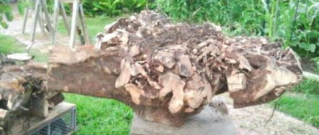

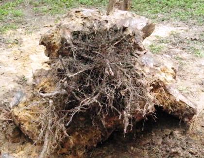

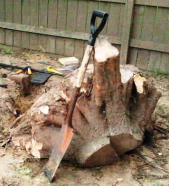

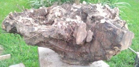

The rootball is now is now in my backyard. Here are some more pictures, still cleaning and there is a small piece of broken limestone block caught between roots. We are not sure about a table; but, am wondering how to cut into large blocks, sort of 8"x8"x8" to make bowl blanks. Lots of roots coming together, look at picture 4-there may be some great burl where these roots meet. I am going to brace my table in the morning and keep cleaning.
So, I how do I gauge the sizes for bowls with all of these odd shaped roots???
