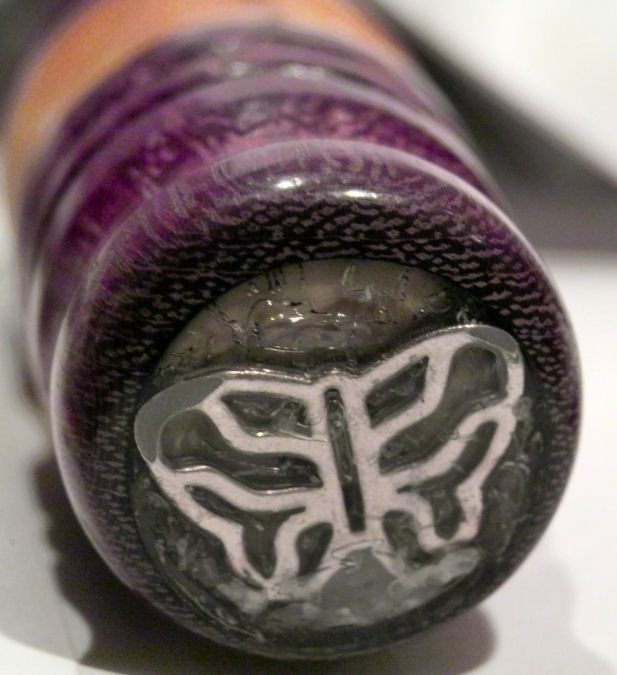

Hi all, made this stopper today. Was trying to get creative was making this for my sis in law she loves butterflies.
I put the button in then the butterfly and added CA in layers,Sanded it, tried wet sanding it and so on but there is a white cloud in the bottom half.

I'll venture a guess, or at least posit a question, since you haven't gotten any replies yet. Did you clean the butterfly before gluing it? If so, how did you clean it?

Did you let dry or use activator? Activator sometimes makes it have a white haze. How long did you wait between layers? Could the exotherm have caused to to do that?

Used the spray and I didnt wait long ( guess I was impatient?)
I glued in A jade button , then the charm on top and filled up too the charm,sprayed then completed filling.
Also I set it all up before I finished turning it so I could overlap the edges around it if that makes sense?

I wouldn't be surprised if there were some impurities that leeched into the CA from the butterfly. I'm also not sure if anyone here has been successful in building up CA to the thicknesses you need without getting some kind of hazing/cracking.
An alternative approach for next time would be to cast the butterfly in resin, then cut and shape the resin to fit in the space provided.

It is more than likely that this is related to not letting it dry on its own. I have found that CA will stay soft for a long time if too much is used, and not to use anything on it if you want a clear finish. What happens is that a skin forms on the top which is cloudy because of the reaction with the accelerator.

I know not about which I speak, so my question may seem dumb, but wouldn't the cloudiness be all over the CA, not just in a few spots? The lines in the CA I can see being caused from the excess CA staying soft for a long time; from what I remember of my materials engineering class (almost 20 years ago!), given the size and relative depth of the surface area here, as the acrylic crystalizes it will form natural grain boundaries, and these can lead to the lines in Leslie's picture. I assume we don't see the grain boundaries on pens as much because of the thin layers and quick set-up time of most CA's.
And I can see that accelerator will make CA change colors for similar reasons. From my understaning, the accelerator means that the acrylic crystals are not allowed to form of their own volition. Thus, instead of the fairly clear structure we normally see, they are coerced into forming crystals quickly, which makes a BUNCH of the grain boundaries I mentioned above, which in turn results in hazing.
The only thing I can think of that would result in the weird hazing/discloloration in the picture above is that the accelerator was only sprayed on a small part of the total surface area of the stopper.

You might try casting the butterfly or other objects in acrylic, using a slightly modified version of the technique described in the "Articles" section of the main Penturners site. Just stick with clear (unless you want it colored) acrylic. You might want to do it as a 2-part pour, as described by Anthony (Penworks) in a recent thread. Basically, pour a small amount of the acrylic and let it begin to set, then put the charm or other item on top, then pour an additional layer of acrylic. Waiting for the first layer to set up should help the charm stay suspended, and the two layers together should come out without much of a line (if any) if I understand Anthony's results correctly.
