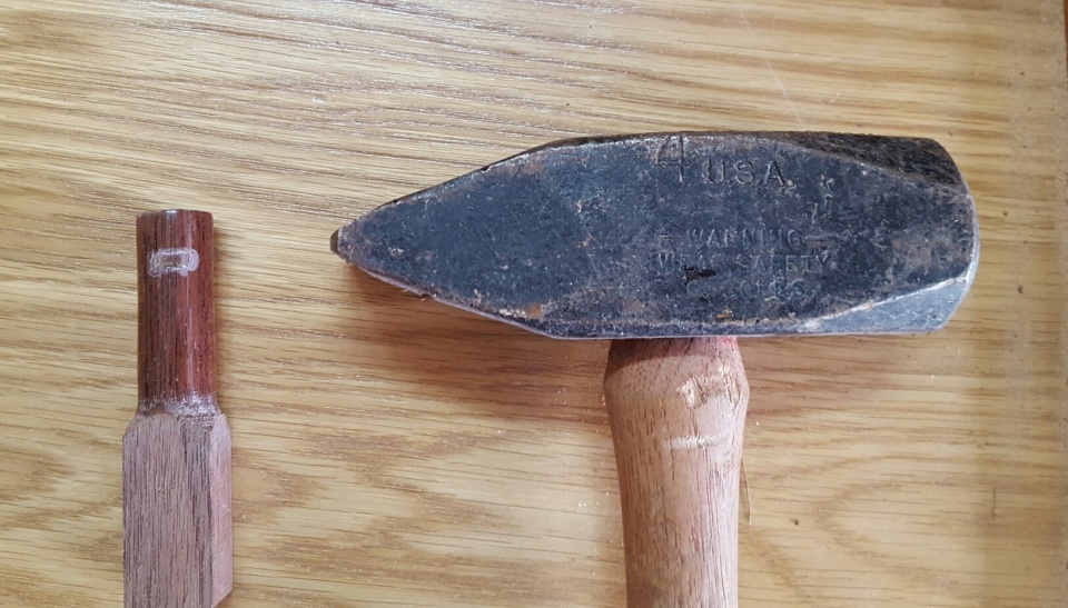

Here's a piece of walnut that I turned and finished with Mercury's Flex CA. For testing a few months ago, I then froze it, threw it in boiling water, and then whacked it with the sledge hammer. Aside from the impact point, there isn't any other damage.
