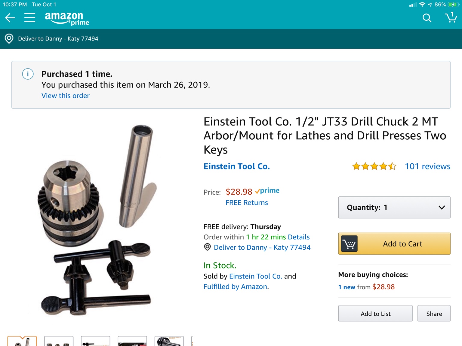

For a drill chuck, take a look at this one from Amazon. The one I purchased had less than 1/1000" of runout, unheard of for a drill chuck. Great quality at a good price. Better than the ones I've gotten from www.littlemachineshop.com. (A good site for lathe, mills, and tooling)
More4dan
Mar 17, 2016
2,102
Katy, TX
And the picture that didn't post ...
Sent from my iPad using Penturners.org mobile app
