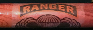

This was my first attempt at a water slide decal. I followed John Austin's excellent tutorial in our library & I used Blinggasm clear decal paper & sealed the decals with Krylon clear gloss spray.
Everything went well, except for the fact that it is obvious that the image is a decal. I was expecting & hoping that the clear decal paper would be completely transparent, but it isn't.
So, what did I do wrong? and what do I need to do to improve my technique?
Trim closer to the image, use lighter wood (this is ERC), use different paper or something else?
Thanks for any suggestions.
Edgar

I apply a complete CA finish on the wood first to get a smooth glass like finish that you need under a decal. You want a finished CA layer to apply the decal so the decal edges disappear when you apply the second CA finish over it. Just think of it this way, any surface you put the decal on will be trapped under the decal and show its flaws so make sure you are happy with your first finish. Also, I like to trim the decal as close to the image as possible so you don't have as much clear decal paper to hide. Don't give up, your close!

Thanks guys, I did first sand the turned blank through all grits of MM, then applied at least 3 (maybe 4, can't remember for sure) coats of thin CA, let it cure overnight, then sanded from 3200-12000 MM before applying the decal. It seemed nice and smooth, but perhaps my CA coats were too thin. I'll try applying it a little thicker or using more coats next time.
I use 2P10 CA which is a little more "watery" than some other brands, so perhaps I need more build-up with that brand.

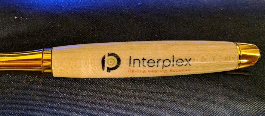

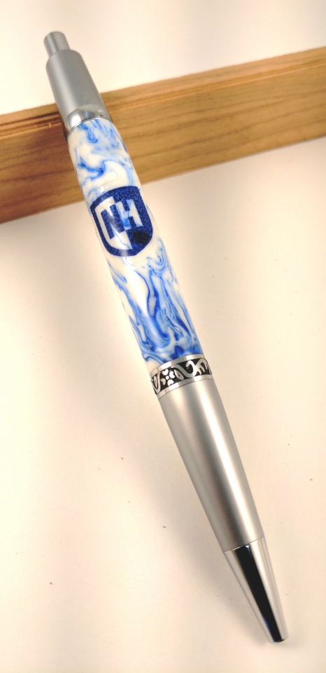

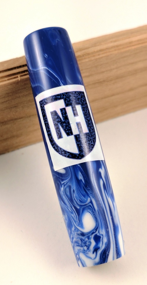

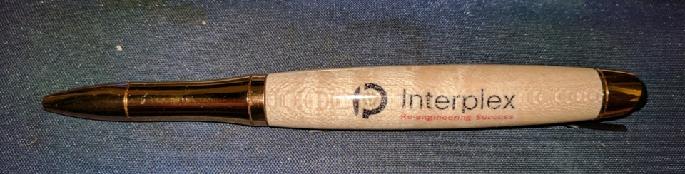

I tried a decal paper from Lazertran and ended up with the same issue. The background was milky. The finishing directions even state the decal will will dry with a white background and to make it clear you had to apply 2 or 3 coats any oil/spirit based varnish. I switched to Testor's clear decal paper and I didnt have that issue anymore. I also use Micro-Sol and Micro-Set which help prepare the surface for the decal and then also help the decal form to the round surface of a pen.
I've make several decal pens since switching to Testor's and all have come out flawlessly.
The Interplex pen was the first decal I did with the Testor's. I applied too much lacquer to seal the decal and it eroded the ink from my printer.
The two UNH pens were the last one I did. One of the decals is on white Testor's paper and the other is on clear.
