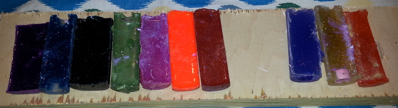

Here is a pic of the color samples I did
From left to right
Artist Oil Paint - Good color, opaque
Embossing Powder - Good color if you pack plenty, rather translucent.
Alcohol Ink - Good Color, tranlucent
testor's paint - Good color , Opaque
Pearlex - Good color with some settling, translucent
Airbrush Paint - Good color, translucent
Acrylic Paint - Good color, opaque
Enamel (glass powder) - a lot of settling, may be okay if you pack enough
glitter - alot of settling, may be okay if you pack enough
Artist inks - watery, color is pale, translucent.
