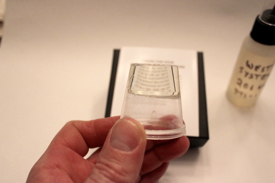

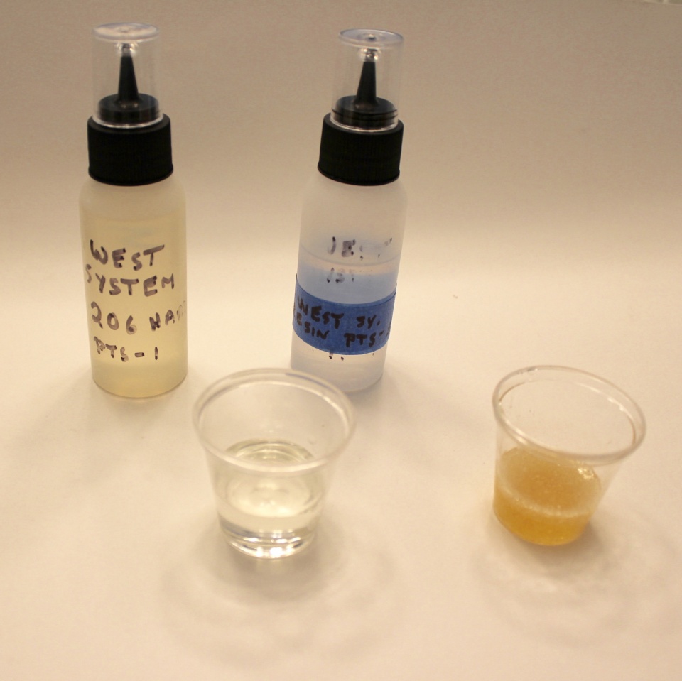

I use 105 and 206 and 207. This is for gluing in veneer strips for accent rings.
The yellow cup is 2 part 5 minute epoxy, System Three that I have used for years to glue in my brass tubes.
The clear cup is the West System. Quite clear, essentially bubble free - simply sat in the cup, no pressure pot. These samples were done last year.
I have not used it for casting.

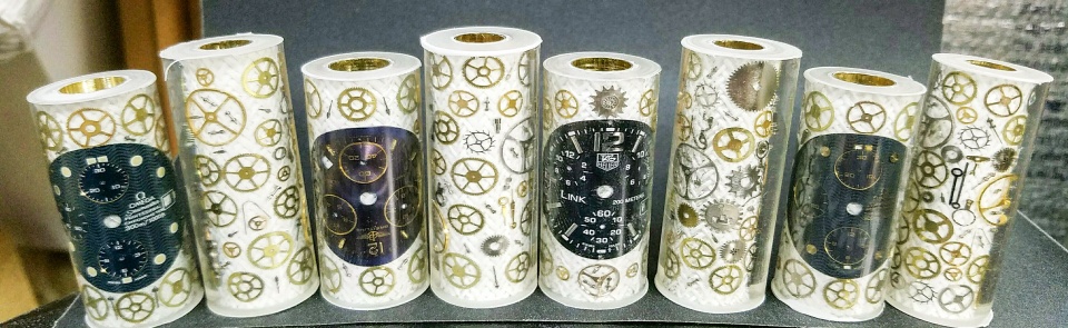

I am using it for clear castings for pens and other turning projects.
Alumilite is not readily available in my part of the world and I am looking to purchase about 4 liters at a time.
I am able to buy west system 105 from a local fiberglass supplier so this seemed like the easiest option for me.

So I got myself some 105 resin and some 207 hardener. I was disappointed to find that the 207 is straw coloured . Any ideas anyone?
I took the hardener back to the shop where I purchased it today. The assistant seemed surprised as he had thought it was supposed to be clear. He opened two other bottles only to find the same thing. He then got on the phone to one of the 'top guys' who manufacture West epoxy in New Zealand. Mr 'top guy' told him that the 207 was the correct colour and the fact that the website says that 207 is clear actually means that the resin does not darken due to UV light.
I came away feeling that I had, had the wool pulled over my eyes.
To be fair to the retailer, he did offer to refund the price of the hardener.
With all die respect to and for the vast experience of the members of this forum, we should all keep in mind that we don't know everything and what we see or say here should not be considered the final word. (Although John T. already nailed this one).
This is from the technical data sheet for West System 207 Hardener:
"Hardener may darken with age, but physical properties are not affected by color. If clear finishing, be aware of a possible color shift if very old and new hardener are used on the same project."
http://www.westsystem.com/ss/assets/Product-Data-PDFs/TDS 105_207.pdf
Please Folks, save yourself some grief and take a look at the manufacturers' websites and tech data. They know a whole lot more about their products than we ever will.
Finally, clear means transparent, not colorless. (Apologies for sounding like a school teacher).
