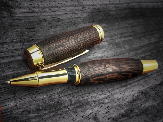

wenge wood pen

:) love this wood

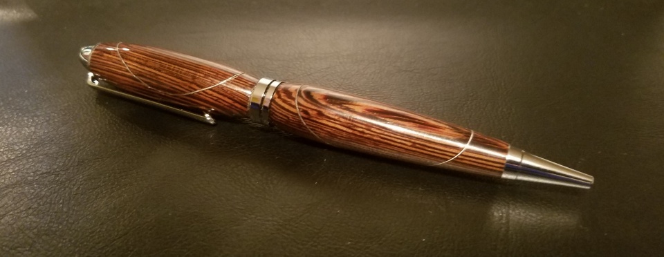

He is one I did. I use Stick Fast products. There are tutorials on how to do a CA finish on Youtube but if you have trouble with that let me know. As I feel I have finally perfected my method of a crystal clear CA finish.

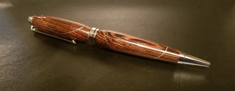

looks nice but i need to count with local market about supplies i nedd to find out what is good
I love Wenge, but you have to really fill the open pores to use a CA glue finish. Lots of thin coats. It is a truly gorgeous wood.

Have you ever done a CA finish on it? It gets much darker. I have done a lot of pens with CA and Wenge. Let me know if you want some pics or not.
