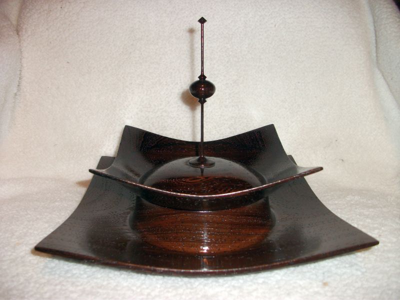

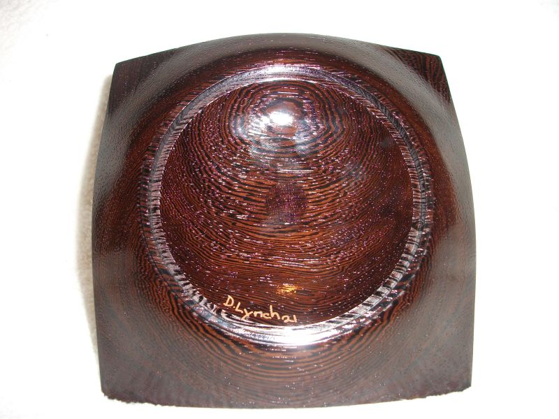

Made this over the spring and summer,10" sq x 7" tall. An absolute pain in the butt because it splinters just looking at it trying to turn in this orientation. Did get me best in show for the local fair.

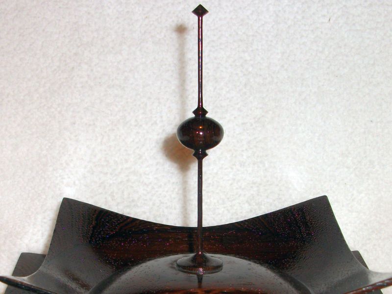

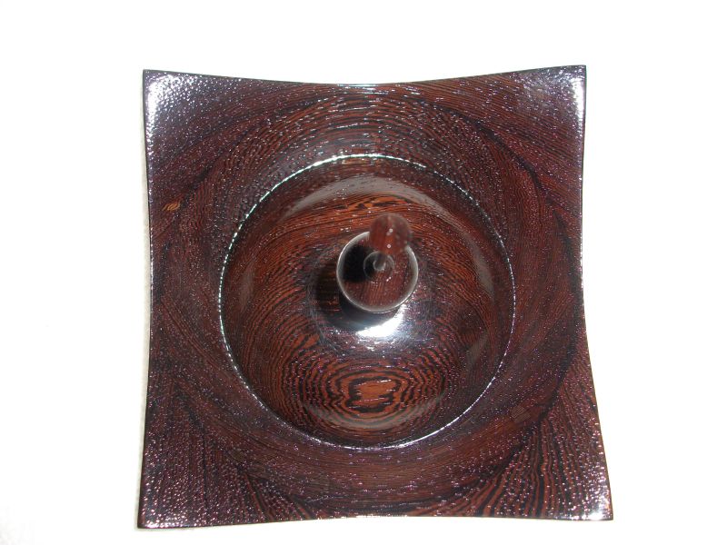

The proportions between every element are exquisite, a lot of thinking went into making this piece. Did you make the finial using wenge as well? Could you share a picture of the box open?

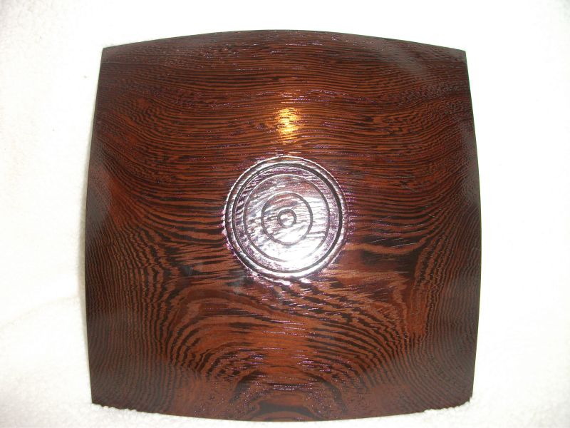

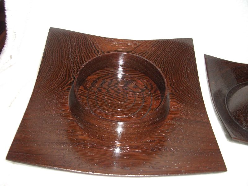

Sure, I just had to take more pics.The base is made from one peice 10" x 2". The top is 2 laminated peices 7"sq I alternated the grain. And the finial is a pen blank I had laying around,It was the easiest part.1/16" dia on the stem. deft laquer finish.

It certainly did soak up the finish. I used about a can and a half of Deft gloss spray lacquer. It's a lot darker without the flash from the camera
