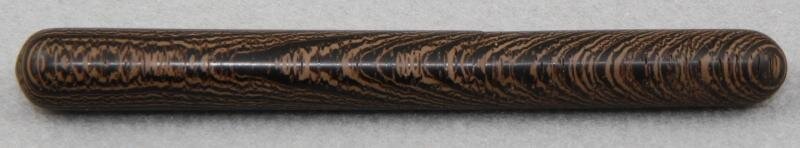

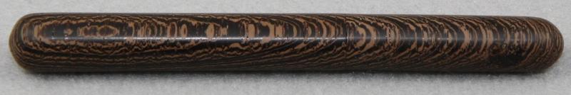

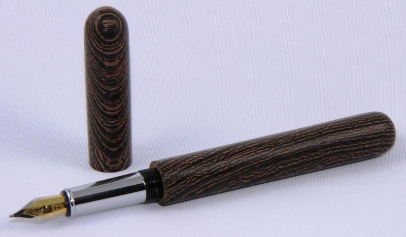

Its been a while since I have posted a pen. Actually, I haven't made one in a while. Been busy with exploring larger things on the bigger lathe when I get time away from work, the baby, and pushing snow around...
Anyway, here is my attempt at making a pen that looks like a cigar when it is closed. It is wenge, and a couple of pieces from a baron kit. I may try one of Lou's nibs on it once I get some. Wenge is definitely a challenging wood to work with. There was a blow out and an actual whole chunk of this pen that went flying, but some patience and CA goes a long way! Oh, good thing I have a pre-separator before the dust collector that caught the chunk for me.
I usually use a gouge of sorts to rough down a pen and then finish with an oval skew. I actually used my 1/2" Thompson shallow spindle gouge for this whole pen and had to sharpen and hone it several times. This is really hard wood, yet it splinters so easy?! Definitely a challenge.
Comments welcome.

Thank you. I enjoyed the challenge. I actually turned two barrels for a Jr. pen first (for practice) that are still sitting here. I have been contemplating on how to finishe them. I did do a CA/BLO finish on those barrels. There is actually no finish on this pen at all. I just sanded to 600 and then buffed - first with a bit of tripoli and then a dry buff. The wood is so hard and oily that it shines up nicely.
I thought about getting a cigar label and sticking it on the pen. However, I think that other than just sticking it onto the pen, I'm not sure how well it would work with wenge. It wouldn't be protected at all.
The wood is very porous (think oak or ash porous). Hum, I may try to see if I can build up a poly finish on my 'practice barrels'. If that turns out okay, maybe that would fill the pores and cover a label? I wonder how that would look? Thoughts?
