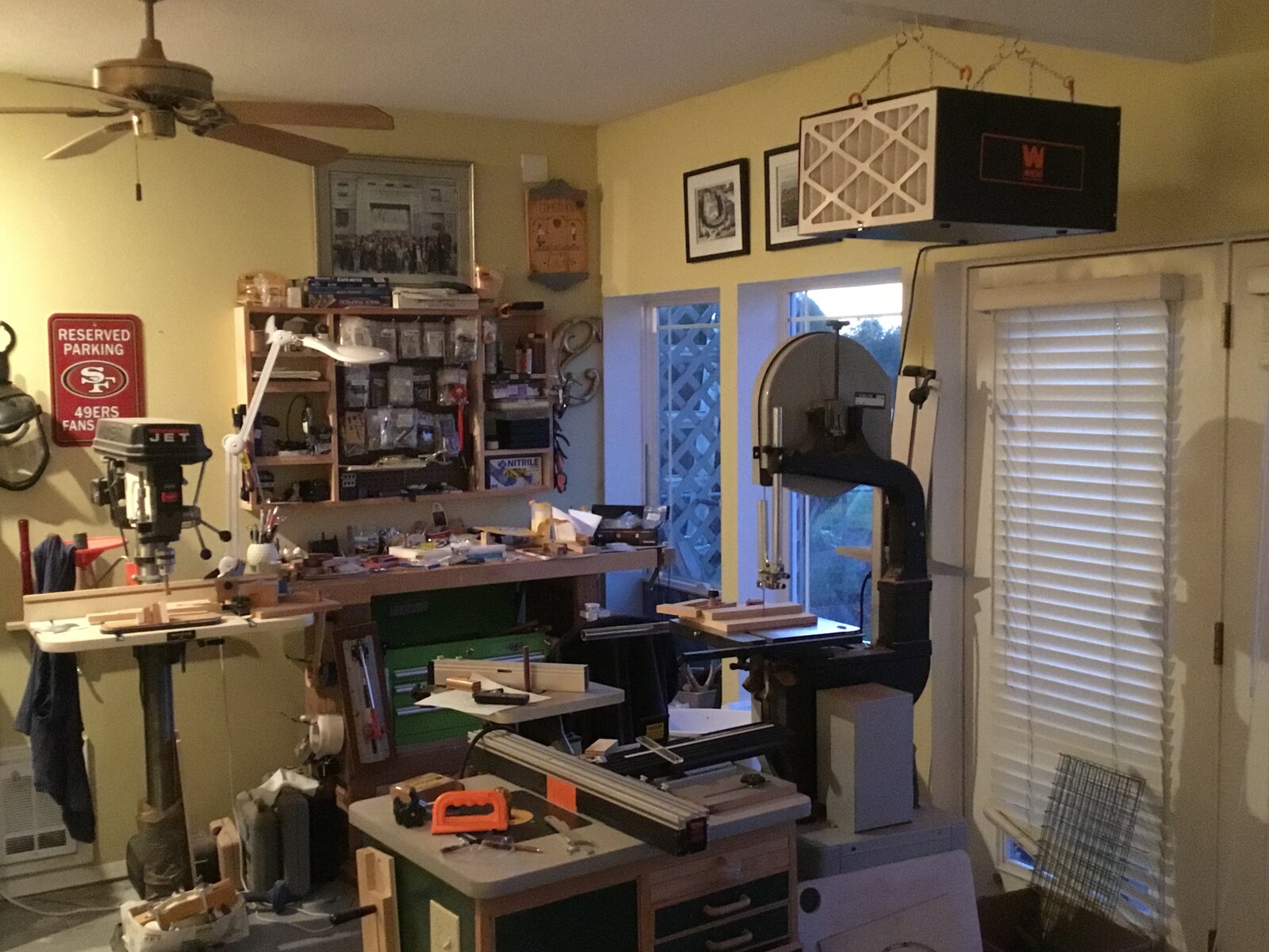

I've had the same unit in my shop - which is a partially converted garage - for maybe 2 years now. Photo attached (upper right). It works great - love the timer/shut off feature.
