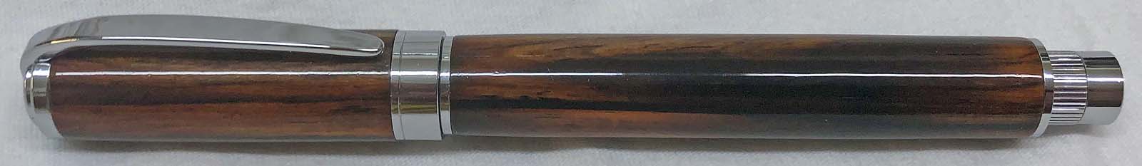

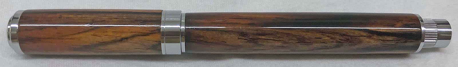

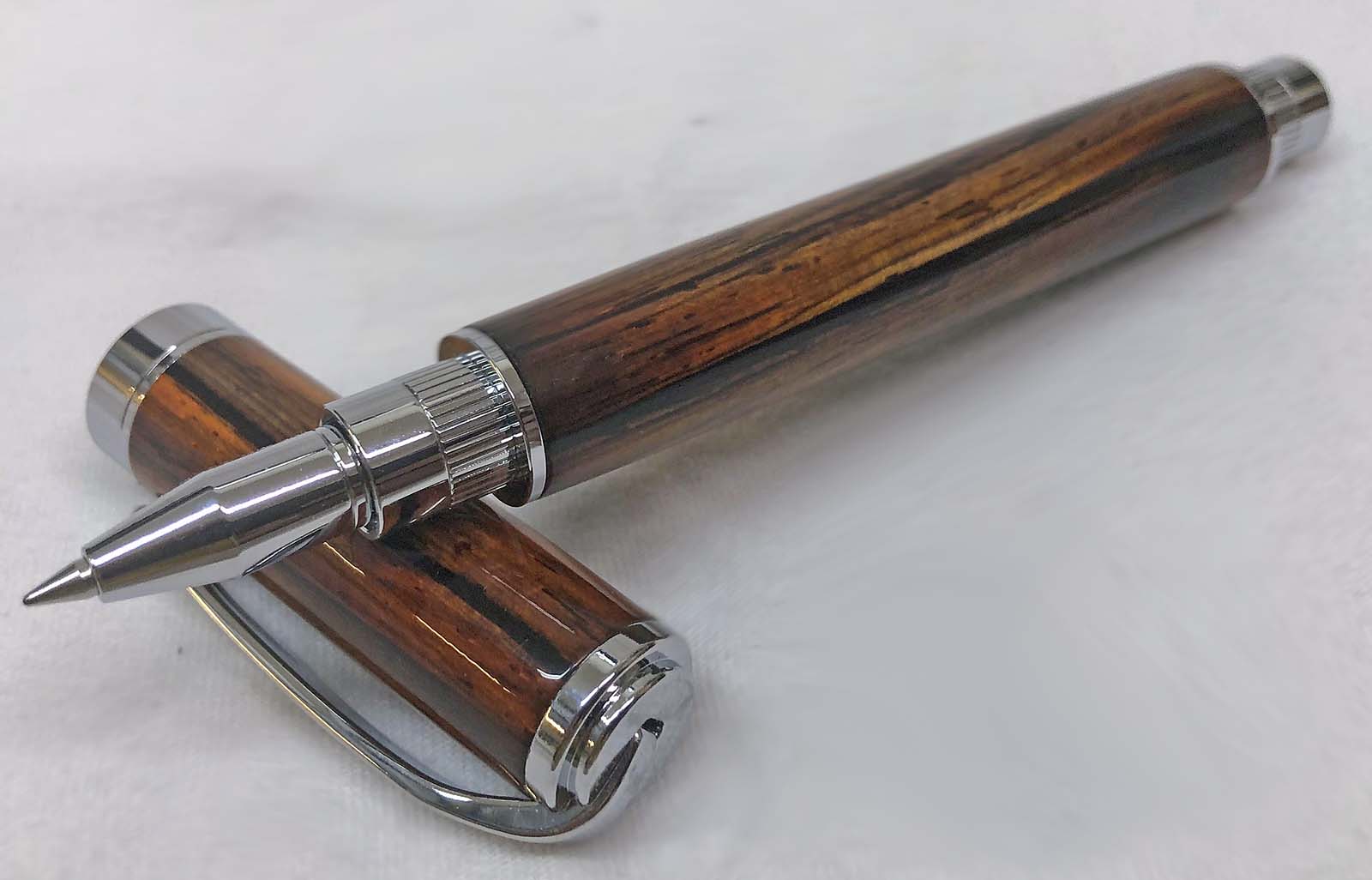

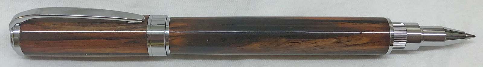

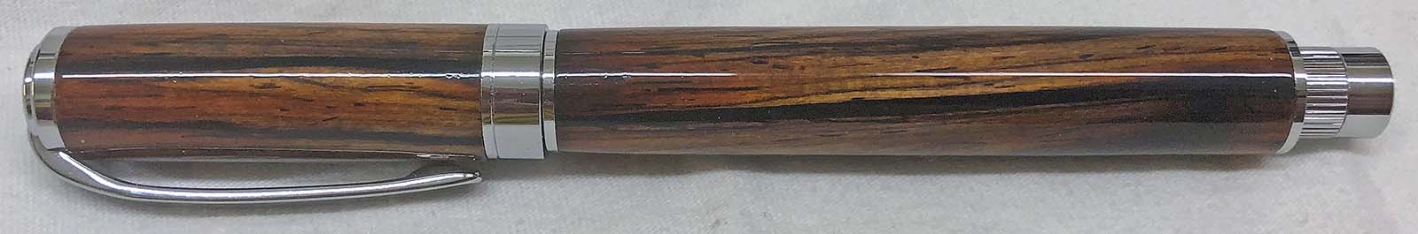

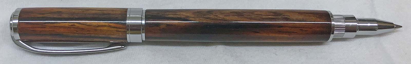

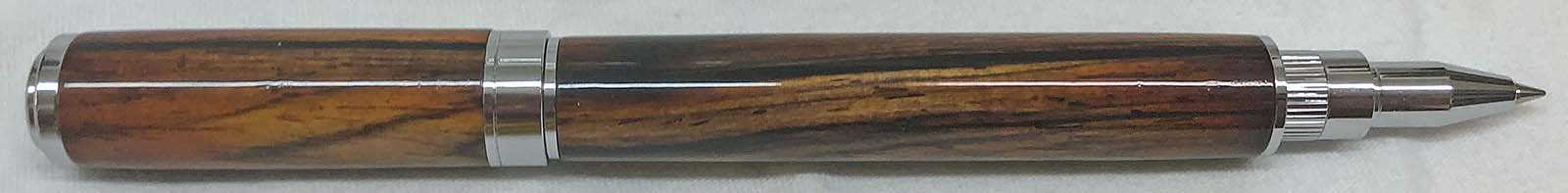

Greetings from Nebraska. Well, here it is, my first Chrome Magnetic Graduate from Exotic Blanks with a Cocobolo Rosewood blank that I had in a box labeled "Use these First".
The blank had a very dark area on it that contained a knot and a nasty void. I originally thought about starting over with a better blank, but as I mentioned in another post - I just have a hard time letting this kind of thing go. After trying a couple of methods I wound up turning it to nearly the final dimension, using a pick to dig out my failed attempt at wood filler, and filling the crack up with black CA. I think it turned out pretty good all things considered.
Since this is my first time with this kit and since it's been quite a while since I've made any pens, I decided up front that it wouldn't go in my collection but would replace the Zen I've been carrying for 6 months or so. (I really like the magnetic cap on the Zen so I expect I will really like using the heftier Magnetic Graduate. And, my favorite refill, Pilot G2 with a Broad tip, fit in it nicely without any modifications).
Anyhow, here are the pictures and thumbnails. - Dave

It's a beautiful pen egnald....I have made a bunch of those recently, but I really don't like the tip and cone...it just seems klunky and uncomfortable. Don't get me wrong, your work is awesome as you always are...your fit and finish is perfect IMO, just commenting on the kit....
I should point out that the magnetic part is cool...stays well when you want it to, and comes off easy. And how many people try to pull off screw top? A lot do, in my opinion....

Thanks. I am a little concerned about the abrupt step in the tip myself. It hits right on my finger when I am writing. I thought about the Magnetic Vertex kit, but aesthetically I like the round tip shape more than the faceted. I might have to try one though to gauge how it feels vs the Magnetic Graduate. - Dave
I made some Vertex too. Its the same size tubes, and bushings. Its slightly longer (1/2") and has a longer reach on the cone, so not as bad, but I usually make Atraxes' and those are so much smoother and sleeker. I do get the non-postable, I want to force people to not post, because it is so easier and comfortable to write with that way. I wish they were magnetic. I guess I feel the vertex is klunkier looking than even the graduate. It has the facet, and looks like a bolt theme.....just my opinion.

That turned out really nice Dave! I always like Cocobolo and love the blackness of the streak in this one.
I too struggle with both the Graduate and Vertex magnetic kits. I like them magnetic concept, but don't love the awkward step in the Graduate and don't love the hexagonal shape of the Vertex. Why can't someone just make a magnetic kit that looks normal on the outside and is comfortable to hold and write with?
@moke on the Atrax kits, I have only made a few of them, but he first one I made was in gunmetal and in very little time I began noticing scratches and such through the plating down to the brass on the section. I haven't had this happen with any other pen kits, so was quite disappointed with it. Have you had any issues with the quality of the plating on the Atrax kits?
That turned out great, Dave. Cocobolo is such a great pen wood.
Good call on the black CA. Also, it's good to hear the Pilot G2 gel refill fits.
I've had some luck with the Graduate and Executive as one of my inexpensive rollerball offerings along with the magnetic Vertex. People seem to like the magnetic caps.

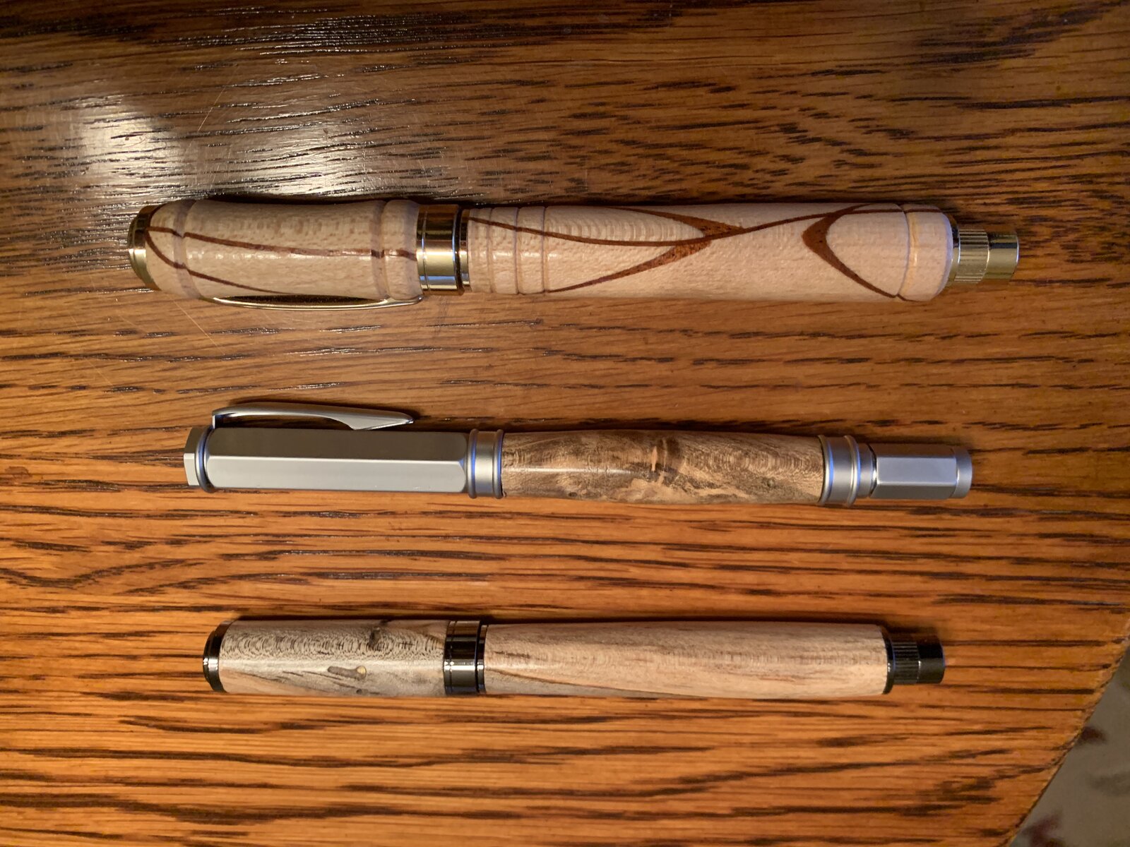

I like the kit. I'm a fan of the magnetic cap. I've made several of the magnetic vertex, but prefer having a two barrel pen as opposed to the metal cap on the magnetic vertex. This looks like it will fit the bill, I'll have to try some out
The Vertex Supreme uses the same design concept with wood on the cap as well. It even uses the same bushings as the Magnetic Graduate. The biggest difference I can see is the shape of the tip and finial. I will likely be getting some of those to try out when I get my next allowance. - Dave
Thanks for the feedback and the recommendations. Because of the heft of the magnetic pens I think they deserve a broader tip. The videos sound interesting and I will tune into a couple. As I said I'm a rookie and a hobbyist but at 79 years old have been involved in a lot of household and hobby projects over the years. Before getting into pen turning I thought I had all the drill bits I would ever need…Wrong!
