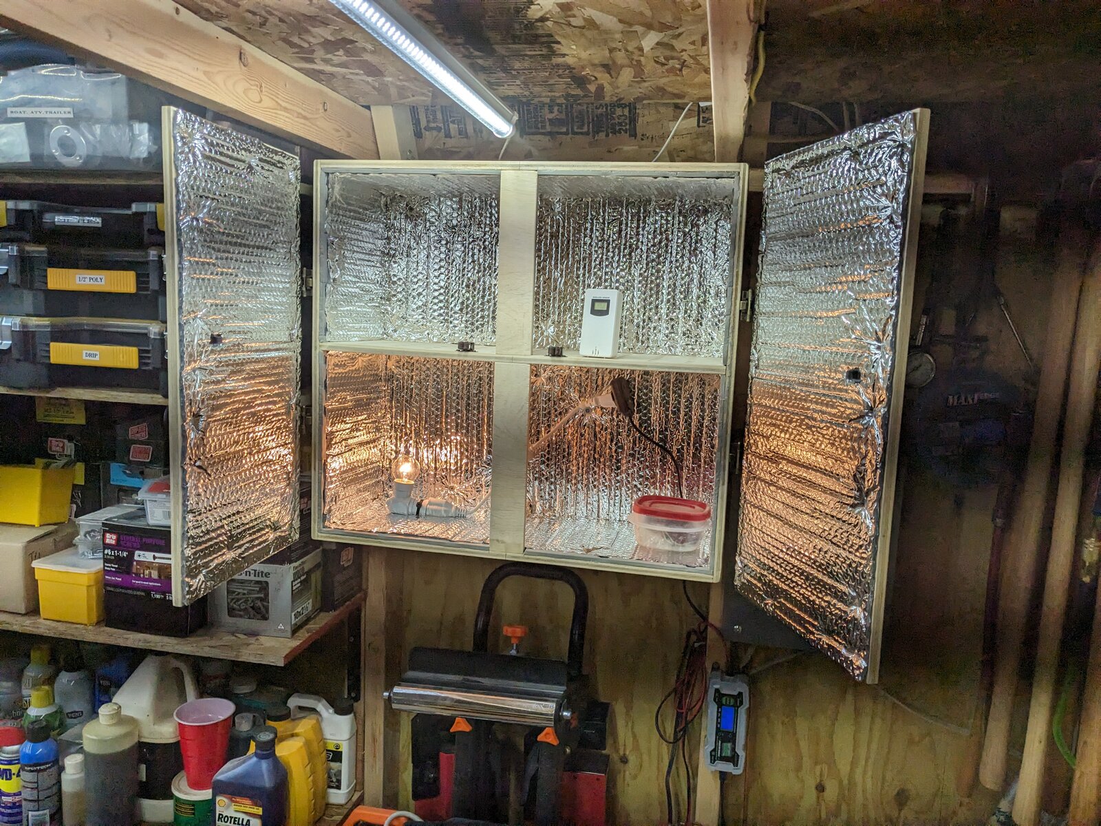

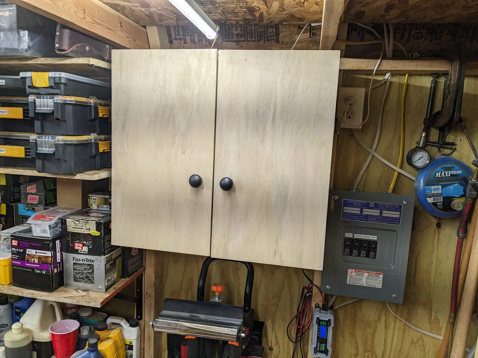

Yep took all weekend to build this insulated, heated glue and finishes storage cabinet. But in my defense it was my first cabinet build and Saturday was my birthday which lead to a few phone calls and the kids and inlaws stopping by. Guess next year my birthday wish should be for peace and quiet.
The box is 24x21x9 inches, lined with foil covered bubble wrap, 40 watt oven bulb, 32f to 50f thermostat in extension cord, shelf has a bunch of 1/2" holes in it for air flow.
I'm going to see how the box performs in its current configuration but I might need to wall off the light from the thermostat, well see.
