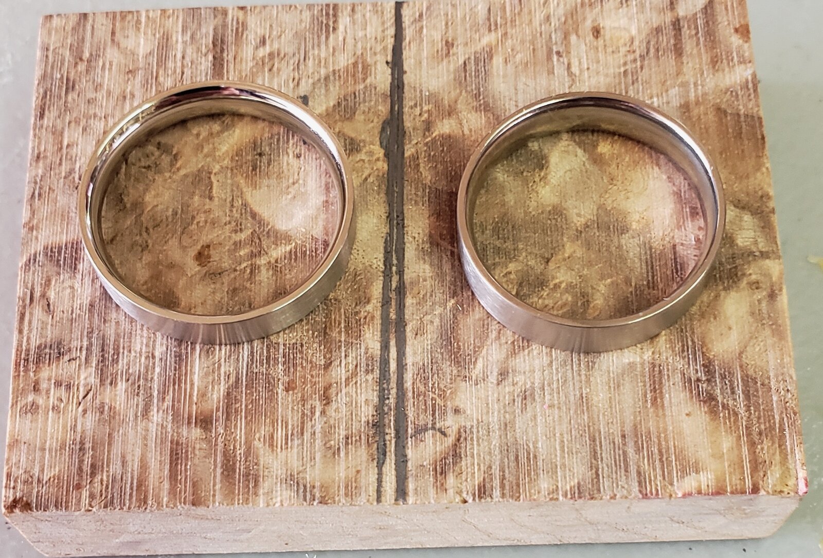

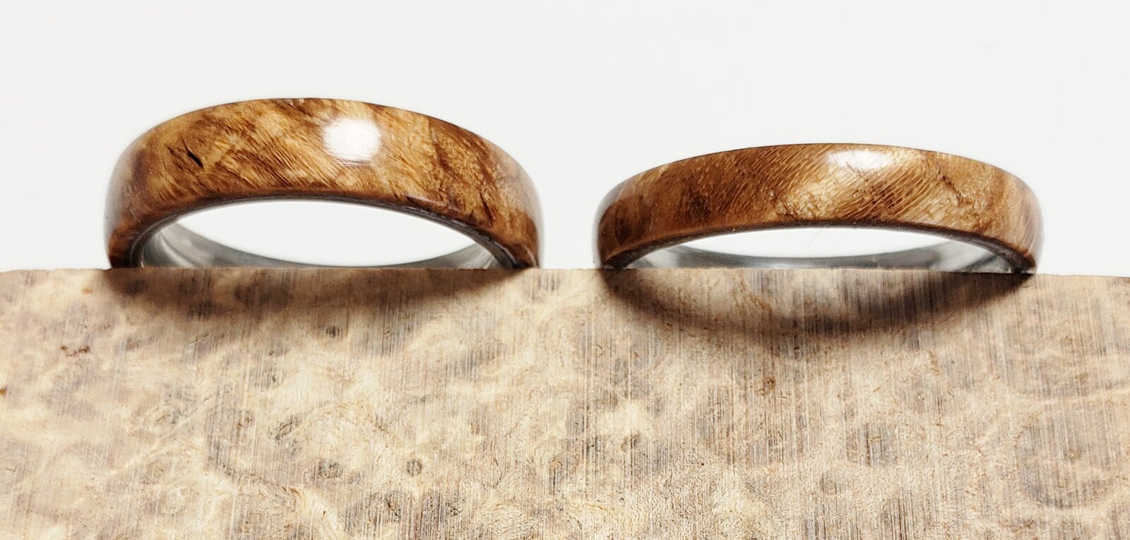

Don, beautiful rings. What glue did you use? I have found that epoxy works best.. I also tell my customers that these are dress rings, (take the wife out to dinner rings).
its_virgil
Jan 1, 2004
7,758
Wichita Falls, TX, USA.
I use Epoxy also. And I also inform those who get one thst they are not for working man's hands. I have moved to the two piece cores (as I replace cores) for added protection on the edges. Some screw together and some snap together. Thanks. Don

Nice work. Like others that another road I’ve looked down but never made the turn. How hard do you think it would be to cast the ring with the core in it? Similar to a tube in cast. Thanks for sharing

I gave up on this design though you absolutely nailed it in beauty. Several came back either separated or cracked. Yes, I used epoxy. I have refunded everyone who purchased mine. The two part ring cores require much more precision but the have metal on three sides which I like better than ring cores you made with glue on only one side. Your work is stunning, but be careful if they get married with them…

I too have moved to the two piece cores. Too many have not lasted and I have remade several. These two are for a couple who otherwise could not afford wedding rings. I gifted these two. The couple plan to purchase gold wedding bands soon. Thanks.
