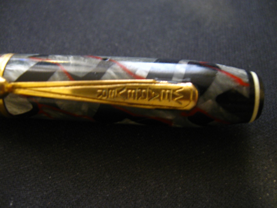

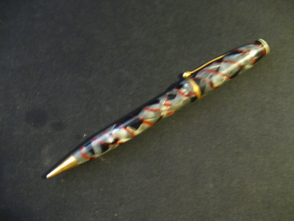

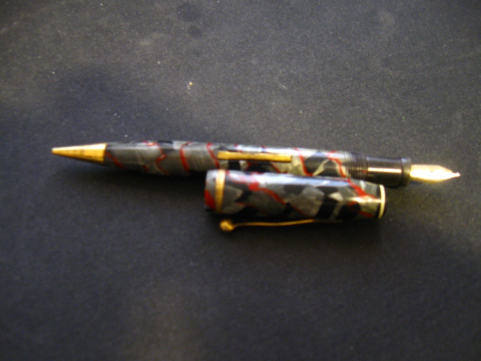

Found this at a thrift store on my vacation. Pics not so good but it is a wearever Fountain Pen/Pencil. The FP Tip has a broken tang and I know it needs some love but does anyone have any knowledge about this?
Thanks

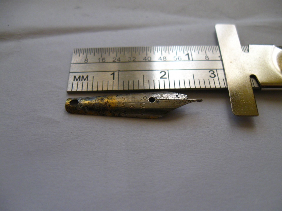

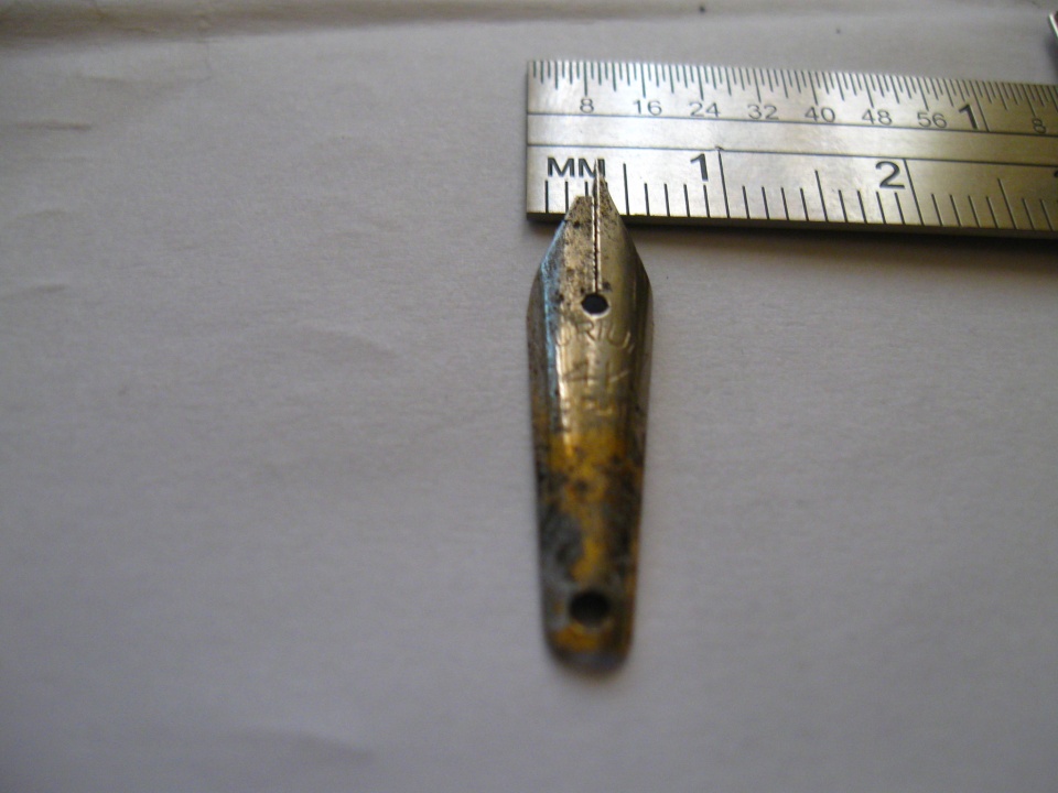

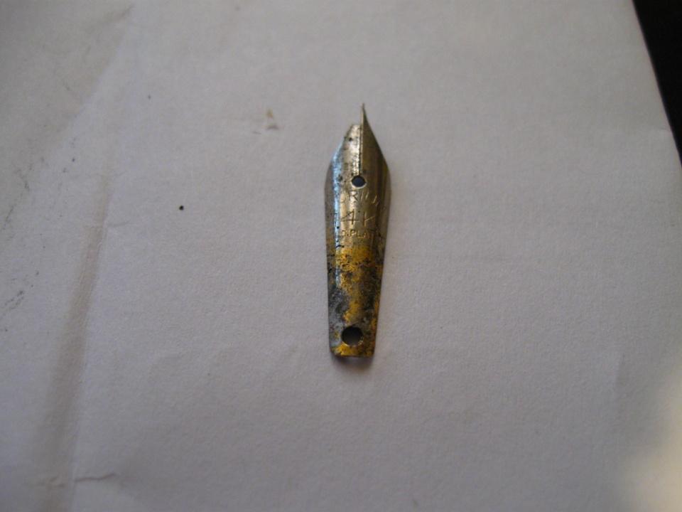

Anyone know where I can get a NIB that looks like this It is from the pen above

You are climbing onto a slippery slope. You may never escape.
That nib could potentially be reground to a much broader line. Might be worth considering to keeping the original nib in working condition to enhance the value when your heirs sell it some day.
Have fun with this!!!!

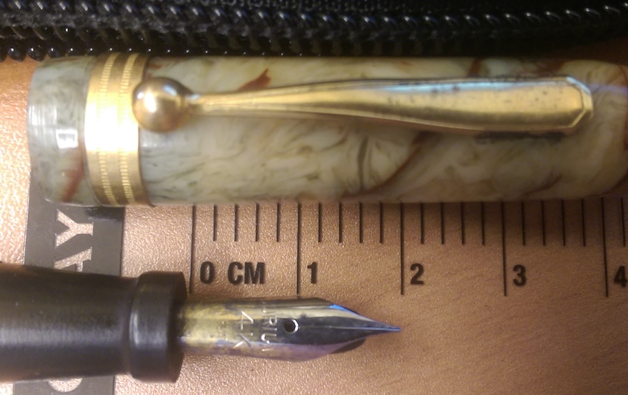

I didn't want to mention this earlier in case it turned out to be my bad memory -- but I appear to have a pen with a very similar nib (and a similar design embossed in the clip, although not the name of the maker.)
I can't get the nib out without some extra grip (I have section pliers at home), but here's a photo for comparison with your nib.
If it's a match, I'm sure we can work something out.

The only issue Ken is the backside of the nib is corroded badly. A real slippery slope but then I like to tinker with things to see how they work and if I can fix them.

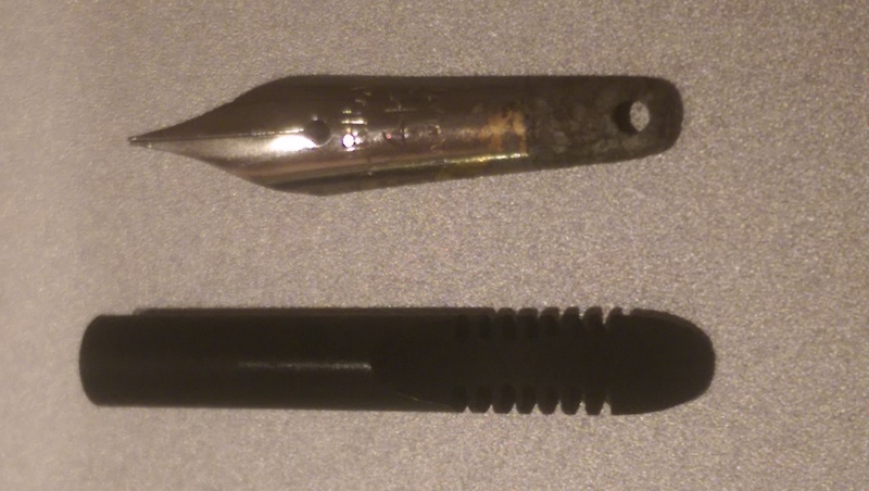

I tapped the nib and feed out of the section and cleaned off the worst of the crud, it now looks even more like the one you have.
I just compared it to a regular #5 nib and feed, there's quite a difference in the ones I've got, a #5 feed won't fit into the radius of the old nib, and the wings of a #5 nib don't sit on the old feed.
It would be great if you can find a new nib for it, but if not feel free to get in touch.
The nib in question (Durium) is a gold plated nib. It's basically lower grade steel plated in very thin gold. Most of these nibs today (decades from when they were released) are corroded from the inside.
I have numerous encounter with these type of nib and any attempt to write with them ends up in disappointment, or literally broken off tines because on some of them, the corrosion inside is not visible from the outside.
If you would like to enhance the value of the pen so it writes better, I'd suggest to find a Warranted 14K nib that is about the same size.
Basically anything that says Gold Plated after the 14K, is not a real 14K nib. I always strife for using and restoring only 14K nibs.
