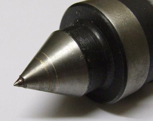

philb
Sep 1, 2007
1,561
Midlands, United Kingdom.
This is the damage!
The centers are aligned and I make sure they are lined up before each pen. Also the mandrel seems to be straight, as I don't have much of any issues with out-of-round pens. Not to do with the mandrel, more cutting to fiercely!
Possibly its the mandrel that is damaged, and therefore damaging the centre? I only say this because I was using a non-60degree centre before I bought this centre! Before I realized that the OEM live centre wasn't 60degree?
Cheers PHIL

I have the same problem.. without knowing the difference at the time, I used my stock dead center on my mandrel.. my dead center looks like it was made out of plastic not steel.. end tip of it came off in the center of the mandrel rod..:eek: But soon as the funds come available, I will pick up a good dead center and replace the mandrel rod.

I was wearing rings in my centers until I bought a set from JohnnyCNC. I have been using them daily and they aren't showing any wear at all.

It is easy to see that the LC does not have a hardened tip. Check for hardened tips or carbide tips. Johnnycnc sells hardened ones.

I would say this is spin wear. This happens when the live center does not turn as fast as the lathe is turning. It can happen when the bearing in the live center gets dirty, worn, etc. and thus causes the live center to turn slower.
Get rid of the cheap stuff and buy one that is hardened and will last forever as long as you take care of it properly. Yes, they do require some attendig to ever so often!
Follow Hank and Neil suggestion and order one from Johnnycnc. Floks here that use his stuff have repordedly been very satisfied. Good luck!

Centers provided with, or sold for woodturning lathes are (generally) not made from hardened steel. They are lower cost soft steel and, as you learned, fail quickly. What you are experiencing is not unusual.
I now buy my centers from machine tool sources. Actually, for me, I just walk to the other side of the big Grizzly store in Springfield, MO.
Good quality, hardened steel, centers cost a bit more but not enough to break the bank. But, they do last, and last, and last and......
