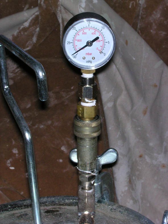

Hi Andy, I don't get it. You say it has loads of bubbles? So I'm assuming a 'cast' resin blank as appossed to a 'stabilized' wooden blank?
But the gauge you used ( not the one I gave you[}:)])is only for vacuuming. Did you just vac the resin and let it set, or did you pressurize after vacuuming?
The idea is to first get as much air out as possible, via vacuuming, then to crush the remaining bubbles with pressure.
Let us know what you did please.

Steven, youo are right it was a cast blank.
I did try to do both vacuum & pressure. I think what happened i was caught out be the speed of it setting when it started to gel so the pressure didin't make much effect on the resin[?], i probobly should have put it in the pot sooner, but i wanted to add something as it started to gel.
I am sure i will get it mastered soon, it wouldn't be any fun if it went right the first time.[:p]
