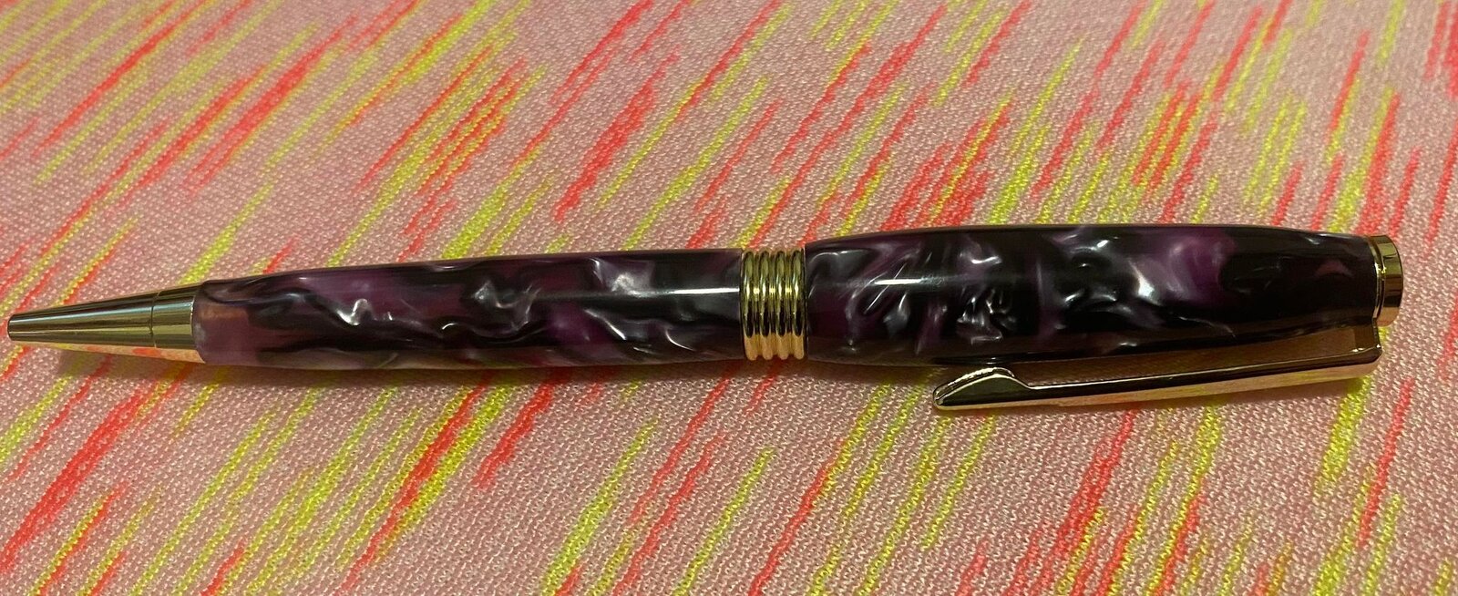

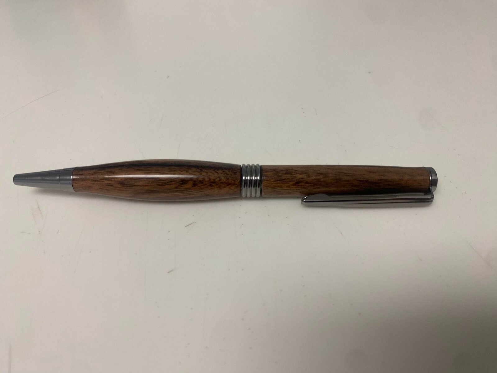

(Attached my most recent 2 because even though there are still some flaws in technique/execution, I'm still proud of them :D)

I have seen videos and comments from pen turners that used boiled linseed oil to darken or bring out the character of their wood before applying a CA finish. I think wax would be detrimental to the adhesion of CA though. I have never combined the two myself though, so I can not offer any direct experience. You should be proud of your pens. It's a skill that is learned and all of us went through the learning curve. Thanks for sharing them. - Dave
