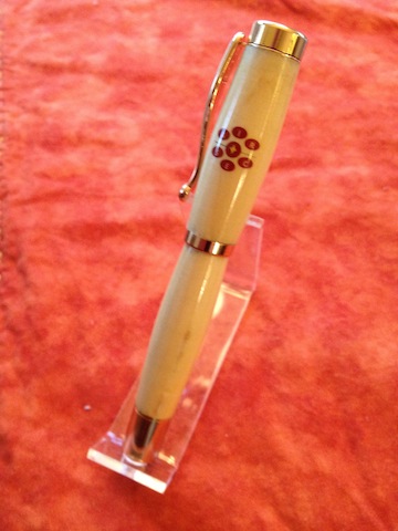

Like Dick M, I use the Testors Decal Binder. It really is necessary when using an ink jet. After printing onto clear decal paper and fixing the decal with the binder, I cut it out, soaked it in warm water and put it on my pen (already had two coats of CA finish on the pen) and squeezed all the water out. I let it sit overnight then added four more coats of CA (Med) finish.
Photo shows custom logo on Holly. Picture take with iPhone. Apologies for the quality (got my tent after this was made, photographed and delivered).

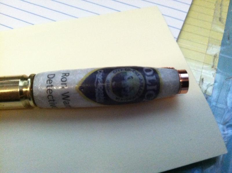

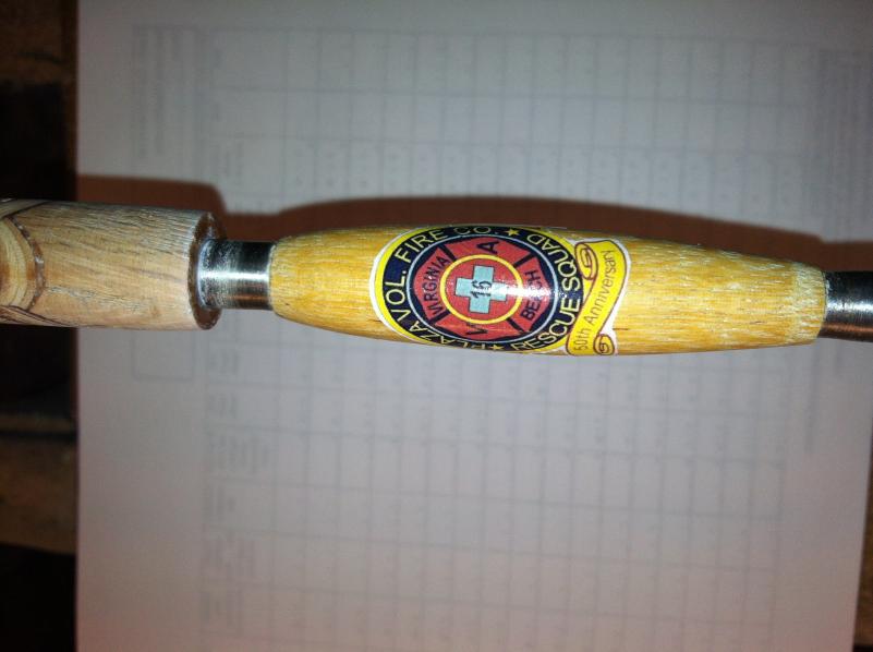

I went to Walmart and got some of this stuff. I used it paper from decalpaper.com. And here's a couple decals that I did.
