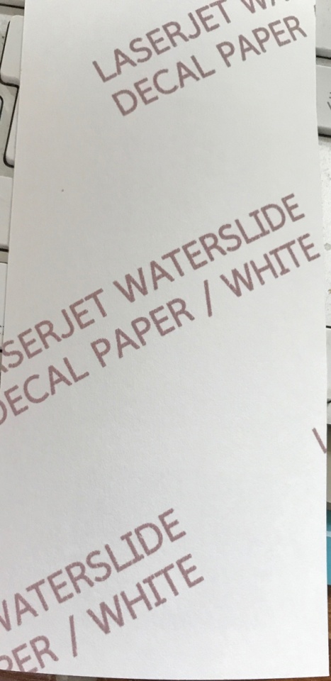

Laser waterslide decal paper white
I've been printing decals on pens for a couple of years now and the paper I like best is the Laserjet Waterslide Decal Paper/White from Dr. Decal and Mr. Hyde in Australia. Trouble is that it costs an arm and a leg in shipping.
The paper has text on the back of the sheets - picture attached. Does anyone know who makes it (preferably with a store in the UK)?
