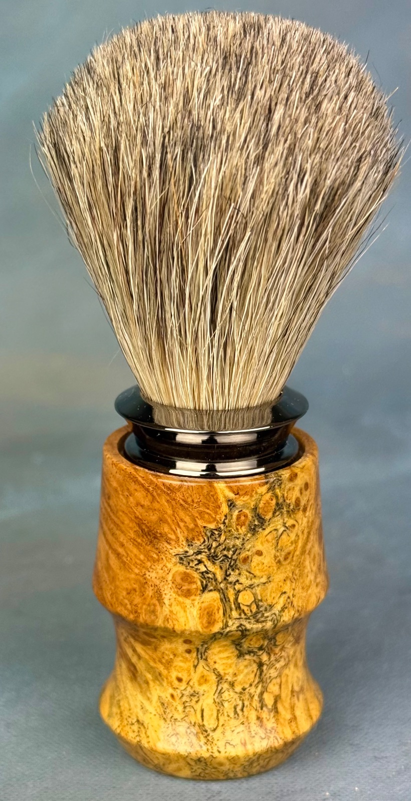

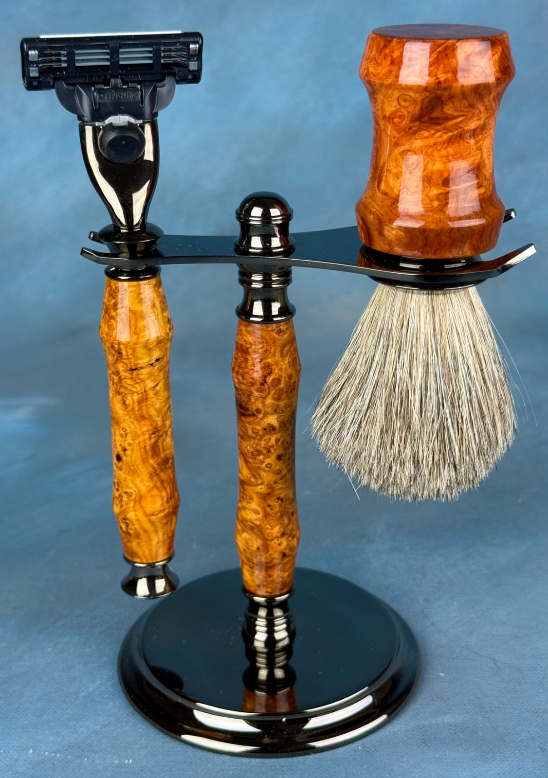

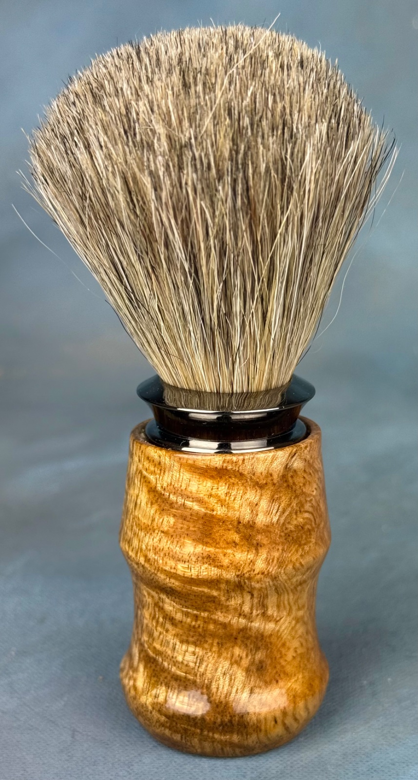

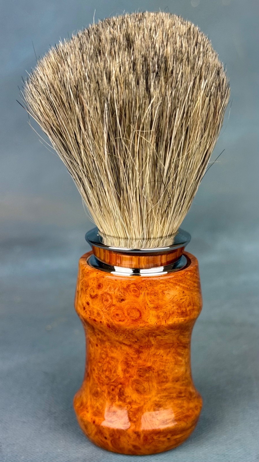

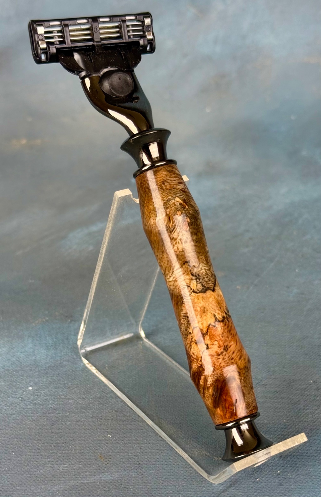

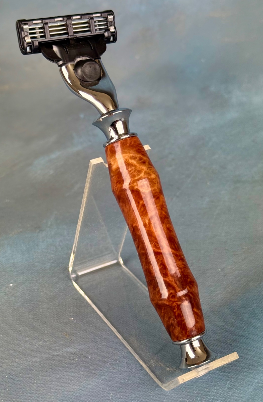

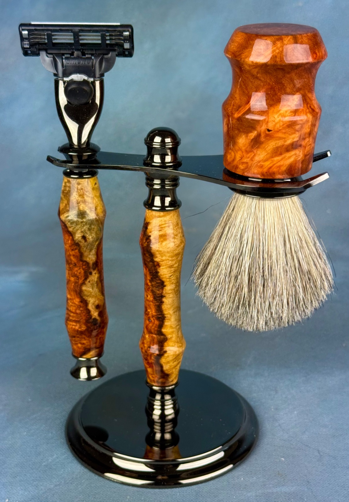

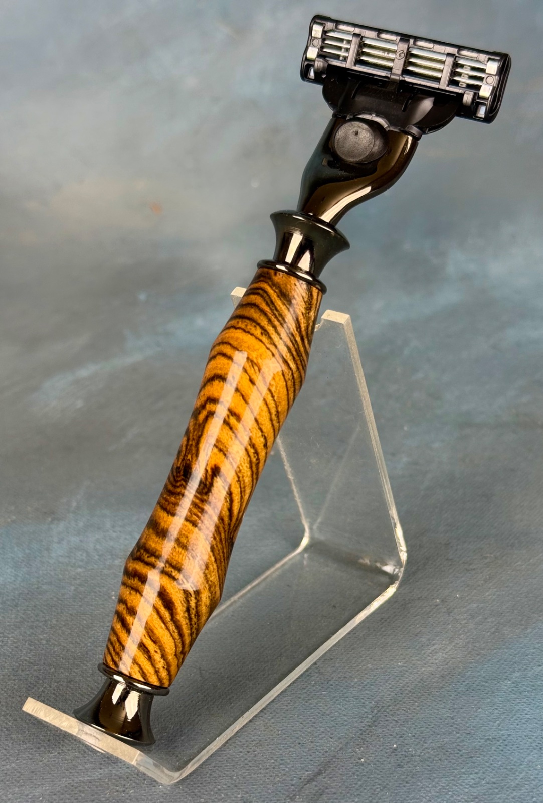

I make quite a few razors, shave brushes and razor sets. I apply 16 coats of CA glue and always seal the ends with CA where the hardware attaches. In a shaving environment my stuff lasts forever. I caution them not to submerge the item in a sink of water. Use it, rinse it off and shake the excess water off. I also encourage them not to leave the razor in the shower.
