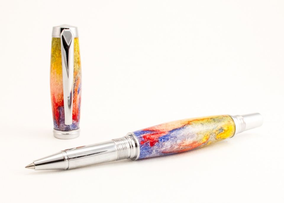

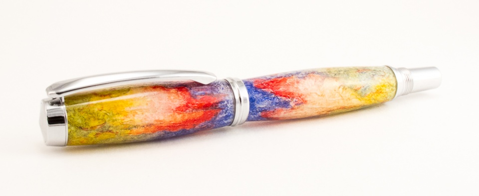

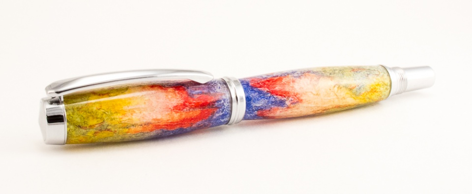

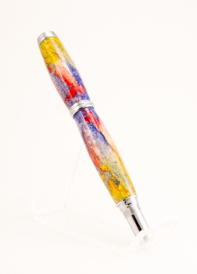

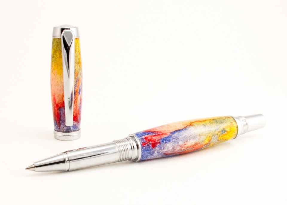

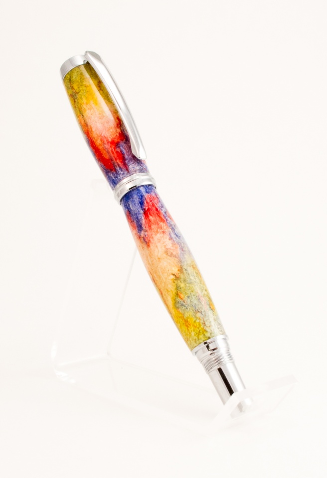

This pen as made from the blanks from the Free Style Casting pen. Here was the process:
Watercolor paper Painted with watercolor paint. I have a method of deconstructing watercolor paper so it can be applied to surfaces with a brush. Using my secret technique I applied it to the tube. Then I painted on the watercolor paper with actual water color paint. It needed several layers to get it to the darkness that I desired. It needed several days for it to dry. From their I sealed the surface so the paint would not come off during the casting process. Finally I cast it in resin. This is the result of it after I turned it. You can see the texture to the paper as well as the paint.
The Kit is Smitty's Caballero. Thanks for looking.
Jon
