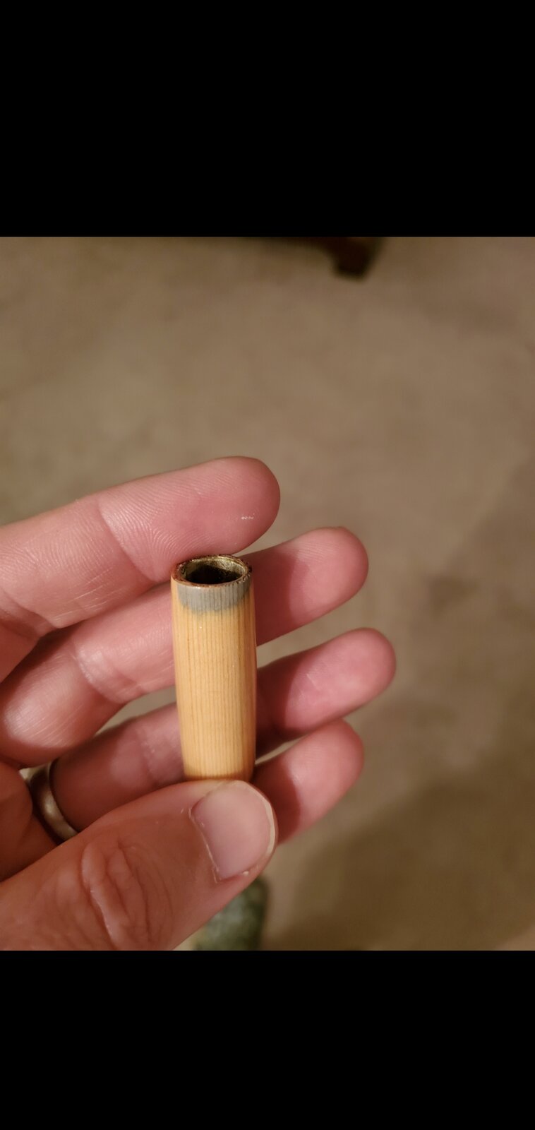

Hey pros, does anybody have any solutions for this? Lately when I wet sand I think I'm getting water under the CA finish. Thanks

After you face the ends, apply some thin CA to the ends. That will seal them and prevent what is happening to you.
The gray is sanding dust from the bushings - mixed with the wet sanding wate,r and then soaking into the ends. As Ken wrote - seal the ends before sanding.
There are those who swear by wet sanding and those who do not. It is your choice, but those who do not - have as fine a finish as those who do. That said, there can be another problem that crops up with wet sanding - with darker woods, moisture under the CA making look like the CA is cloudy.
Look at this list in a search for the word "cloudy" . . . most caused by wet sanding:
And another trick to eliminate the metal sanding dust: TBC - Turning Between Centers in which the bushings are taken off before final sanding. The blank is turned to size, or sanded to size by measuring with calipers instead of sanding down to the bushings. IF you sand the bushings, by the time you make about 20 pens with those bushings, the bushings will probably be 1/64" or more smaller, making it unsuitable for "sizing".

Another thing I noticed, and it may just be the picture, but it doesn't look you faced down to the brass. If not, there's a lot of thin wood there to wick in moisture.
I use a disc sander now. In the past, I used a pen mill, but they can cause a lot of damage in a hurry, especially on segmented blanks. This is another topic that some have strong opinions on. I have settled on the disc sander method, haven't torn up a blank since.
