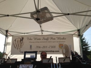

This picture shows what works better than anything else we have tried. It can be run with a voltage inverter, generator or just plugging into a wall outlet. You might be surprised how well the $15 device works! We call it the REDNECK CEILING FAN:)
We have a misting fan that we used to great effect this past weekend. Works great if you don't care if anything gets wet. I wouldn't consider it for use within 20 feet of my pens.
Well Andy, our humidity is as high as yours. As for getting wet, it will just be us underneath the canopy. I'm just trying to get some relief from the heat as we are at the track from about 11:00 a.m. until 12:00 a.m. I've got a few fans but never thought about how you positioned yours. All ours our ziptied to the sides of the canopy.

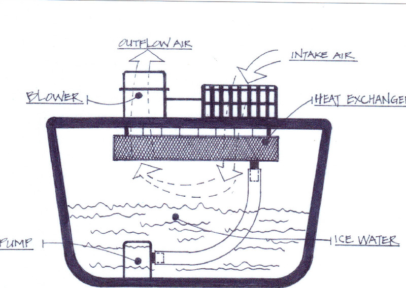

The "playmate cooler sized" air conditioner uses a car heater core, a 12 volt blower (a marine bilge blower), a SeaDoo battery, a boat bilge pump and milk jug of ice and water to produce 40 degree air. We have a friend who has one. It works very well.

Quick question on the ac. Do you have any plans for it. Just looking at the pics it appears both sides of the heater core go into the cooler. Not sure about the bilge pump yet. Going to do a little more searching before i head to bed.
Ernie:
I'll dig you up some plans. The bilge pump just mounts into the bottom of the cooler and the two hoses of the pump attach to the heater core. The bilge pumps sucks up the ice cold water through the bottom of the pump and circulates it through the core. The fan blows through the core to a "discharge" vent.

They all use the sample principle of recirculating ice water. How you design yours just depends on your imigination.
You just need a submersible pump, a core, a fan, cooler and battery AND some duct tape and imagination.
