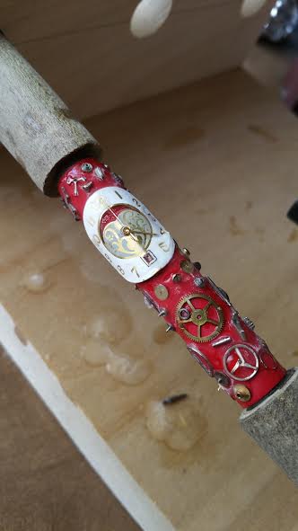

Will cast tomorrow! Waiting for the fumes to dissipate.
The bottom window of the watch face has a single diamond chip. Hope it shows up :)

Michelle, that is GORGEOUS !!!!! :):):)
I LOVE the shape of the watch face !!!!
Looking forward to seeing the finished pen.
You have obviously been working very hard on this one .... no posts from you for a few days and missed them ! :)

That looks really good. I'm interested to know if the diamond shows up too. Aren't diamonds hard to see in water? If so, it may well be almost invisible unless you know where to look.

What kit are you putting that on??? You have a few pieces that look like they are sticking up quite a bit from the photo. Make sure you check with your bushing diam. before casting. The red background should be a nice look. Good luck.

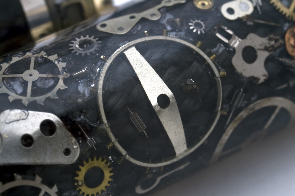

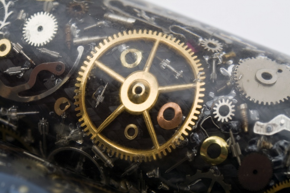

Just for reference as to what I mentioned was this. In these 2 photo's you can very clearly see the problem.
attachment.php
attachment.php
These to were made by 'the best of the best' but my goal is not to belittle or cause problems but to help inform. For many of us with a well trained eye for details defects of this nature is EASILY spotted from easily 10-15 feet from the pen. From casual observation of the photo you posted you to have this problem going on.
As do the majority of watch part blank makers out there.
In the first photo you can clearly see excessive glue where it was attached to the carbon fiber. In the second photo you can clearly see bubbles as well as excessive glue. There are notable difference in how the two look.
