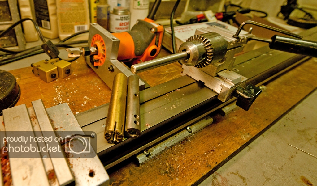

Die holder
Die holders are extremely simple tools and if you have the lathe you can make them as needed so you have a specific dedicated die holder for each die size you are using.
They don't have to be fancy to work perfectly, just minimalist functional is fine.
Mine is on a pilot.
Here is a picture of the pilot without the die
