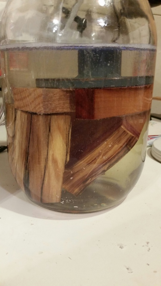

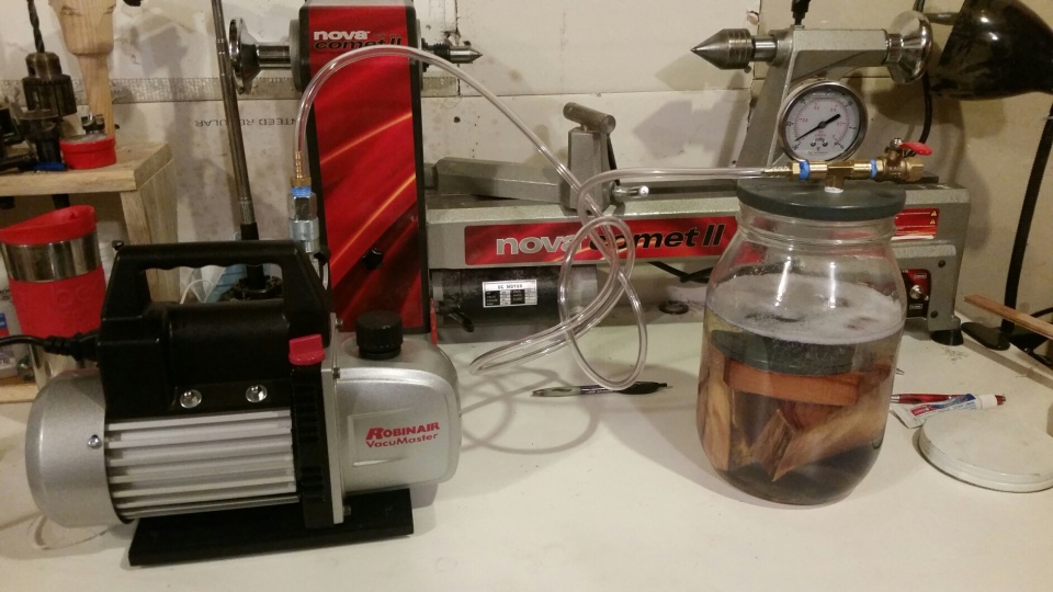

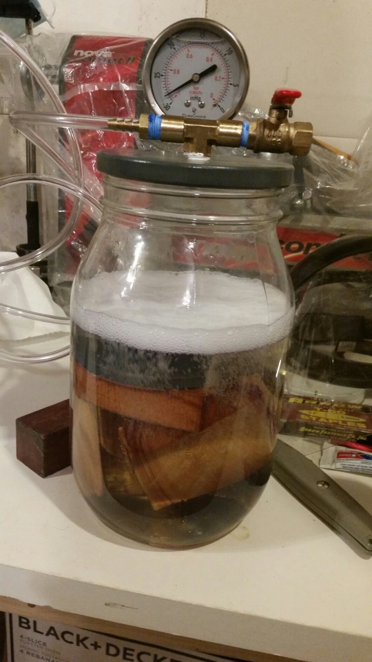

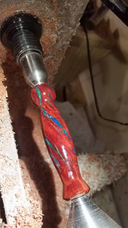

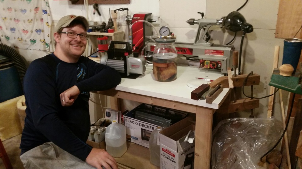

I am now stabilizing
I received the cactus juice and the lid for my pickle jar from Curtis at turn text.com this week.
I have never been so excited to stare at a pickle jar before. I do love pickles though! Here are some pictures of my setup again thank you Curtis!
I am stabilizing on my first run lilac, black cherry, oak, box elder, spalted maple, and Buckeye. The Buckeye actually has the seam ripper tube already glued through it. Will find out if that affects it.

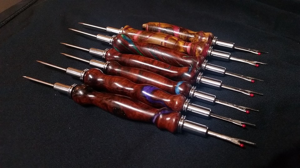

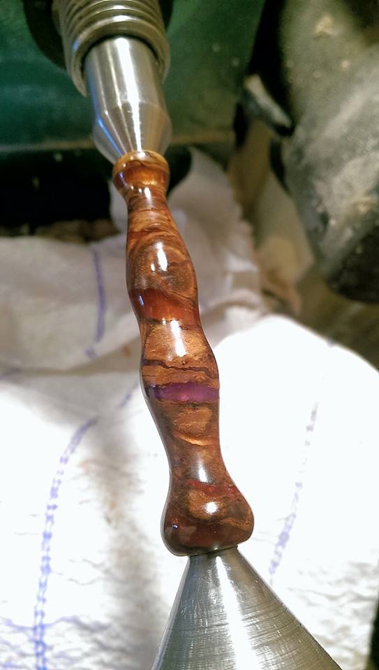

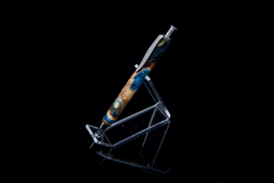

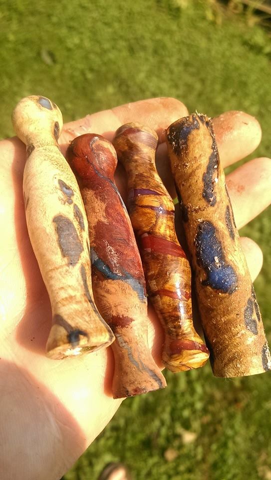

Pictures of Goerge's Wood I bought
Also, here is a video I put on Youtube on a seam ripper I made to be the grand prize in my facebook giveaway.
https://www.youtube.com/watch?v=EOEXbtI_hBU
Earlier this month I finished more of your blanks George and they are on my FB page.
facebook.com/cookcrafted

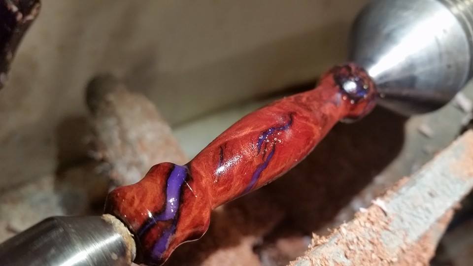

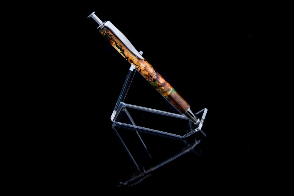

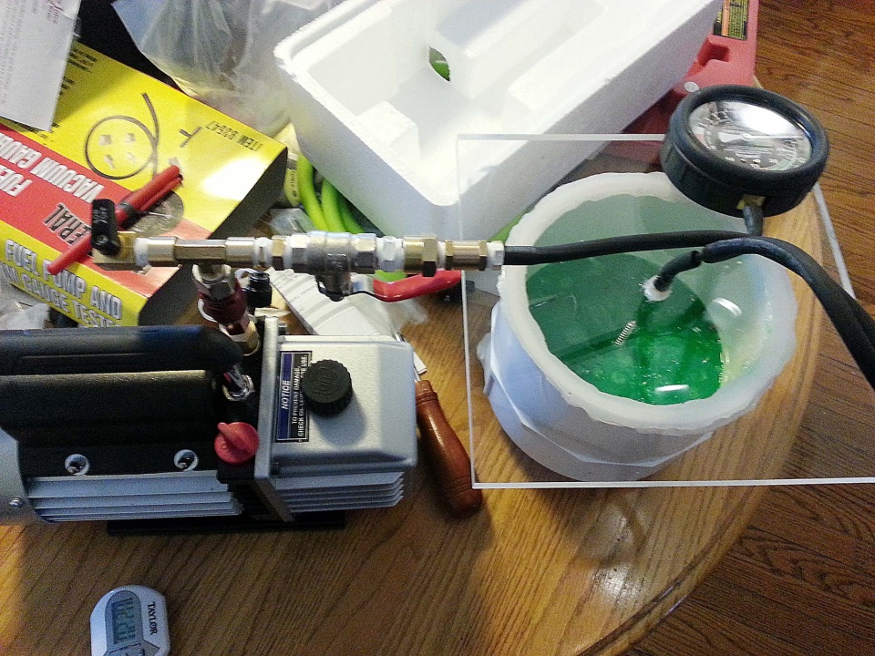

My first two attempts...
Just thought I'd share my journey down this path...
I decided to use sched 40 PVC for my chamber and did a couple of different sizes. I simply capped the bottom and left the top open. I use the same lid for all the chambers, which is 1/2" piece of acrylic with a single center hole for a "self tapped" fitting. For a gasket, I made the gaskets for each with a tube of 100% silicone. The vacuum pump is the three stage from Harbor Freight.
Making the gaskets turned out to be the trickiest part because it needs to be pretty flat. I thought I would just put some mold release on piece of glass and lay that on a wet bead of silicone on the PVC and let it sit overnight. Long story short... the silicone stuck to everything I tried. I finally hit upon something that worked really well which was laying out a piece of tin foil on a flat surface and then waxing it, then inverting the chamber onto the foil. The waxed foil worked like a charm. Let it sit overnight and the next day you can peel it right off.

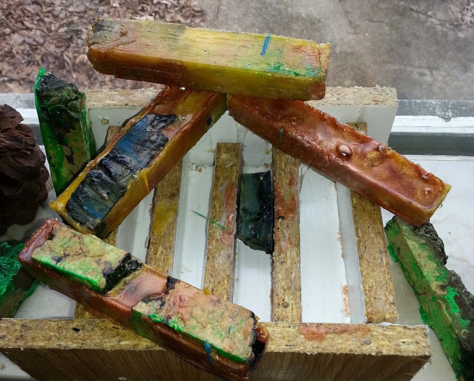

My first attempt was with an ounce of green Alumilite dye in a quart of Cactus Juice. The wood was dry, but not "overnight in the oven" dry and it didn't penetrate like I had hoped. Plus I didn't really like the green color. So I added some blue (maybe a quarter of an ounce) to what was left (80% of a quart) and I liked that color much better. It was weird how just a little bit of blue had a big impact... maybe there was something wrong with the green dye... And For the second batch I over-nighted the wood at 200 degrees, then into the Cactus Juice and Vacuum it went after it had cooled. Much better take up of the die into the second batch, so I'm sold on over-nighting in the toaster oven for next time.
I picked a couple of pieces of the (first batch) green stabilized wood and a couple of pieces of the blue (second batch) and cast it in some bronze and yellow colored Alumilite Water Clear.
I'll attach a pic of the chamber, the blanks, and how one of the green batch turned out as well as one of the blue batch (my personal favorite).
