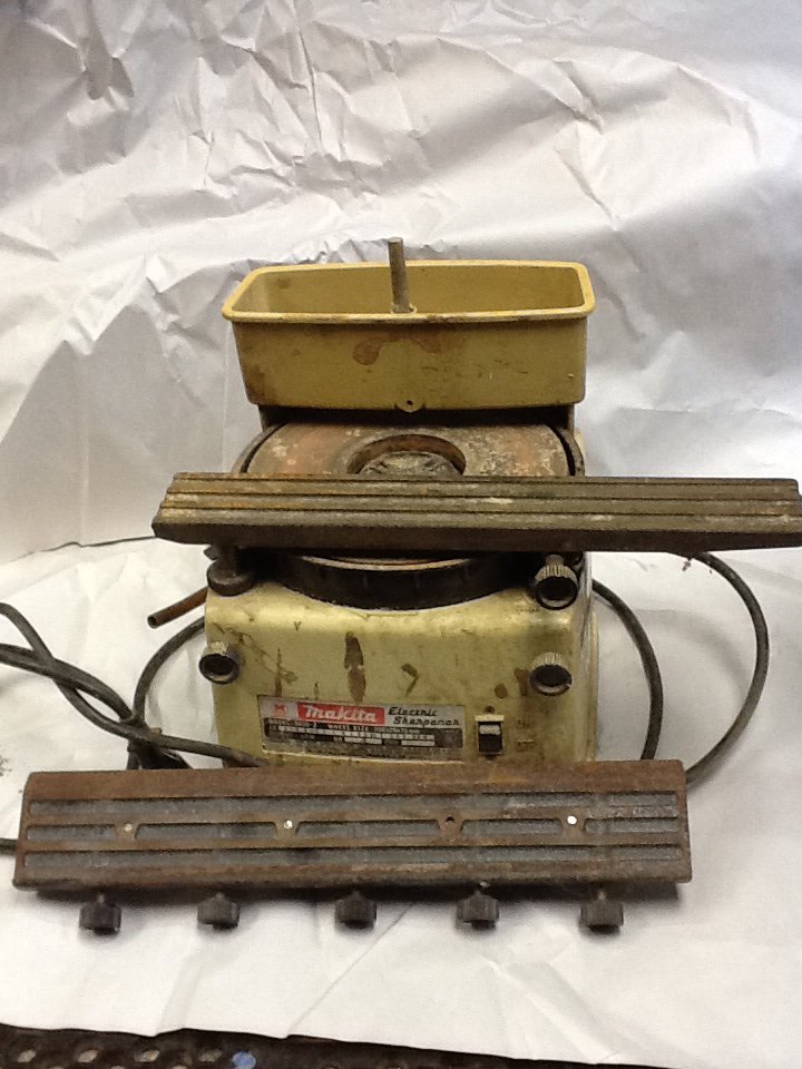

I know you asked for a Tormek ... I have a makita that is collecting dust if your are interested.

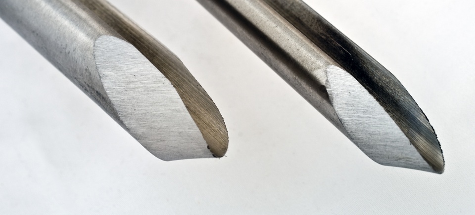

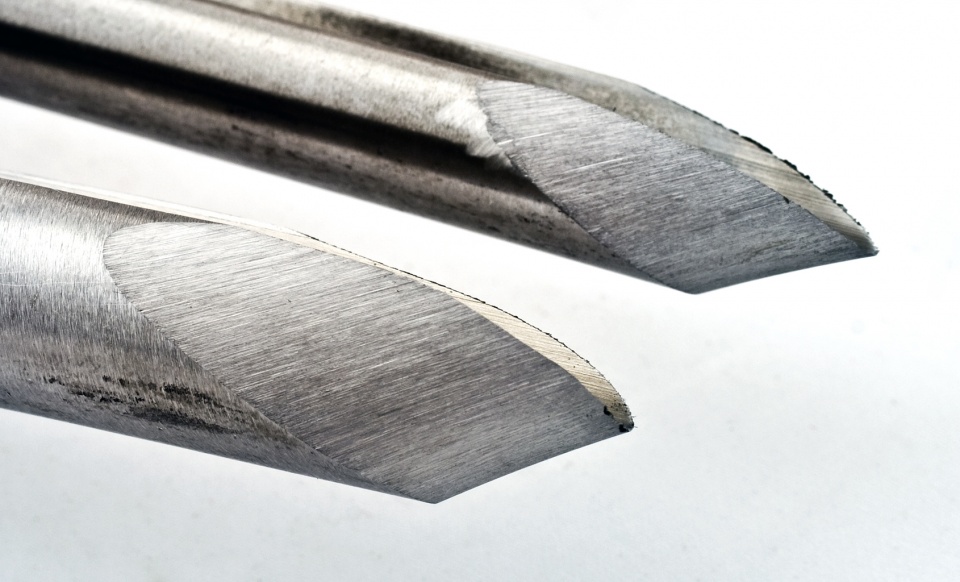

I use the T10010 10" grizzly, I bought the tormek gouge gig for around $100. For skews I use the included gig that came with the grizzly. currently I do not have the flat table gig but I do use my 2x72" knife grinder for that.
These 2 images are bowl gouges that I have a 1/2" from craft supply and a 3/8" benjamin's bent.
