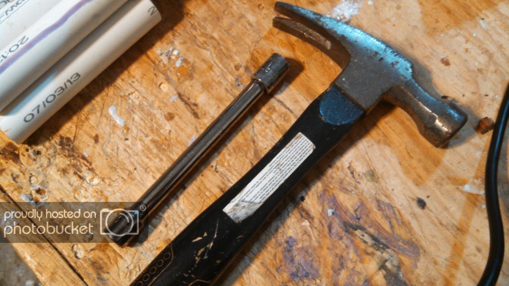

Here are the items I use. More readily available for me than Silmar or Alumilite.
From top left.

Hammer,6" extension and 12mm socket. This fits the pvc mold perfectly for knocking out the blanks when they've cured. Mold release is not needed for pvc. A few taps on the bottom and the blanks pop out. Easy.
