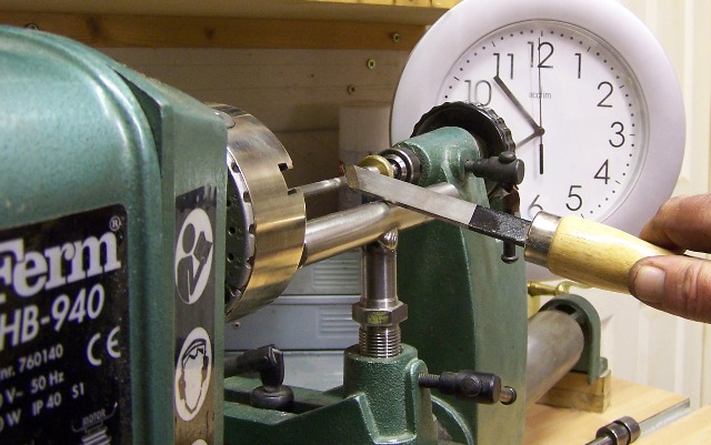

Quote by Ed; I am touching the blank at about the 10:15 position
Ok, I'll have to think on that for a bit :confused:
Damned digital watch is useless:mad:
It's easy. Start now ....
.. and stop at 10:15.
Sheesh .. why do you WEAR the thing if you don't know how to use it? :tongue:
OK, 22:15 for the Brit.
Ok, I grabbed the clock from the kitchen and guess what....???
Humph!!!! That still puts me behind the lathe:rolleyes:
My lathe turns clockwise, so I think I'll try first at the 2;15 point first. If that doesn't work then I'll move it away from the wall and try your method:biggrin:
Now I understand why Skippy's view on life is BACKWARDS!! You're lathe is running the wrong direction!!!
(Do metal lathes run clockwise for making threads? Or, is it reversible?)
I honestly know nothing about them.
Metal lathe with a skew??:eek::biggrin:
I'm sure our lathes all run the same way, so our clocks must be different:tongue:
AAARGHHH !!!!!! I just got it!!!!! You are looking from the tailstock end:eek:
But my headstock will get in the way of the clock, so I guess I need a much bigger clock. Damn, this is pen turning mallarky is getting expensive.:mad:
:biggrin:
Run your headstock spindle through the centerpoint of your clock face. NOW, time will stand still!!! But your spindle will turn counterclockwise or "anti"clockwise.
Now I'm really confused:confused: The headstock is the end with the motor thingy right? Mine doesn't move :confused: Think it's broken? The other end moves though, is this perhaps the headstock??
Could you be a bit more specific about the direction please? What determines if it will run counterclockwise or anticlockwise? Could it do both? :redface:
I'm gonna have to sleep on this, but thanks for all the invaluable help so far:biggrin:
G'night

Mostly, thanks for helping Dawn choose the camera!!!! It is a marvel to me how easy it is to use. More practice coming!!!
Chuck,
Yes, I dry sand ALMOST exclusively. I have no argument with those who use water, I just don't see a need. I sand to 800 and then buff with tripoli and White Diamond. I am assembling the pen about the time you are switching to the 8000 (that's about the 12th pad, I think)!!
Seriously, the results of either method can be equally good---do what makes YOU comfortable.
Hi Ed,
This was my biggest surprise too.. dry sanding - dang it, gotta try that. When you say "ALMOST exclusively" my mind wonders as to the exceptions. Care to elaborate? Also, what grits are you running through? Do you reuse the paper on the next pen or discard? Who woulda thought one would have so many sanding questions.
Finally, I personally would like to see your finishing process with the buffing steps included - I want to compare if I am buffing for too long on each step.
Thanks for the video Ed - better than I would be able to do.
JP
