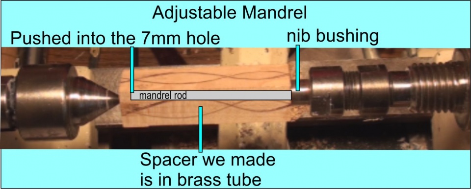

The video does not show the last step of parting off the end. Is the internal sleeve able to support the blank from just that end so the tip can be rounded?
Yes, as long as you are a little careful. Sometimes I think the camera is running, when it is not.
I could easily make another vid on that aspect---it is kind of interesting and I have all the "stuff" to do it.
Thoughts? A short "5 minuter" or not worth the effort?

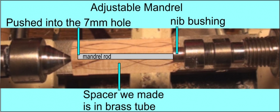

Something else that was puzzling.
One of the screens with notes indicated that the live center was riding inside a 7mm hole. However, I did not see where that 7mm hole was drilled into the closed end of the blank.
Was that just a shallow 7mm hole to hold the live center?
When I do this with my closed end cigar pens, I hold the end in a chuck and advance the live center just far enough to support the end. The when the last little bit of the wood is turned off, it is still supported and will not go flopping around.

Well, you "made me look"!!
And, I understand what you saw vs. what I meant.
attachment.php
I can see where the original version was unclear. I hope this better defines the setup.
IF this is too big for your screen, hold ctrl down and touch the minus sign, the screen will resize to fit, may take a few pulses with the minus sign.
To get back to normal, hold ctrl and touch the plus sign, same as above--it will make the screen image larger.
Sorry, I could not get the image to resize--don't have all the tools on this computer.
