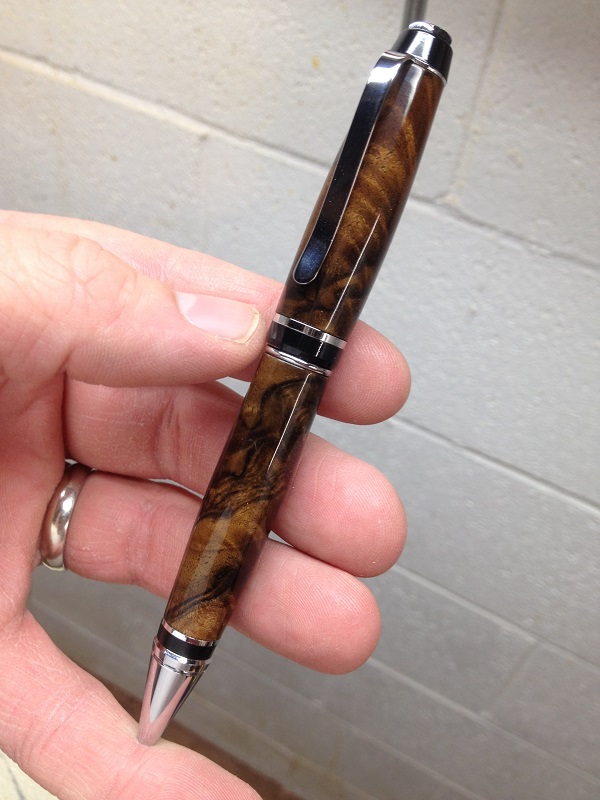

My favorite way to finish walnut is this:
After turning, dry sand through 600 grit. Then wet sand with 600 grit with a 1:1:1 mixture of BLO, de-waxed shellac, and denatured alcohol. This is actually a friction polish too, so I do allow the heat to build up a little and allow it to "set." One added bonus to this is that it also helps to fill in the pores on walnut.
I then set it aside for a week or so to let what I've applied cure. Then I give it a very very light dry sanding with 600 grit, then go on to a CA finish.
One of my most recent pens from a piece of figured english walnut was finished this way, as is seen in the attached picture. I've done a straight CA finish on walnut and it just doesn't have that wow or pop to it. But when I use the 1:1:1 mixture and wetsand the walnut with it, then later apply a CA finish, it really pops. (I don't do CA/BLO - I use an accelerator.)
That's a beautiful finish, thanks for sharing. I'm m not sure I have the patience to put it aside for a week though. :redface:
Thank you! For me, setting it aside for a week or more isn't a problem. I get so little shop time these days that most pens I turn get turned and then sit at least a week or two (or, sadly, longer than that) before I have time to switch over to finishing and finish them. :redface:
