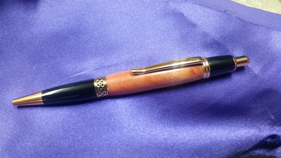

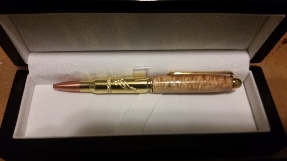

I have not used the walnut oil and CA together. I usually use 4 drops of CA thin and 4 drops of CA medium. I sand between the thin and medium coats then i do a final sanding before the MM. These are pens that i have made with the CA method i use.
