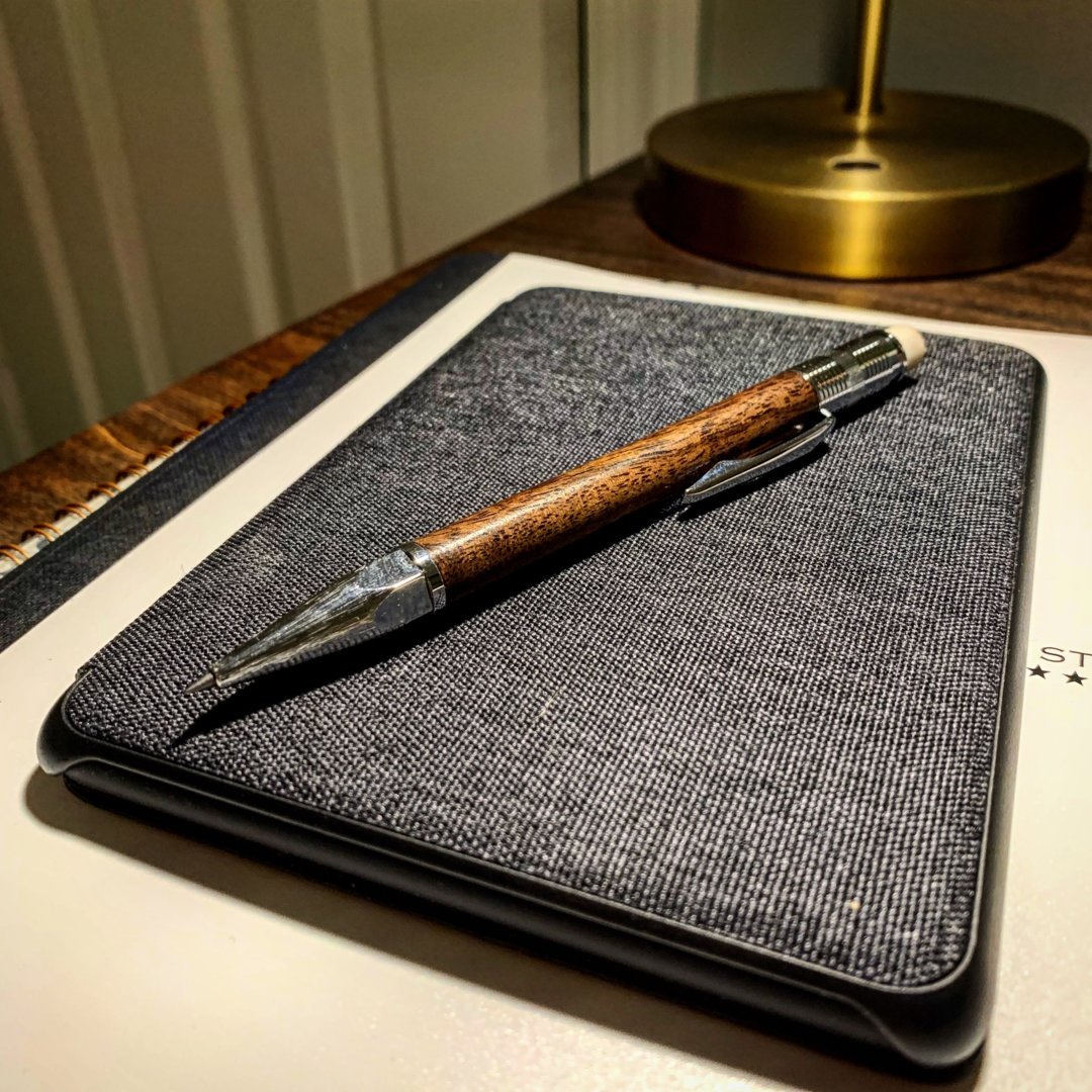

Walnut Mechanical Pencil
Chippa
May 22, 2019
67
New York
Made this one for my wife to use in the office, she loves it so I'm sure this won't be the last one.
Chippa
May 22, 2019
67
New York
First one of this kit yes, and one of my first turnings as well, just starting out, thanks for the response
John Eldeen
Apr 3, 2019
419
Sacramento, CA
Well then congratulations on a job well done and just a little information on this and all of the different kits that have the sharpener in the cap. When assembling the click mechanism threads into the nib. Carefully put a dot of thick CA on the threads. This will stop the mechanism from unscrewing when sharpening the lead.
Keep up the good work and have funđź‘Ť
