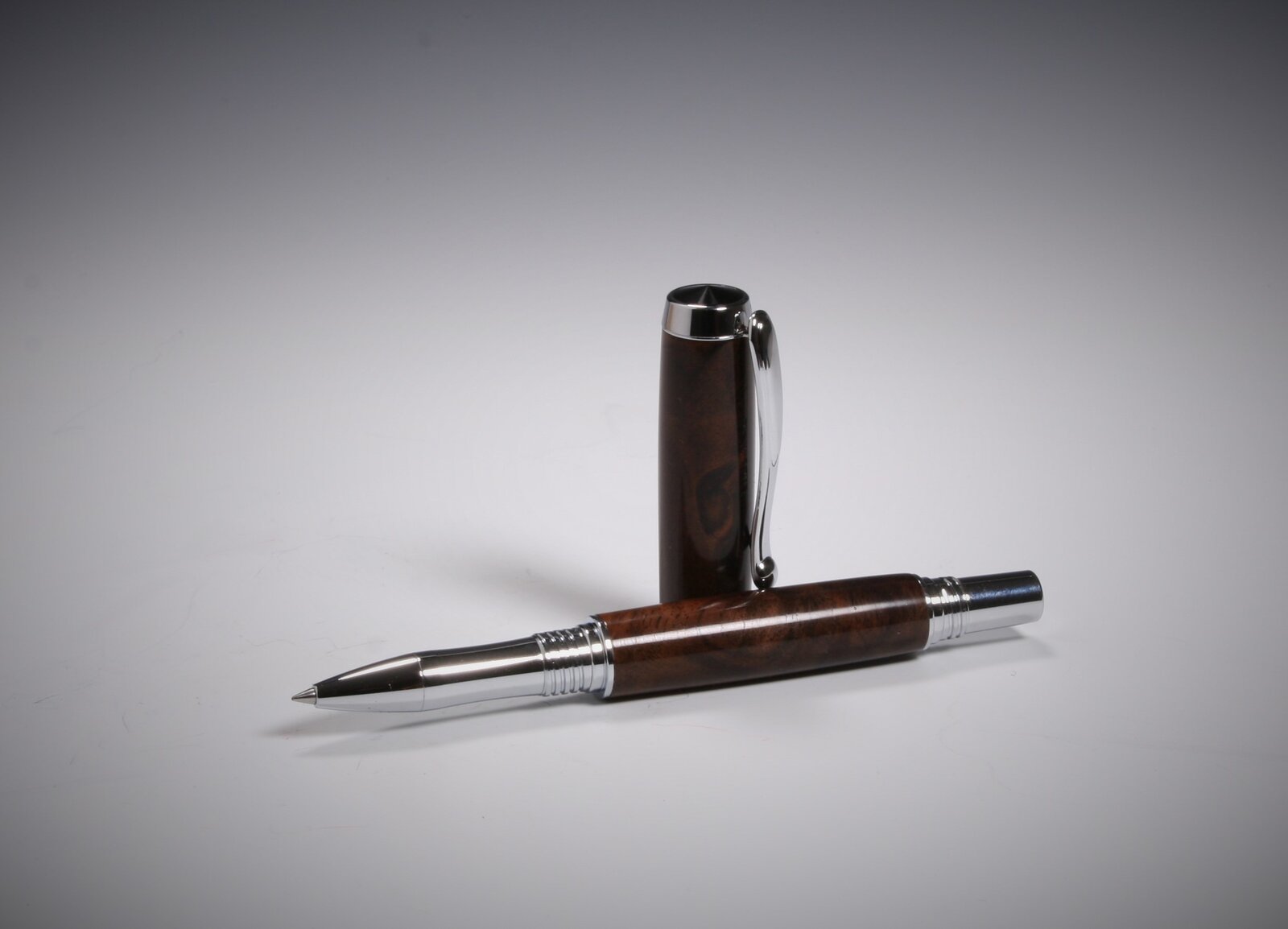

I did use thin Gluboost a little at a time and sanded so the dust went into the pores and inclusions. It took a long time and took the advice given about cleaning with DA after each time. Once it was all even I finished using Gluboost thick, three coats and thin four coats. Through the Zona grits and the three Novis steps and a final buff with Ren. Wax Junior George walnut pen for Dr. Hennesy Gluboost.JPG
