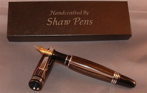

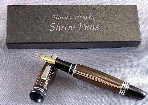

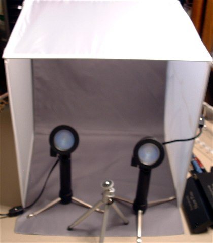

For $49.00 I'll give it try. Comes with 16x16 compact light tent that folds up into a carrying case. Has to lamps - only 20 watts not very bright and a compact tripod.
Picture with only the two supplied lamps.
Picture with two lamps plus flash
Opinion: Not bad for the money. The thing I like the most is it's compact design. folds up into a small carrying case stores anywhere.
Not happy with just the lamps. Need to get brighter bulbs but with the flash, did not get any wash-out either.

I purchased the same exact tent and am very happy with it. I did replace the bulbs with 50w bulbs and it makes a big difference. I have not tried shooting any with the flash on though....All in all, I am satisfied as well...

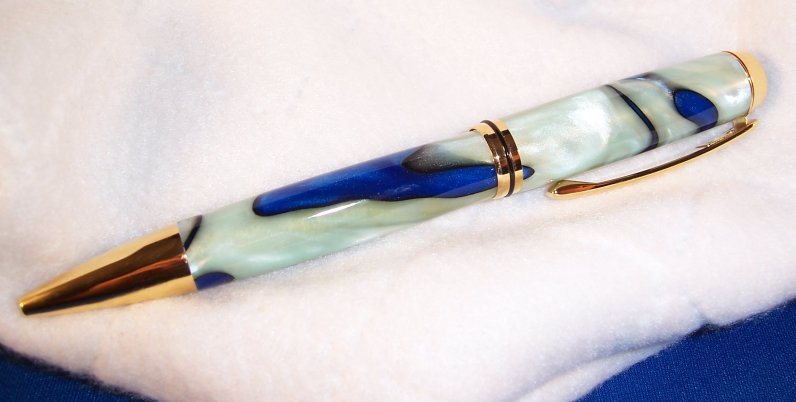

Taking a suggestion from above, I purchased two extra 50W bulbs and switched out with the original 20w bulbs.
It's going to take some time figuring out where best to place the lights but so far I am really pleased with the difference, here is a pen I turned last night, it is much clearer and brighter than my previous photos.

A couple of important suggestions I might offer ... be sure the placement of the lighting used is (1) not too close to the fabric sides. This will help prevent possible 'hot spots', and (2) make sure the lights are NOT aimed into the camera lens at all. A diffusion disc of frosted plastic (professional camera store as a source) in front of the lights (be careful of heat melting them) will help out here. Another method is to use white cardboard as a tent for the sides of the camera lens that is facing the lights. I use them simply propped up against the lens and the light diffusing material - watch for possible shadows. (3) Try using a polarizing filter and test for enhancements in color and fine detail. These filters DO NOT work well with fluorescent lighting but should help when using these halogen lamps. Be sure to let the halogen lamps get up to temperature before making the photograph. [:D]
