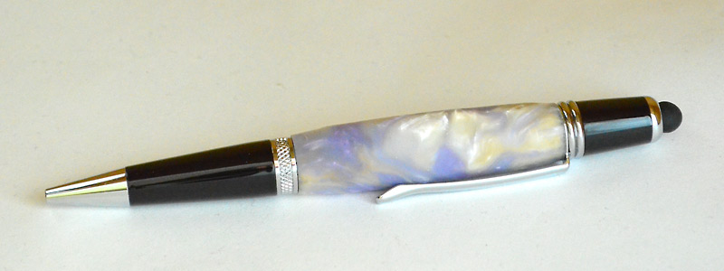

Had more trouble turning this acrylic even though tools seemed to be sharp and I sharpened them about 5 times while turning.
Floor wax and car polish just aren't working for me anymore. Should I start using HUT?

Do you use micromesh?
I use micromesh and go up to 12,000. I think it looks good but because it is wet at this point I think it could look better. So I guess I'm looking for the ultimate finish beyond micromesh and I haven't found it yet. I've used brasso, Johnson's paste wax, and Meguire's polish.
Micromesh alone should be shinier than what I think I am seeing in your photo. Are you stopping the lathe and sanding end to end as you rotate the spindle between each grit? Also, are you wiping of the previous grit before going to the next?
The pen should look really good when you have gone through the MM. I hit it with Meguiar's Ultimate Polish just because I am OCD when it comes to pens.

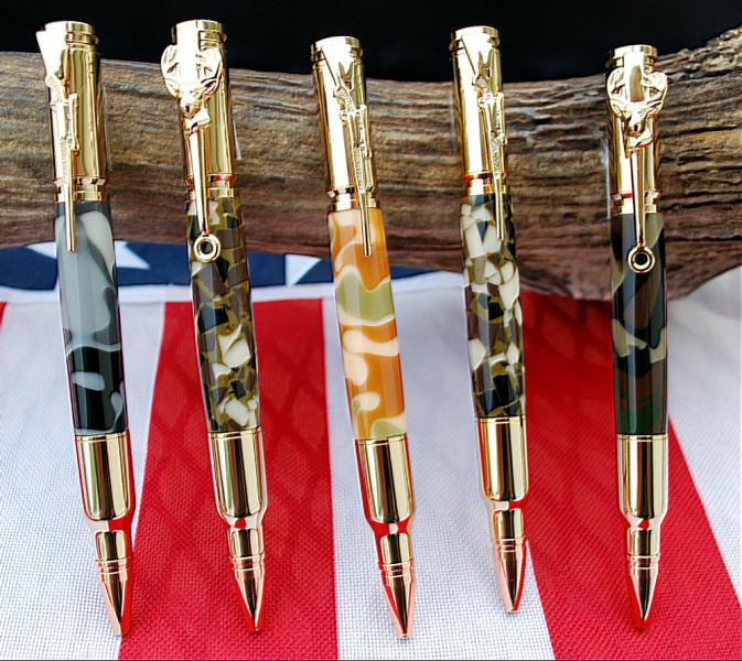

Paul,
I have attached a picture of 5 (just finished 4 of them yesterday) bullet pens with camo acrylics. My pic is a little blurry, but the blanks shine like glass after buffing. The only two that the tubes have been painted, are the urban and desert camo.
You could probably buy everything you need (if you wanted to try it on a drill press) for around $30-$35, and use it for anything else you may need to buff. Two pads, and two sticks of compound last me a long time.

Paul,
