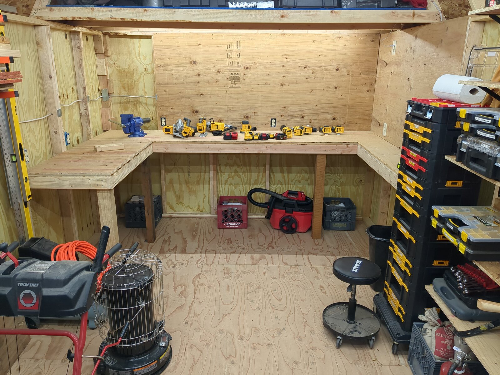

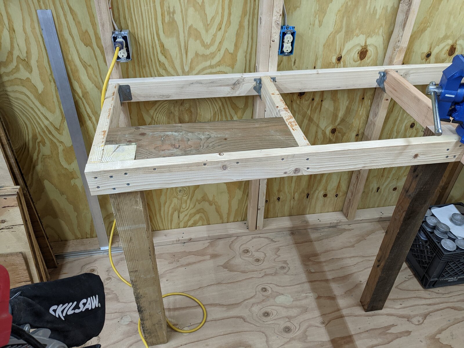

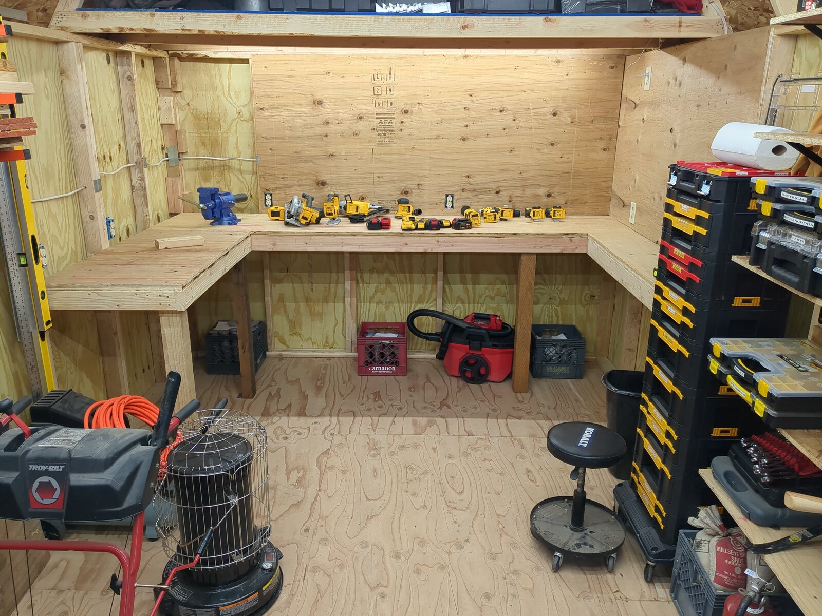

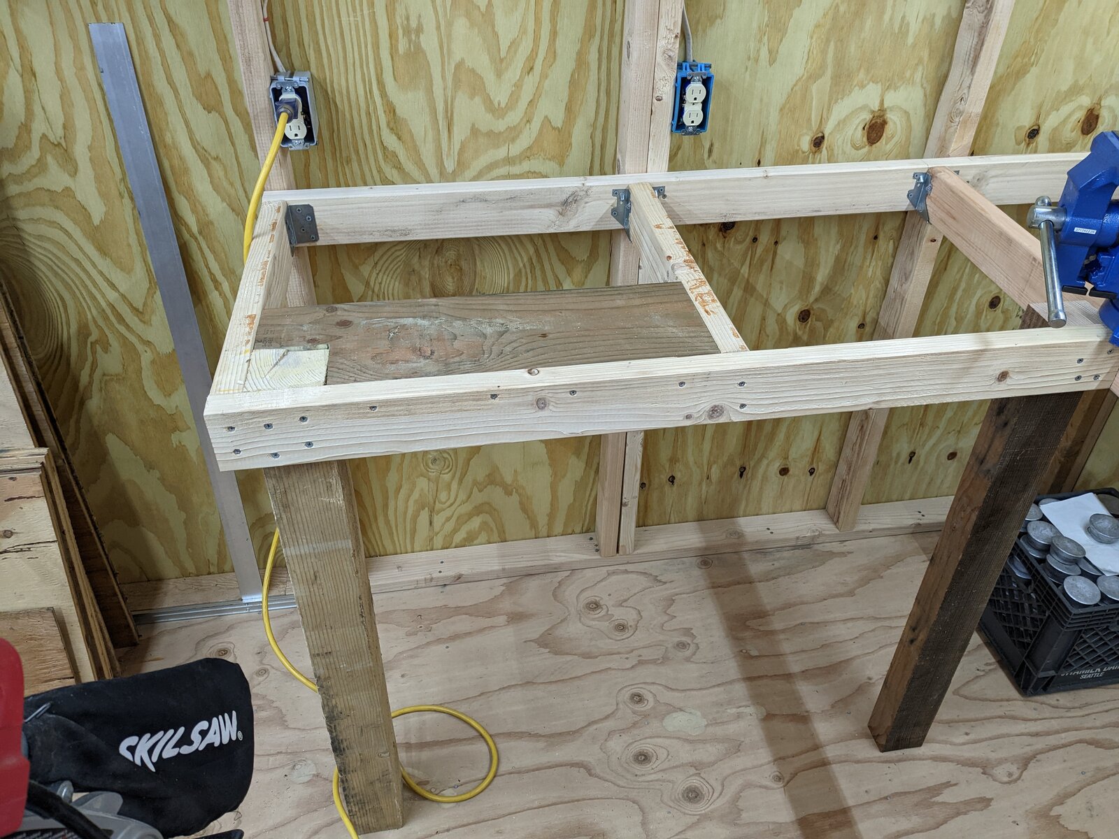

If it's just a flat bench top with no framing then a 2x6 stringer mounted to the wall for the bench to set on is the way to go. If the bench has some framing you can just secure that to the wall studs. Add 2 to 3 4x4 legs to support the front of the bench and your good to go.
Pics are of the bench I built in my shop. 2x4 framing, 3/4 ply deck and 3x4 and 4x4 legs as I had a couple cutoffs of both sizes. The blocking in the first photo is were my vise got mounted.

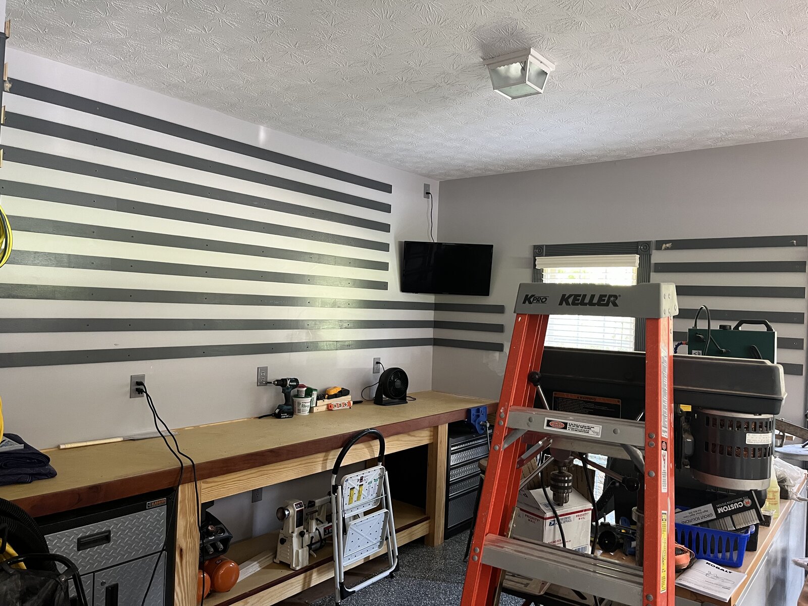

I have a Wall mounted bench (about 16' in length) with my miter saw in the middle. It is attached using the French Cleat system. There are two rails (upper and lower) that gussets hang from. There is a secondary stringer towards the front of the work surface to keep from swaying (there is one on the back of the work surface for the cleat connection). Used angle clips to attach the top to the gussets and stringers. Frees up a lot of the underneath space as there are no legs to the floor. Very solid and sturdy.
