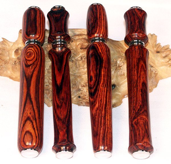

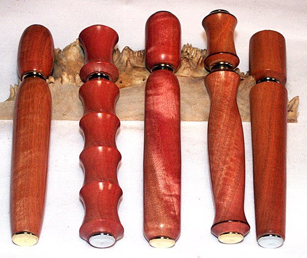

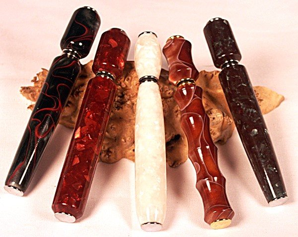

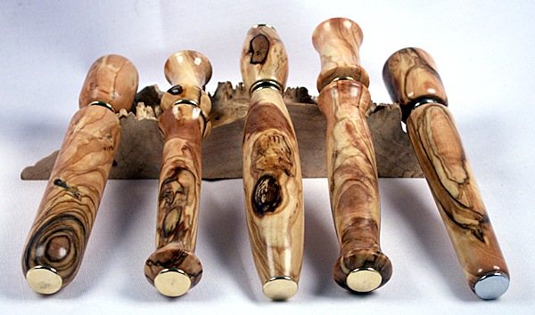

Well I broke down and set up a photo box... let me know what you think of these compared to the old photos I posted.... The worst part was getting these suckers to balance on the piece of wood I used..
I used 100 watt daylight incandescent bulbs, but think I am going to change to daylight flourescents I have been told they work better without hotspots. The only thing done was cropping and letting Photoshop decide the AutoLevel, Contrast and Color Correction... I did not want to play with them at all... I think the white acrylic threw off the exposure on the acrylic photo...
These are pics of some perfume pens I turned yesterday and assembled and photoed today... Acrylic, Bethlehem Olive, Cocobolo and Pink Ivory..
The cocobolo is from ILikeWood.. the only person to buy it from
The BOW is from a special deal they ran on some "B" grade.. this stuff has some wild colors in it.. even some real subtle pinks.. very nice stuff...
<center>Acrylics</u>
Bethlehem Olive Wood</u>
Cocobolo</u>
Pink Ivory</u>

WOW Tom what a difference, and I agree with your assesment of the Acrylic photo with the addition of a couple more observations. you not only have a white object conflicting withthe dark objects. but even the dark Applicator jsut to the right is sending back alot of hot spots. you can see in the white Applicator that the photo did a better job af getting the light colors than the dark. but it didn't do an excellent job of that either. that is what kept me looking for more of a problem. still good photos as the extreme contrast is always very difficult to get. it menas a compromise in one direction or the other, overexpose and wash out the light colors while bringing ou the detail in the darker ones, underexpose and the dork ones become shadows but yo can see the light colors real clear. IF you really want the light and dark together you coudl take seperate phtotos of each then cut and paste the light one into the picture of the dark ones. but that is a whole other photographic adventure. the other photos are right in there.

I agree, but I did not want to do any other intervention on these... The acrylics could have used some help, the other three are pretty much dead on... but a little tweak here and there could be done... I should have taken the BOW's from a different angle to make them stand out more...
