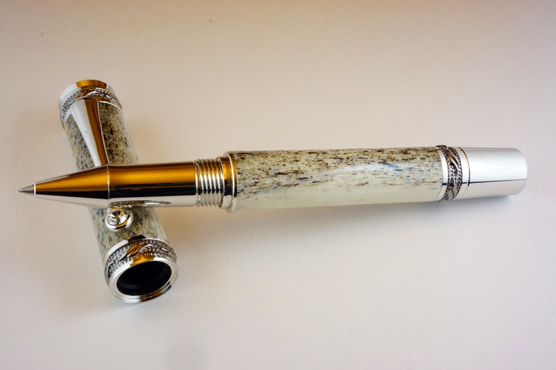

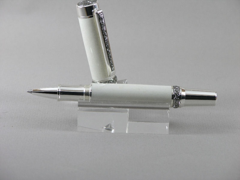

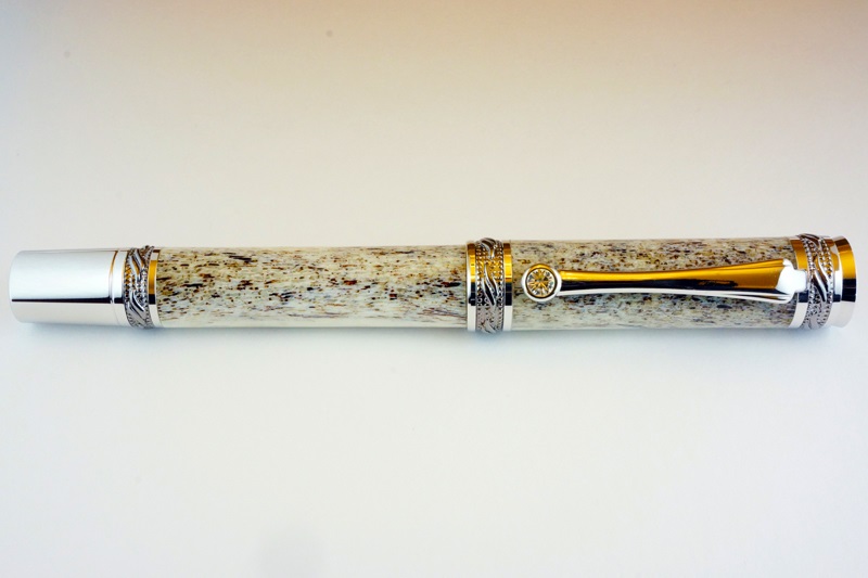

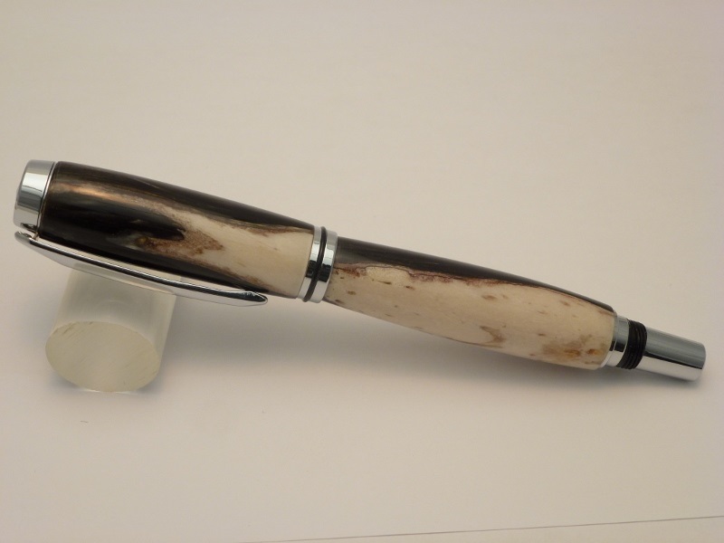

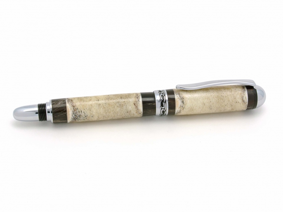

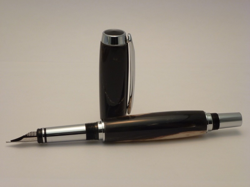

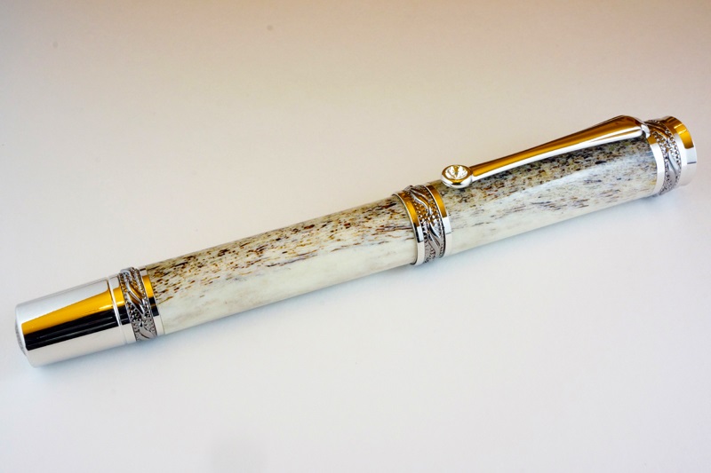

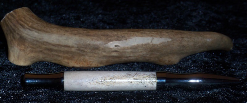

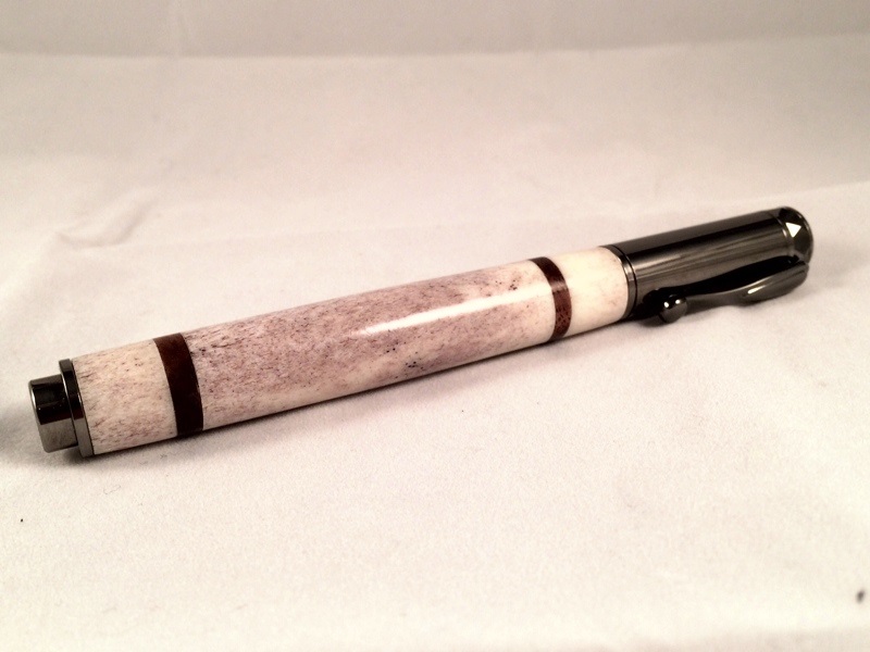

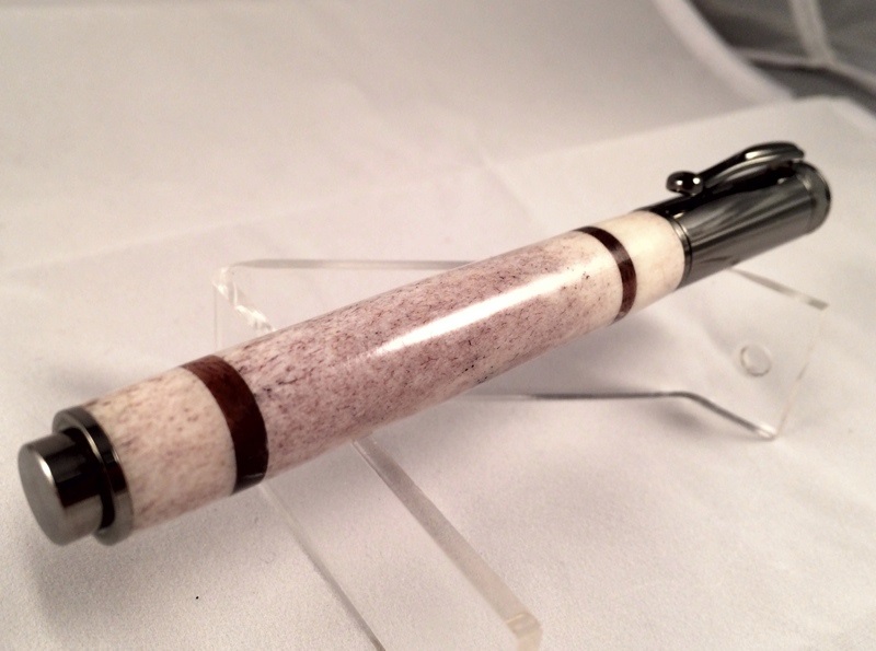

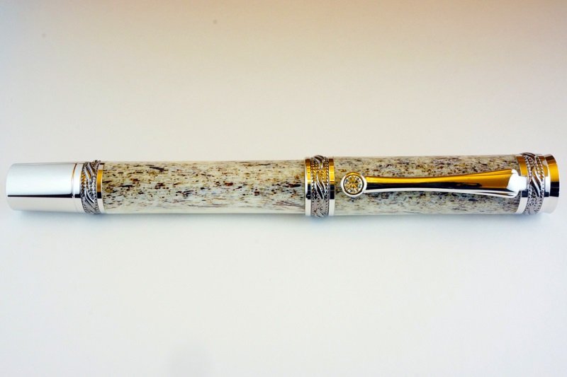

Pen #1
Pen #1 -
Full size Emperor Fountain Pen with Horn from a Dall Sheep in Alaska. It does have a different smell from some other antlers I have used but stinks none the less.

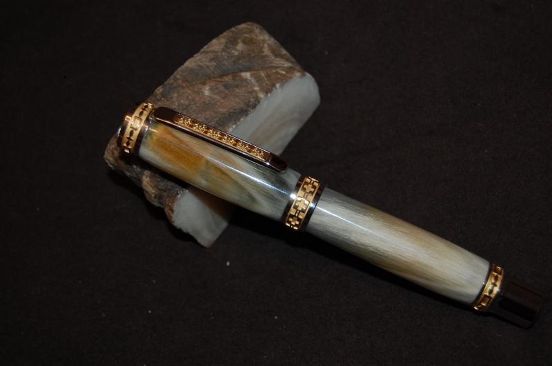

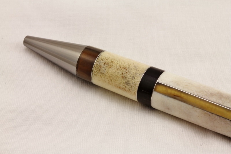

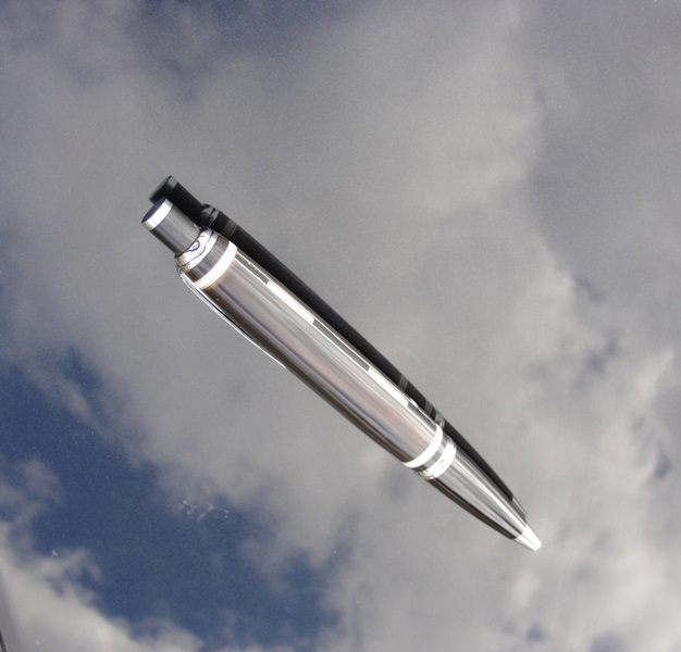

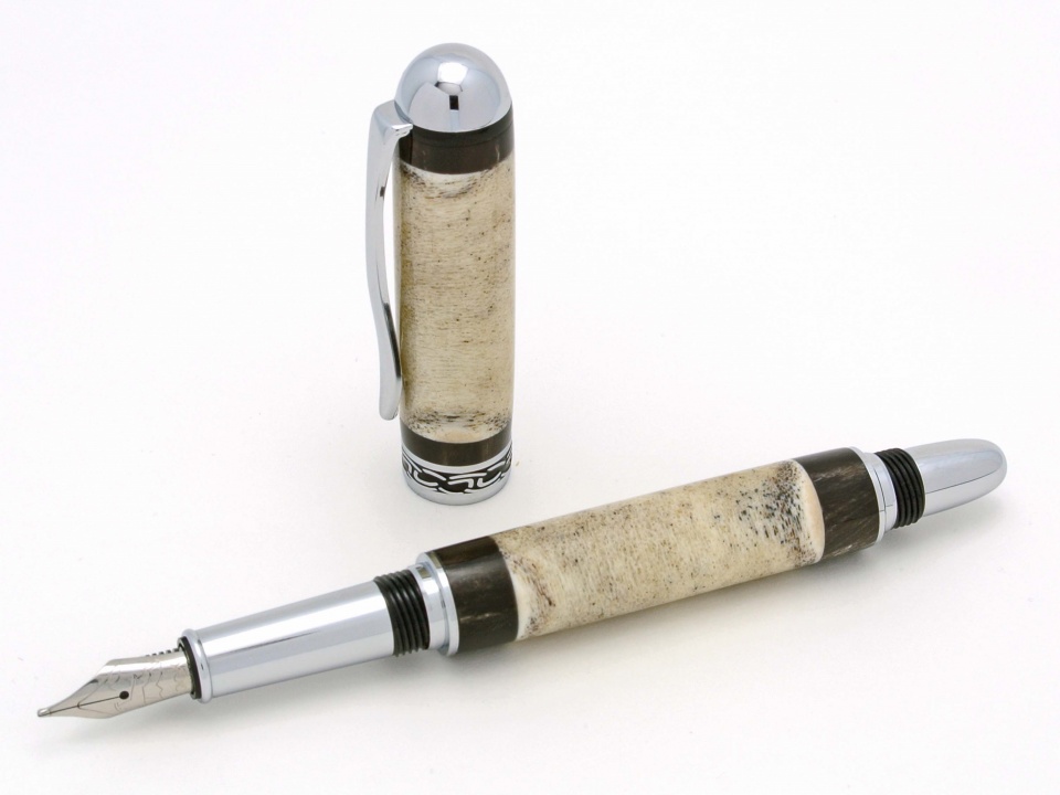

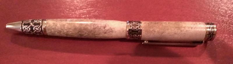

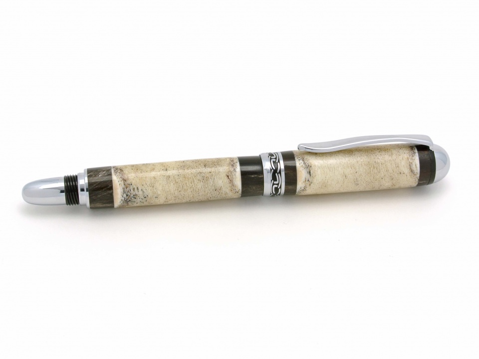

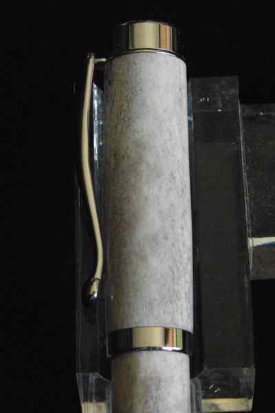

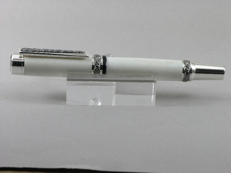

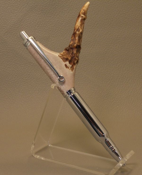

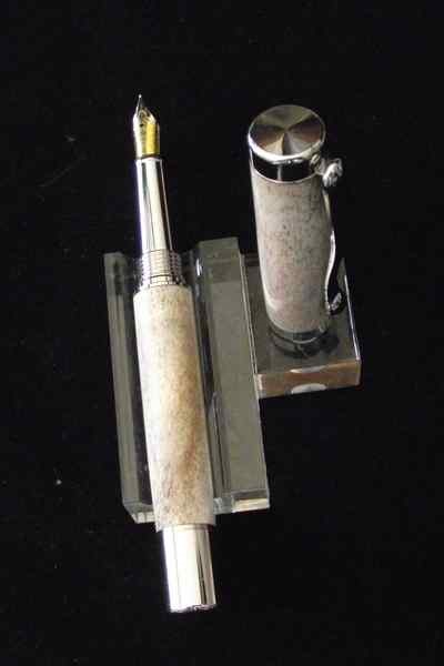

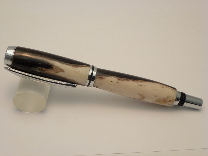

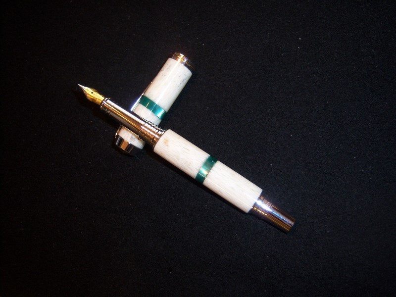

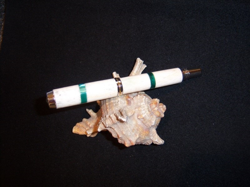

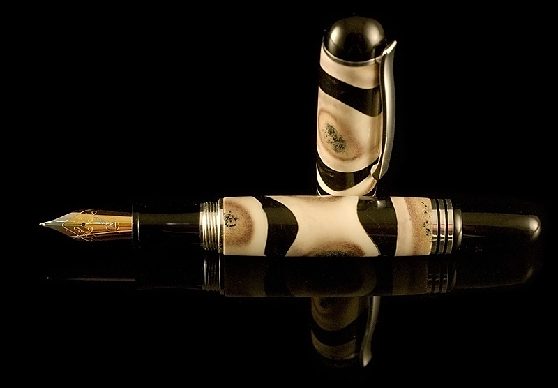

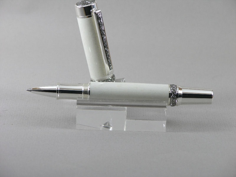

Pen #2

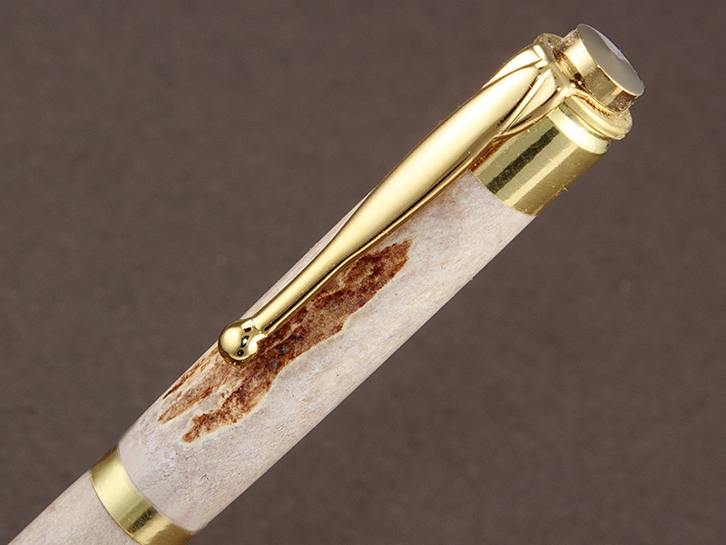

Pen #2

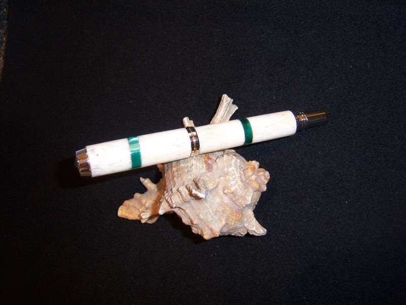

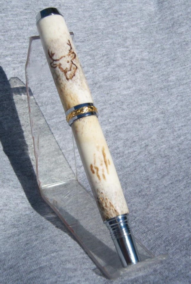

Canadiana pen kit, sterling silver with black titanium accents. Section of moose antler that is almost pure white. Pen is intended as a gift for a friend

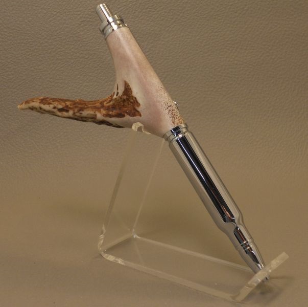

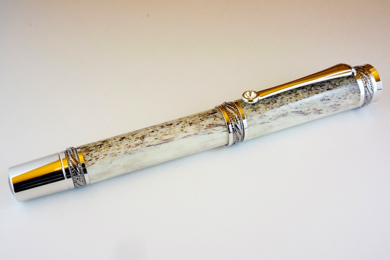

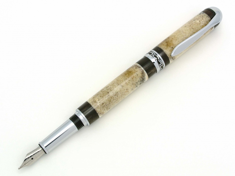

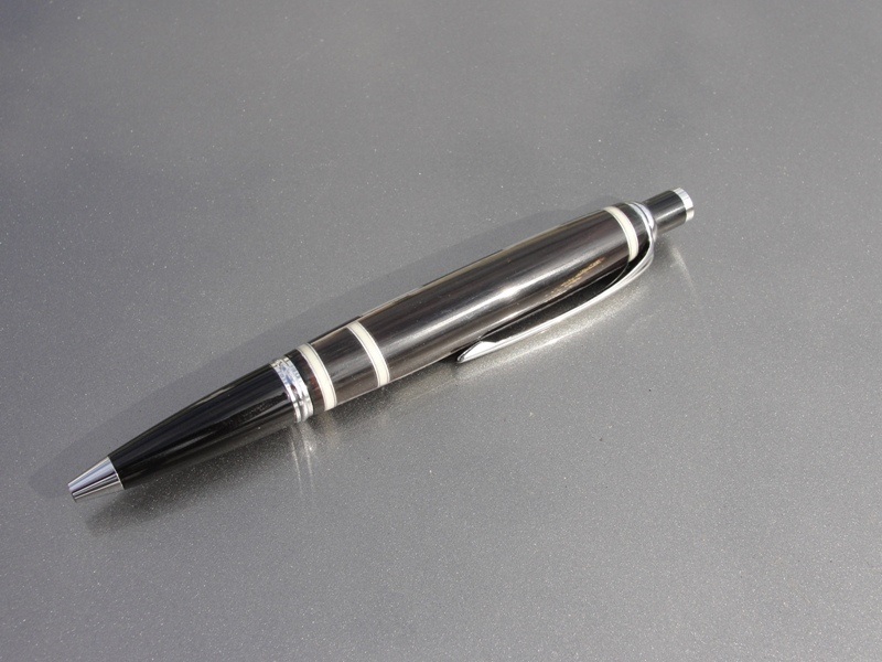

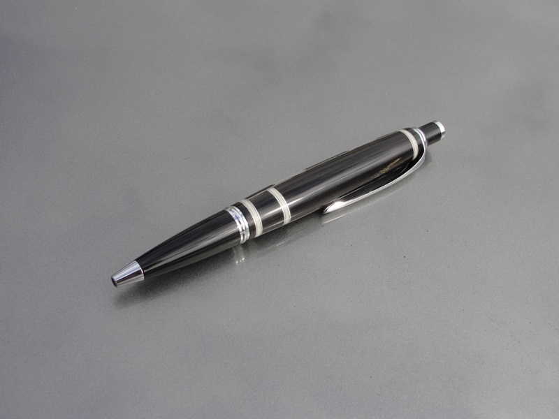

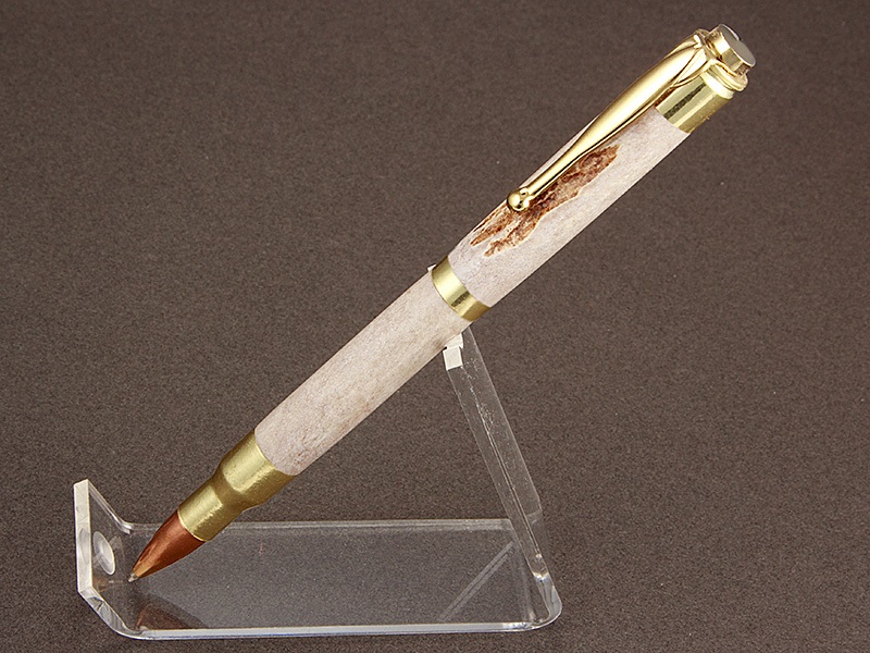

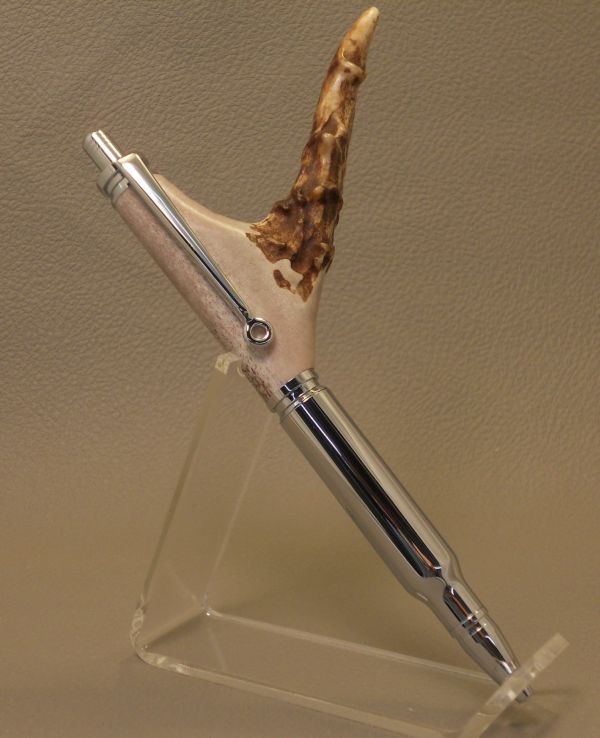

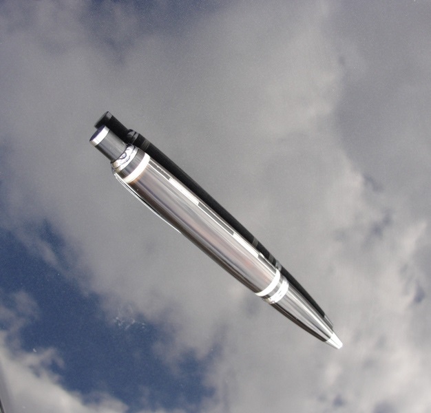

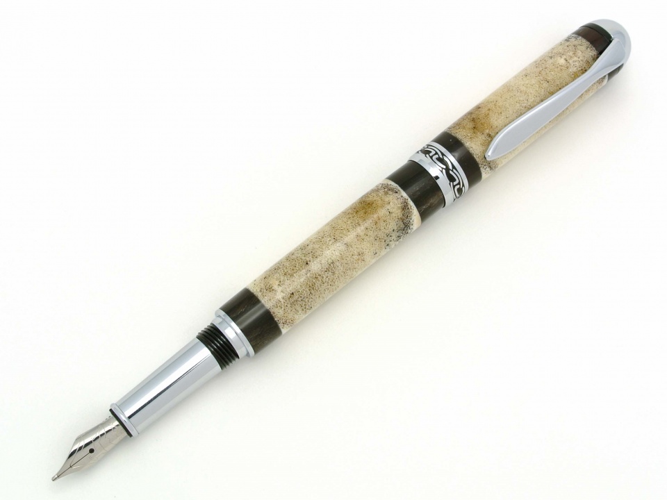

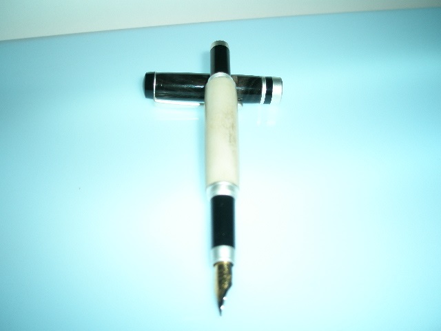

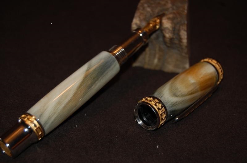

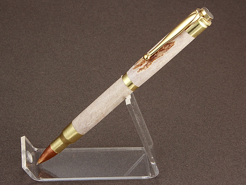

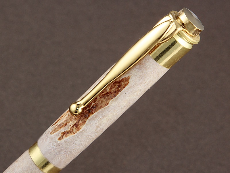

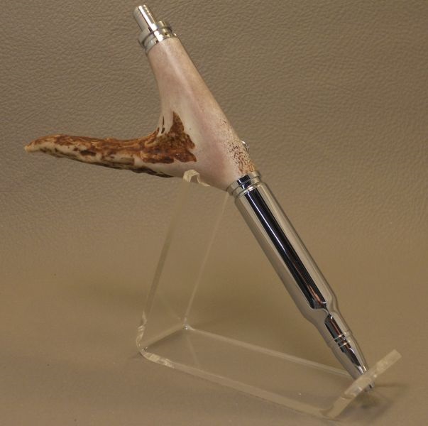

Pen #3

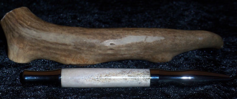

Pen #3

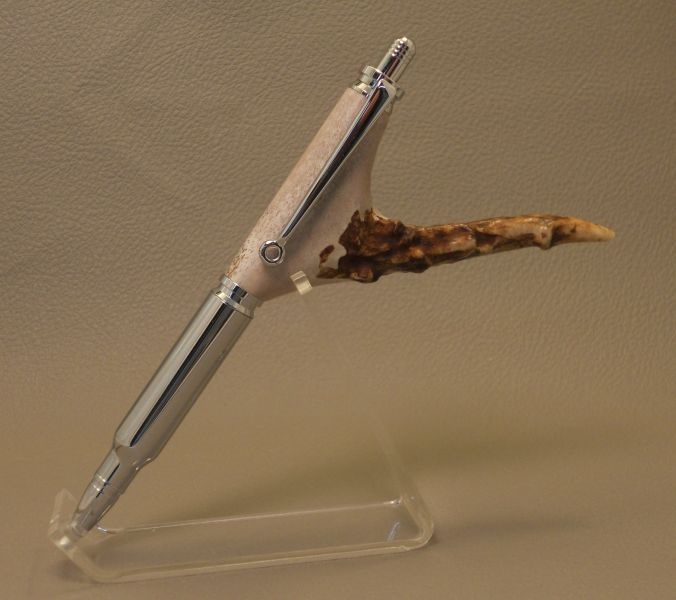

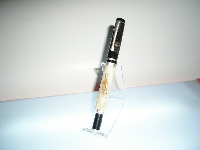

This is a hand shaped brow tine antler pen on a chrome PSI Cartridge Click pen. It is very comfortable to hold and write with. I turned the ends, carefully avoiding the rotating brow tine, then shaped the body using a combination of belt sanders and hand sanding. It is polished up to 400 grit and buffed out on a cloth buffing wheel.

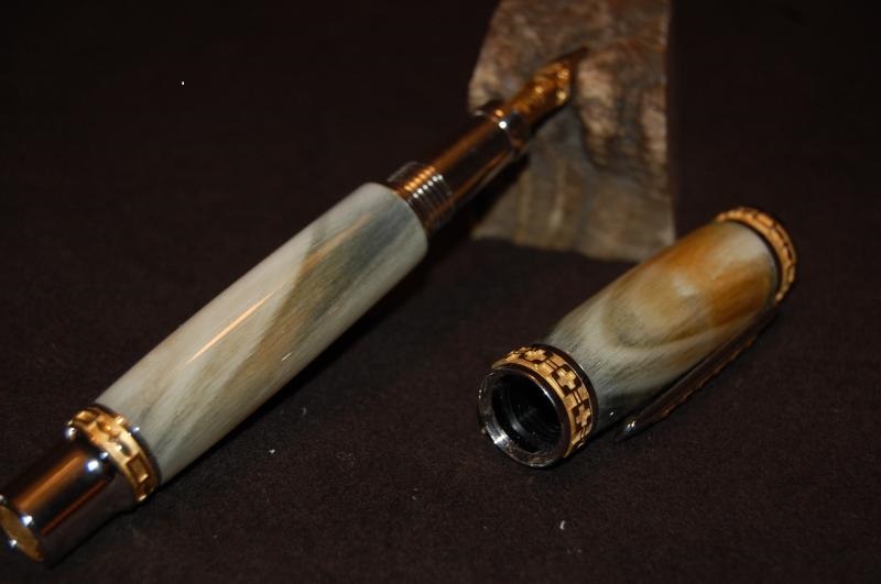

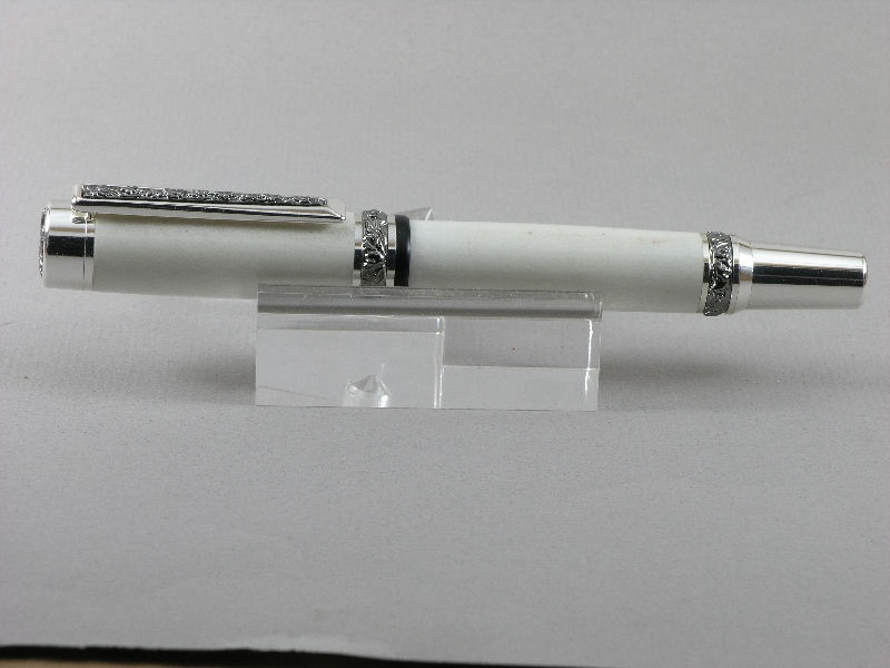

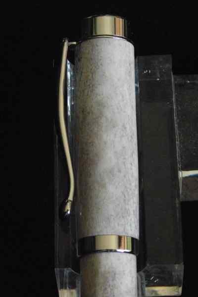

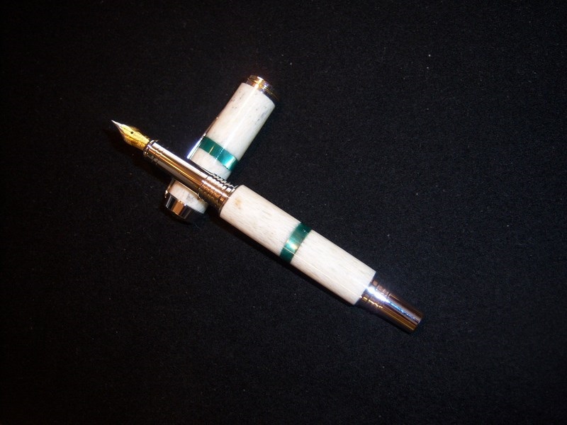

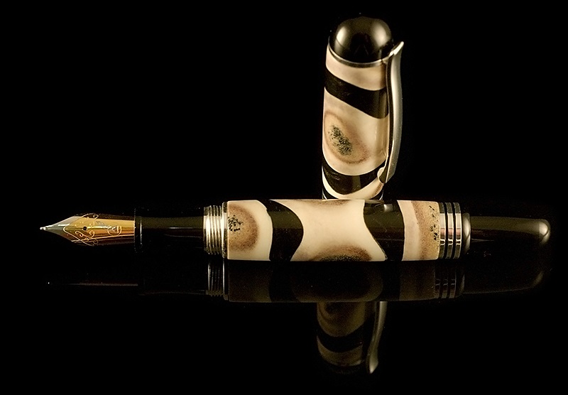

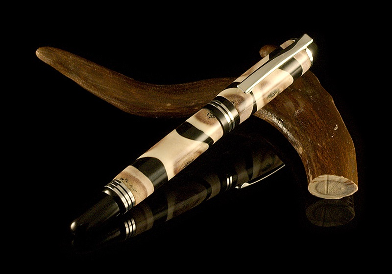

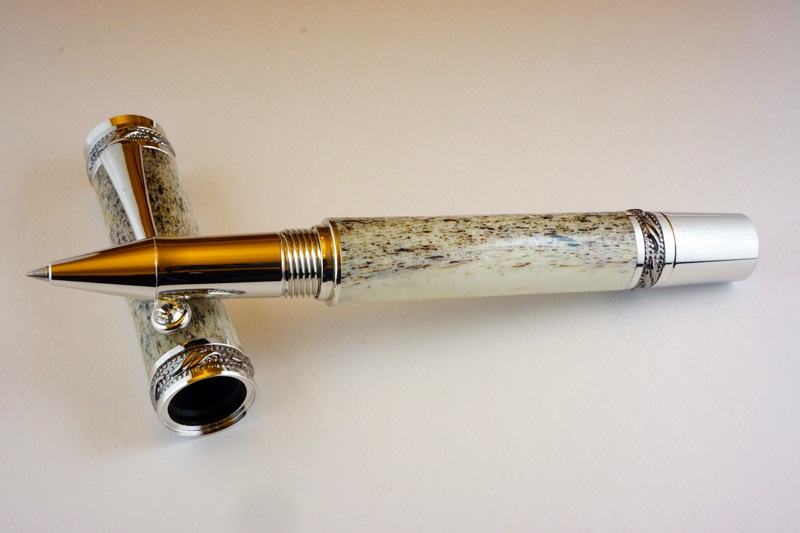

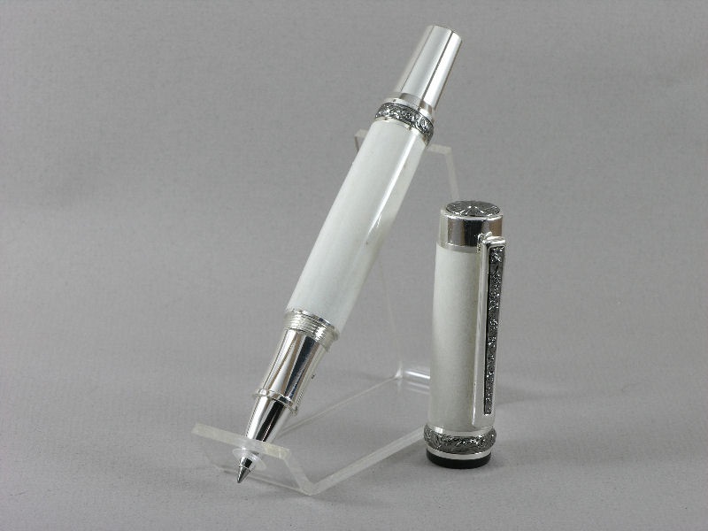

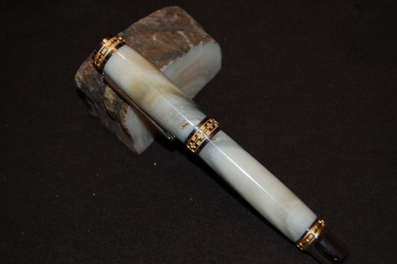

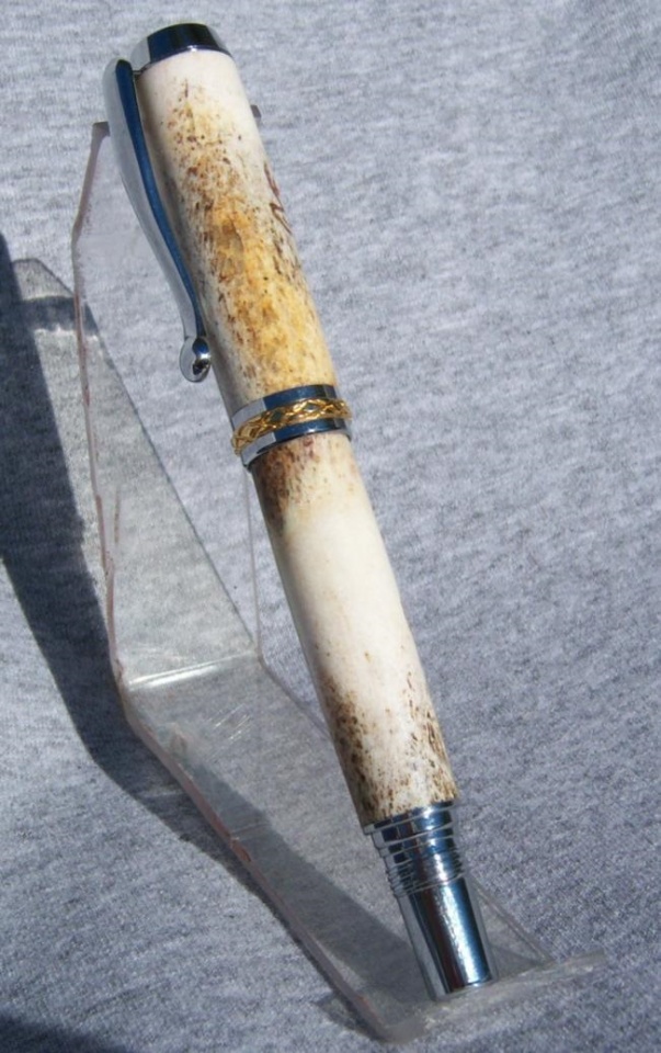

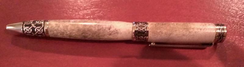

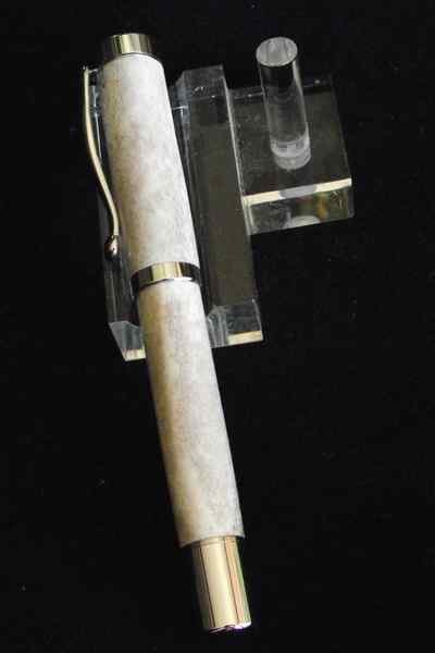

Pen #5

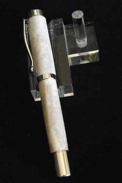

Pen #5

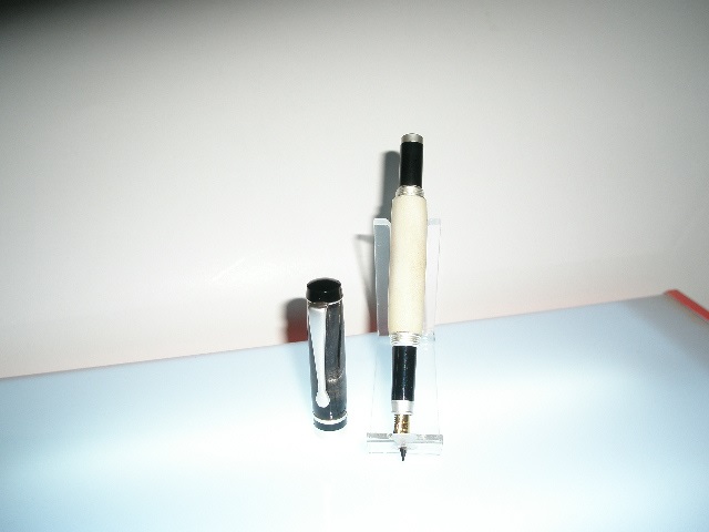

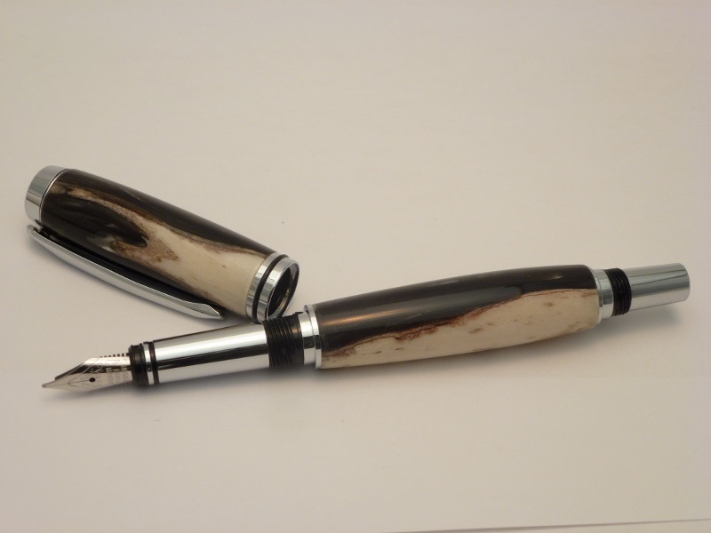

This a PSI Sculpted kit, with white tail antler harvested off of family property in XXXXX, XX. The pen was a gift for my Dad.

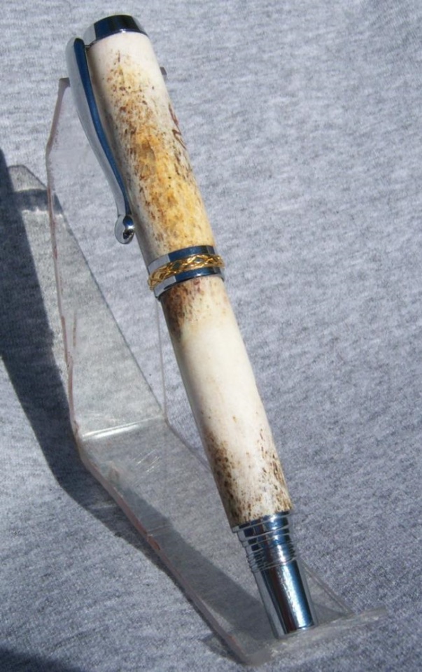

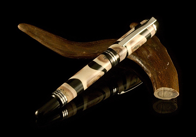

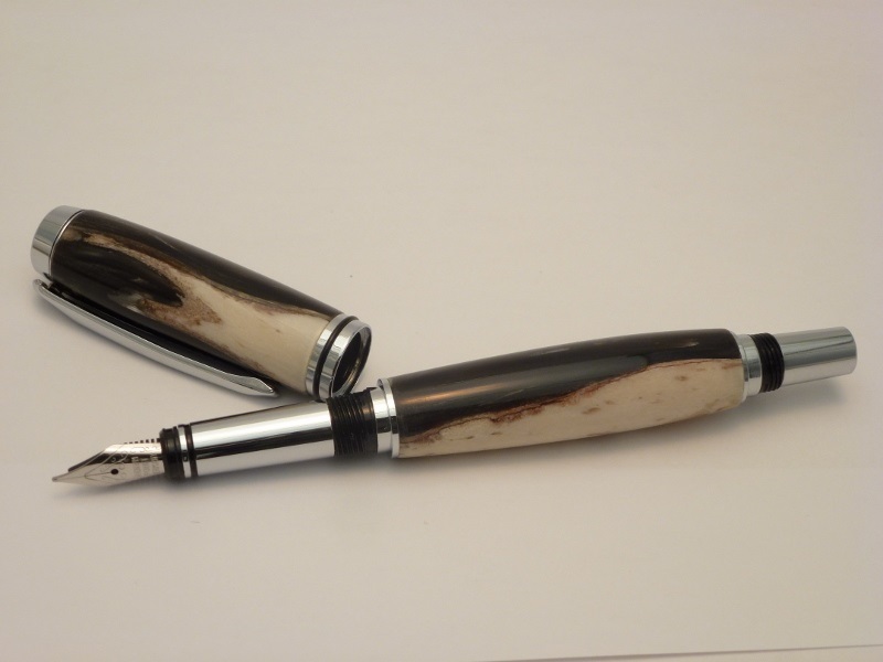

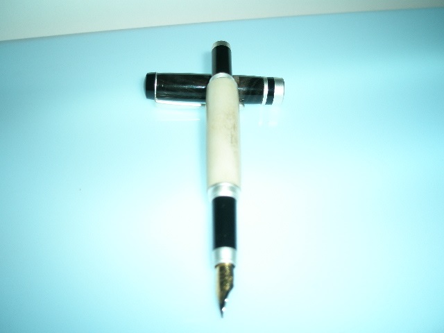

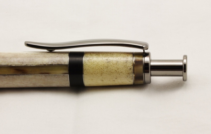

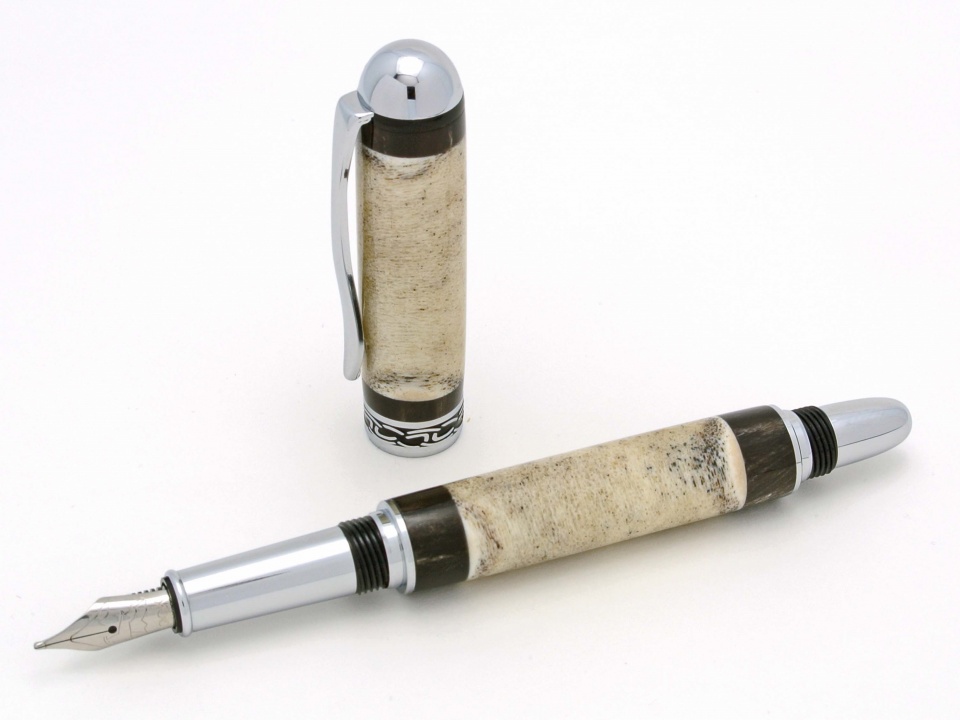

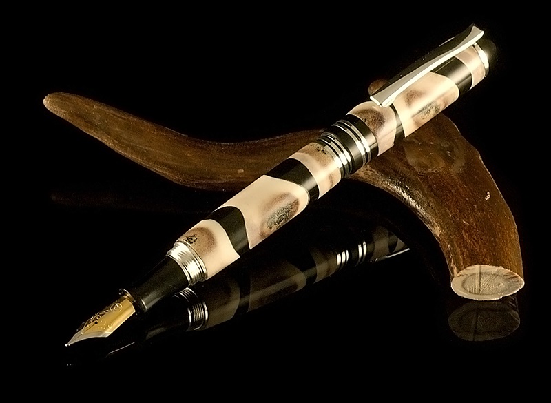

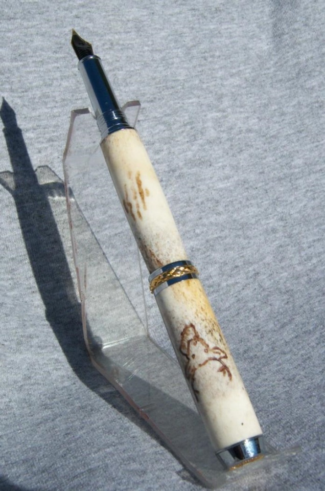

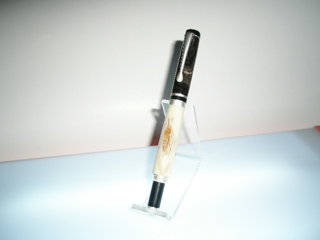

Pen #6
Pen #6

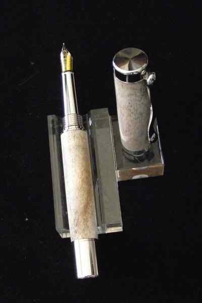

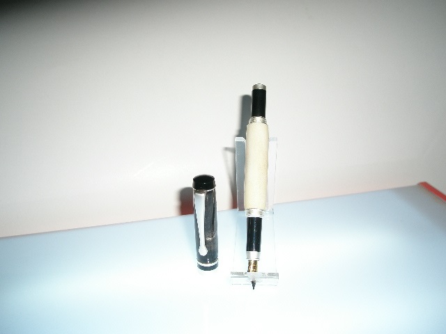

Atrax Chrome Fountain Pen. 100% Deer Antler from a friend's ranch. Item #1 of a set of 3. (Fnt./RB/Ball) Used a light coat of CA just to seal the pores.No other finish.

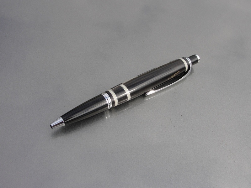

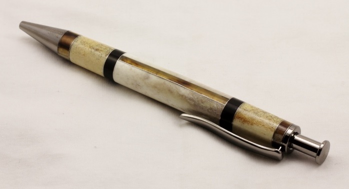

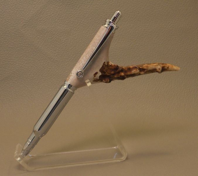

Pen #7
Pen #7

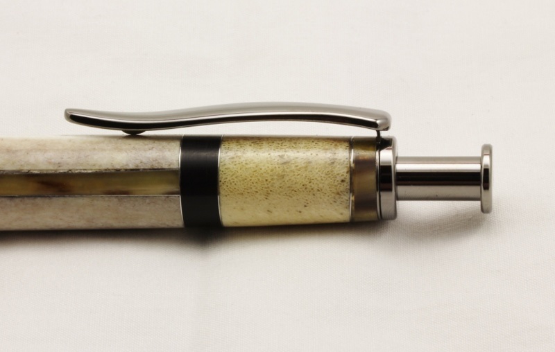

Pen kit: Majestic Roller Ball - Rhodium & Black Ti Blank: 100% Elk antler Finish: CA Details: Antler was radial cut. Stabilized with CA, drill, and tubed. Special attention was kept to keep the cancellous bone in line so that the aesthetic appeal was not lost. Finish to an extremely high gloss. A very attractive full sized pen.

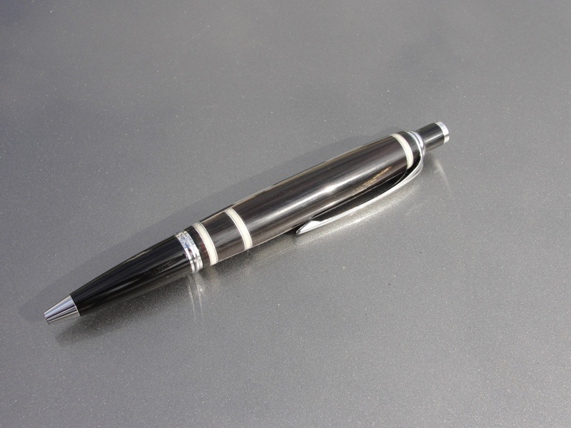

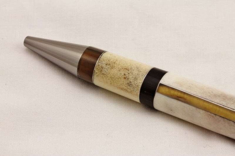

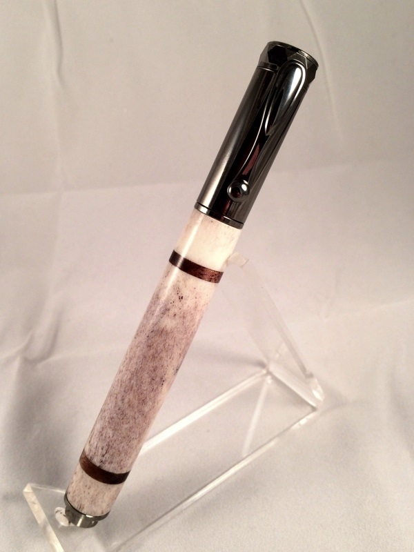

Pen #8
Pen #8

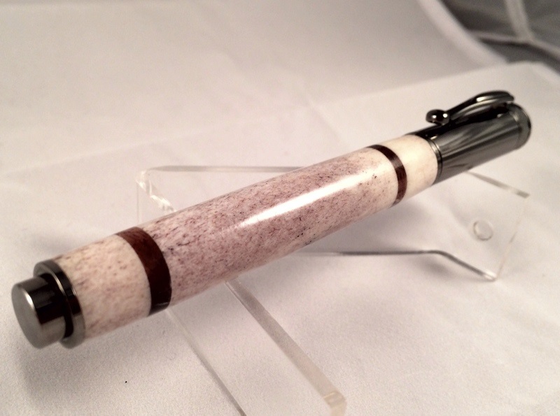

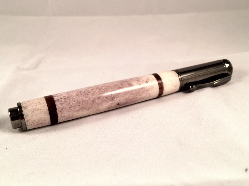

I wanted to do something different that what I normally see with antler. This is a single piece of deer antler with black walnut bands inserted. Finish is CA. Components are black titanium Zen.

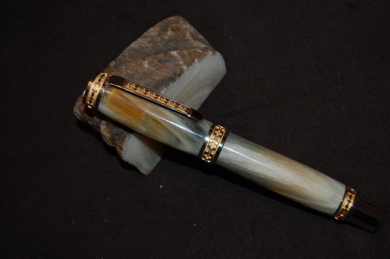

Pen #9
Pen #9
Chrome JR Gent FP kit, made from Bison Horn. This pen is not from the solid tip of the Bison's horn. I made this pen from a section where the marrow bone (white) and the horn's core (black) is separating from each other. This is still all covered by the outer skin of the horn. To keep the white bone and the inner core from splitting, I cut it to Âľ "squire and cast in clear PR under 30PSI. The pressure helped the PR to penetrate into the layers of the bone and the core to make it solid. This enabled me to drill it. Turning it took away the PR except what was pressed into the layers to keep the bone and the core together. Finish with CA and buffed with white diamond and carnauba wax.

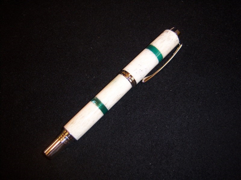

Pen #12

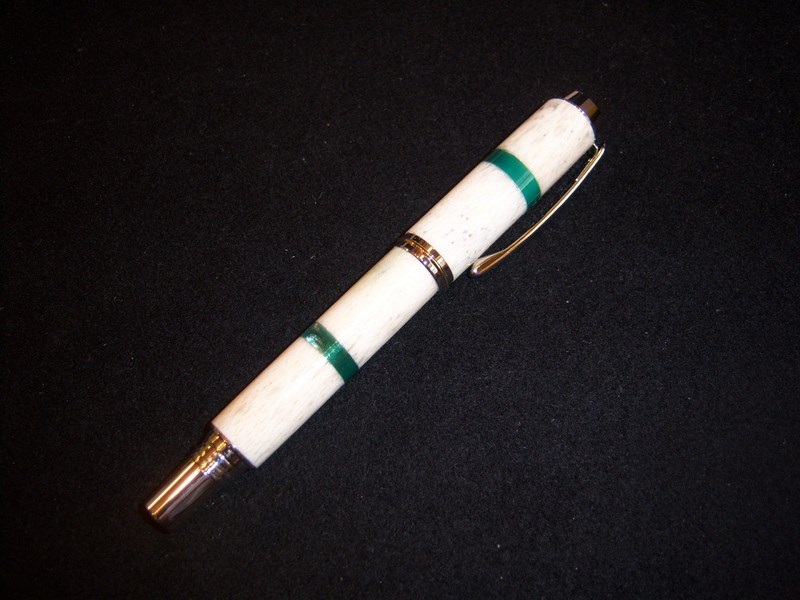

Pen #12
This is a Jr. Gent II dressed in fossilized whale bone and segmented with sea green acrylic. Umpteen coats of ca to keep the bone together and mm'ed to 12k with 2 coats of Hut ultragloss and 2 coats of Ren. wax.

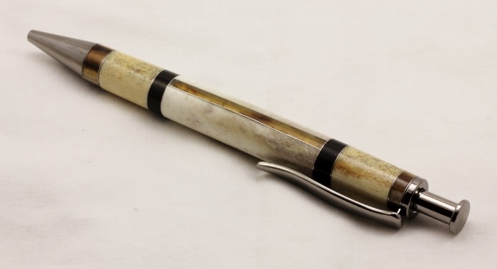

This is a Black Titanium Long Click kit. The blank was made from cow horn, moose antler, deer antler, and some aluminum from a beer can. From either end to the center, the order is: vertically segmented horn, aluminum, moose antler, aluminum, horn, aluminum, then deer antler split lengthwise with aluminum and horn in the middle.

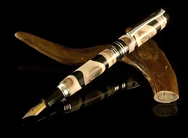

Pen #17
Pen #17
Pieces of Antler cast in black resin with a touch of pearl pigment. Arrangement of pieces makes interesting visual effect. Churchill FPN in sterling silver with Heritance nib.
