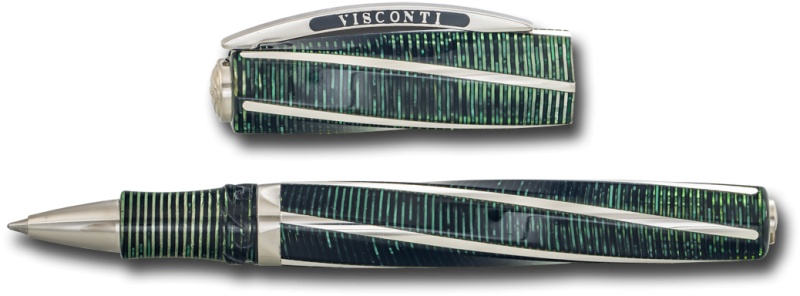

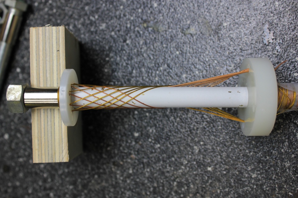

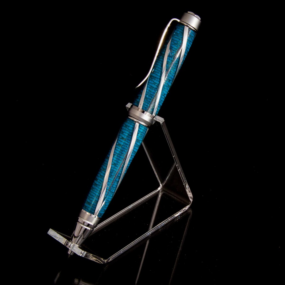

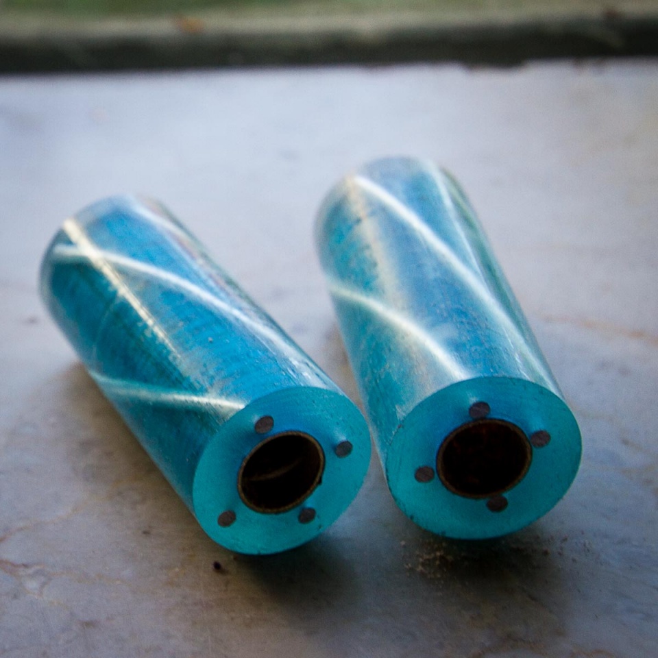

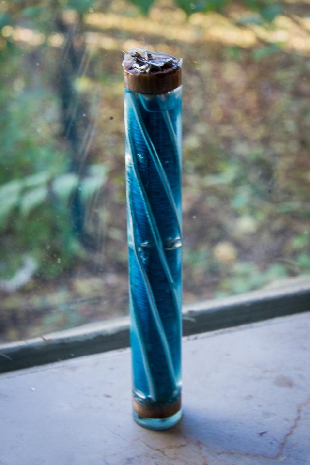

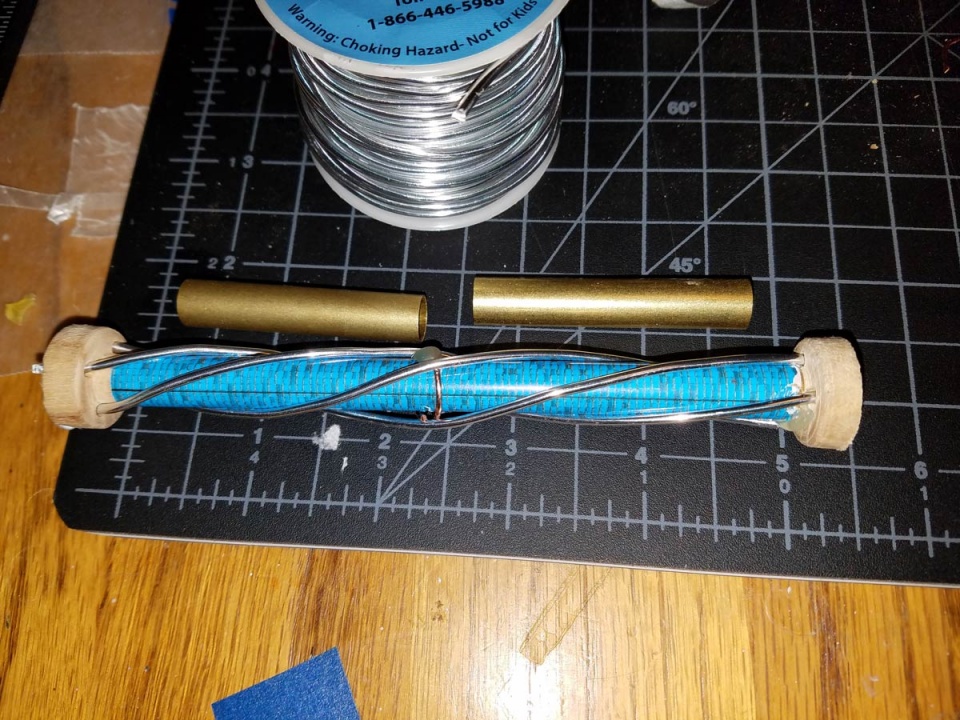

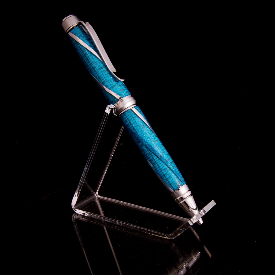

I was struck by a recent Visconti Metropolitan I saw and it got the design juices flowing thinking about how that style could be done with humble basement pen turning equipment... I guess you could call this a prototype in that there were too many unknowns to expect it to work out on first attempt. It's got some issues, the biggest of which is one of the metal strips pulled away and I backfilled with some mica just to finish to see what it would look like. I think I'll try one more round of refinements to my approach and try another to see if I can get one closer to perfect.
I'll post a pic of the Visconti Metropolitan so you can see what inspired me, and a few pix of the casting steps. In the last pic you can see the catch I had that pulled out the metal and the fill I put in.

Well done !!! . That is a very interesting project. . Valiant attempt !!!! . What kind of wire did you use for the spirals ?
I can just visualize the challenge of keeping the 12 ga wire at a uniform, and specific level above the blue core. You had a lot of issues to address as you worked through this prototype. Well done!
I am curious...what is your blue core material? The Visconti looks as if they wound a spiral of thin wire over a green backdrop to get that visual effect.
The background is just a graphic design printed on label paper. I tinted the Alumilte with a little blue mica, which I would do again - it adds just a little sparkle and depth.
I did the math and needed to raise the wire 1mm around the center, so a bit of 1mm copper wire as a "center band" in the blank did the trick.

Great job! Thank you for the process pics - they really help in understanding how you made the blanks. I'd say you made a beautiful pen that pays honor to the original inspiration.:smile:

John - Yeah, I thought about just doing something with a straight profile that didn't need the wire to raise, but thought the curve in the profile might be a more interesting look if I could manage it. The 12 gauge wire is a bit tough to bend and keep straight and smooth - I "pulled/stretched" it a bit to try and get it to lay the way I wanted, so not sure CA anchoring could withstand that, and since my body was label wrapped, I was concerned about getting some CA on the label. Raising the wire up in the middle with a little loop of 1mm copper wire really was no big deal. It looked a bit rag tag/wonky before I cast it, but turned it was much more forgiving to the eye.
I used a skew to turn it, sharpening a couple of times. The top barrel went without incident and I think I might have got a little too confident, too aggressive on the bottom side - that was where my catch was. It was about 1/4 of the way down from the fat end of the bottom tube. The wire didn't come all the way out - just that top 1/4 pulled up. I tried pushing it back in, but it was a bit mangled, so just decided to go ahead and pull it the rest of the way out down to the nib end. Next time I'll just keep reminding myself to take light cuts and sharpen maybe 3 times for each barrel. The catch aside, it really turned pretty easy.

Beautiful work. Innovative too, even if you are inspired by someone else. I love metal wire work in pens. Tricky and sometimes unpredictable but worth it when it turns out.
Thanks for posting this.
