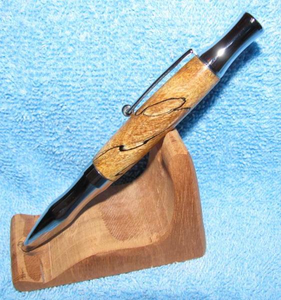

I swapped a few blanks last week with Erik831 on here. I decided that his spalted blank he sent me would look good on this virage pen. Turned it down, wood a little soft, so drizzled a good coating of thin CA on it. Let that soak in for a little bit & then finished turning it. Applied 8 coats of medium CA & then sanded/mm/Hut plastic polish to finish it off.

Looks very good indeed with that virage kit , I still haven't turn any of your blanks, been busy with other orders .
Inquiring minds must know.....what is the timber? Kind of looks like Pecan or maybe Hackberry, but it also doesn't.....go figure?
Nicely shaped and the finish looks awesome from my chair!!!

You were right. It looks good. Nice work.

Spalted wood looks so nice. I love the character it adds.

Indeed it looks very nice on that virage. Nice work!

The spalted wood looks great on that pen. Nice job!

Thanks for the comments Scott! Sorry Scott, not sure on the wood.
Lookin good, Billy!

I just love spalted wood. You did that piece real proud Billy.
