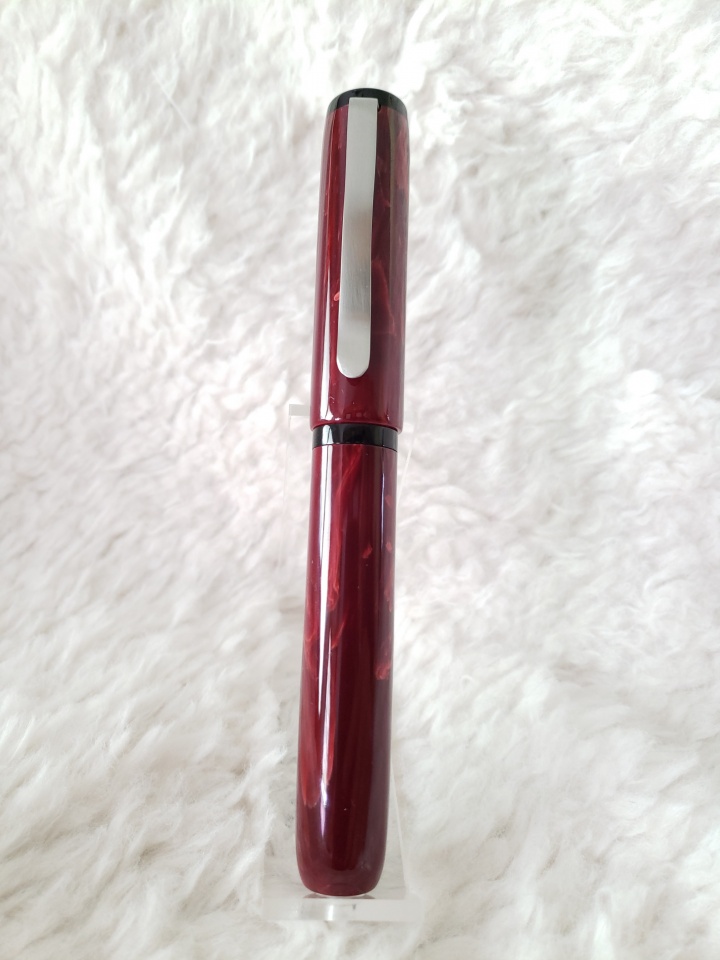

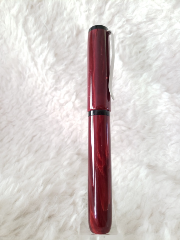

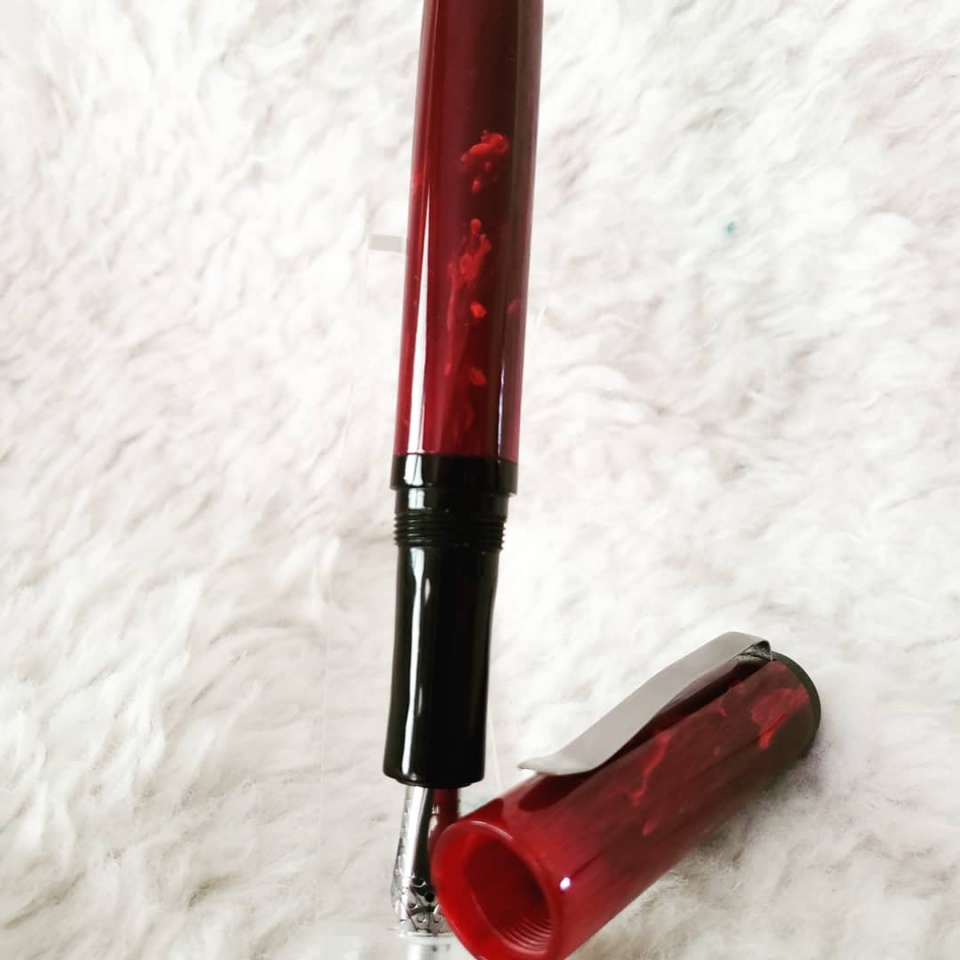

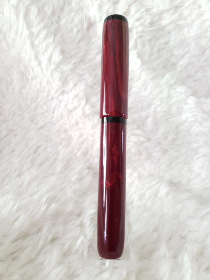

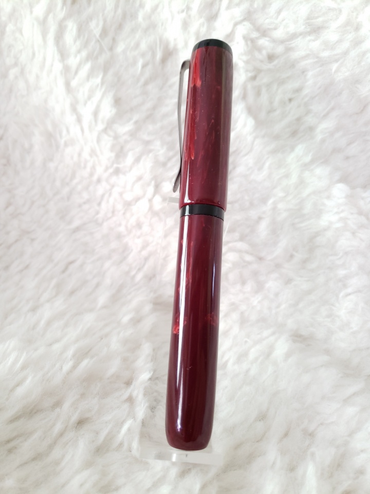

Hello,
It's been a while since I've posted any pics. Been busy trying to improve my skills on kitless/custom.
This is vintage ruby bakelite, black Japanese hard rubber and stainless steel. Everything is made by me except the nib and converter.
For anyone who cares, the nib is a Jowo #6. Cap threads are m14 triple start.
Thanks for looking.

Beautiful pen, Lewis !! . Congratulations !!
Beautiful work! Talk a little about the bakelite...I'm curious about how it turned...?
That is a lovely pen. Well done!
Thank you Mal and Bryan.
Greg, the bakelite was great to work with. I drilled slowly (time wise) with cooking spray as a lubricant so as to reduce the amount of heat. I also drilled with increasing sizes of drill bits until the proper diameter.
The bakelite threaded wonderfully, though as you can see, I didn't make any male threads. I read some posts on here that said the male threads didn't do well. I did all the threading with taps.
The bakelite didn't turn normally. I wasn't getting ribbons but rather dust or pebbles. This is with a metal lathe.
These blanks came from a large 9 inch rod that was over 1.5 inches thick. I split the blank lengthwise down the middle to increase the usable blanks from this rod. I have a lot of pics I could post in a separate thread if someone wants.
LOL to the source request! Bakelite is still plentiful on ebay, for a premium. I'm not sure if all of it is authentic Bakelite or a similar product made from a different company. I think some companies still make it in Asia or India? I've heard that some Bakelite is fragile and will have checks and cracks in/on it, This did not.
When I get time I'll start a thread for cutting up the bakelite, though Mrburls and SteveG have posted their methods previously without step by step photos. Below are links to their posts on cutting it up. I followed Keith's (Mrburls) method.
http://www.penturners.org/forum/f13/rare-orange-bakelite-emperor-63162/
http://www.penturners.org/forum/f18/bakelite-144440/index2.html#post1888123
