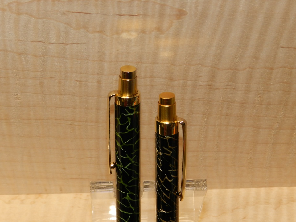

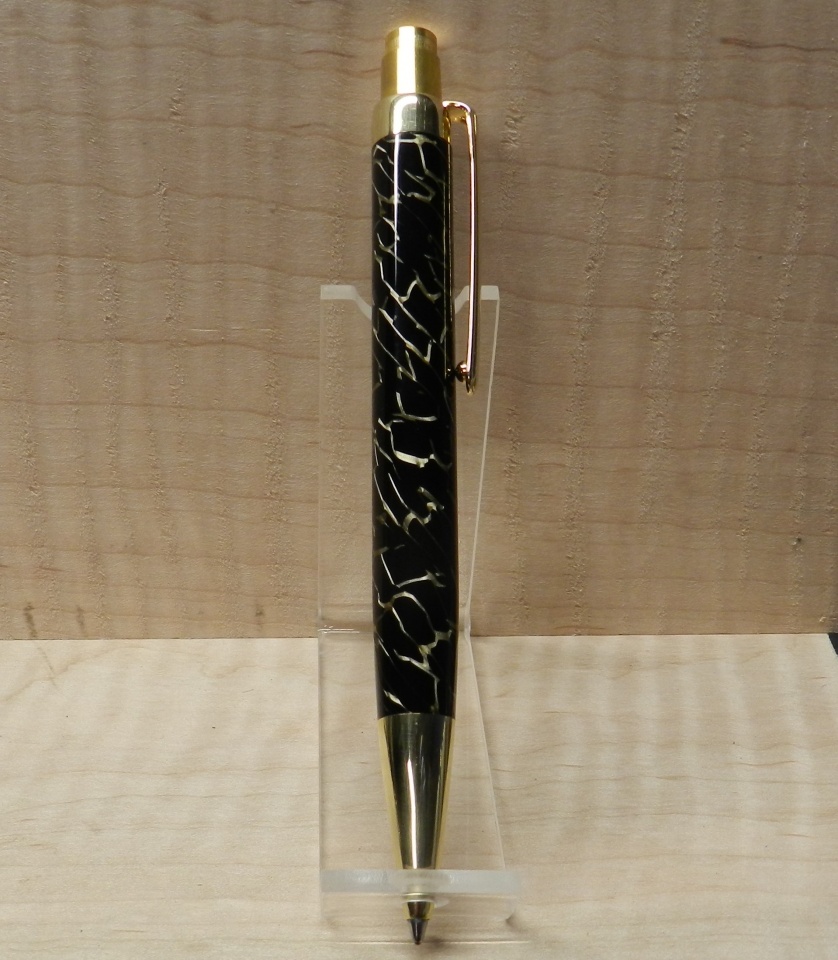

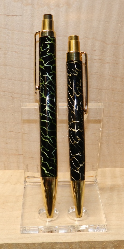

So, I have been refining my kitless clickers. You'll have to excuse the poor picture quality!

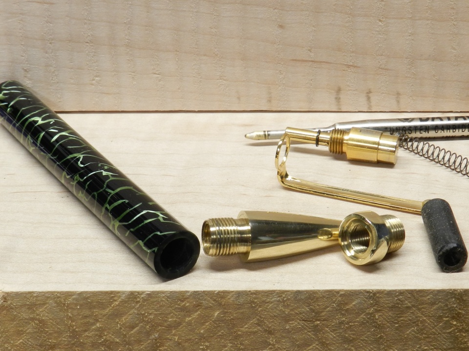

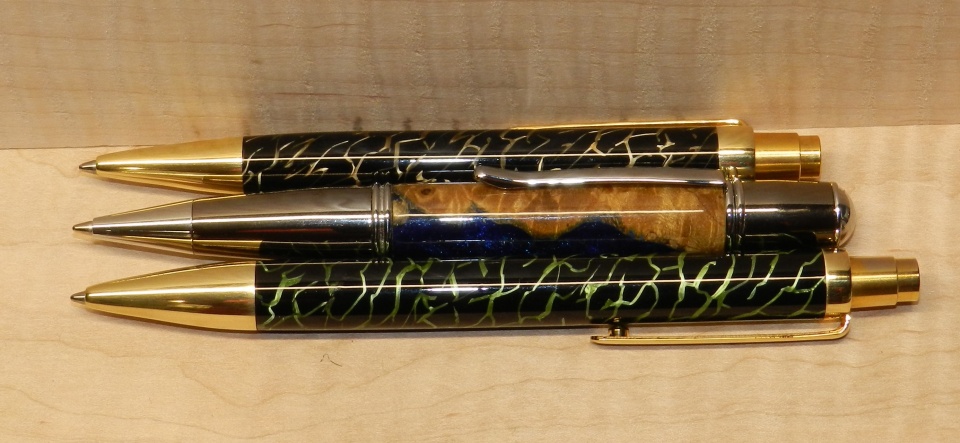

I added a recessed area for the clip to sit flush with the top of the adaptor/finial. I also felt like I wanted a longer version of the clicker, so I added a piece between the clicker and refill to extend the length of the blank.
The black and green cracked ice is the longer version.
nose cone and finial/adaptor are turned from brass rod. The bodies are vintage cracked ice cellulose acetate tubes.

Stunning Kitless Click Pens, Lewis.
Excellent Concept and Execution.
Love the Click, and Clip Retaining Brass Assembly.
I think you are on a Winner.
Congratulations,
Brian.
Thank you for the compliments Mark and Brian! I am really happy with this version. I like the look of the inset clip. I think it gives a much more finished look.
With this method, I also don't have to worry about the diameter of the clip matching the adaptor and body:smile:
