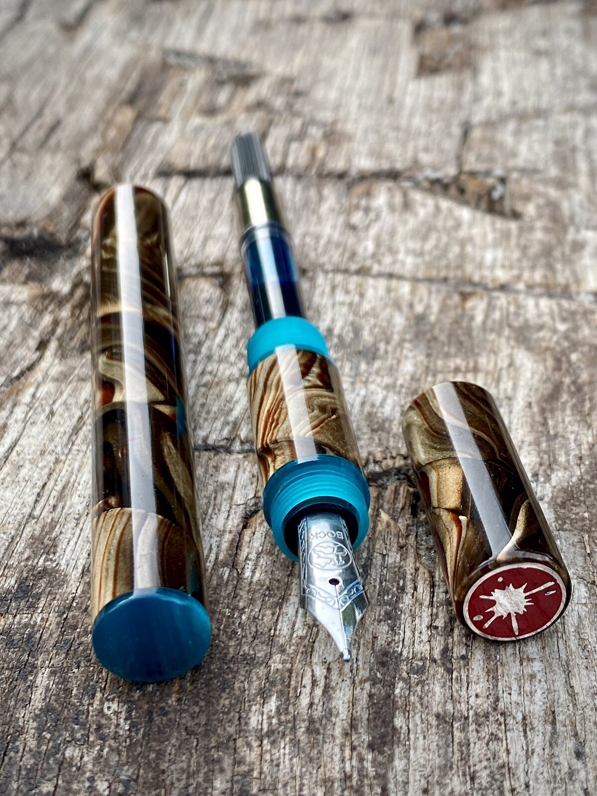

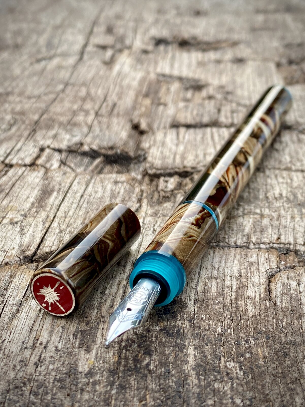

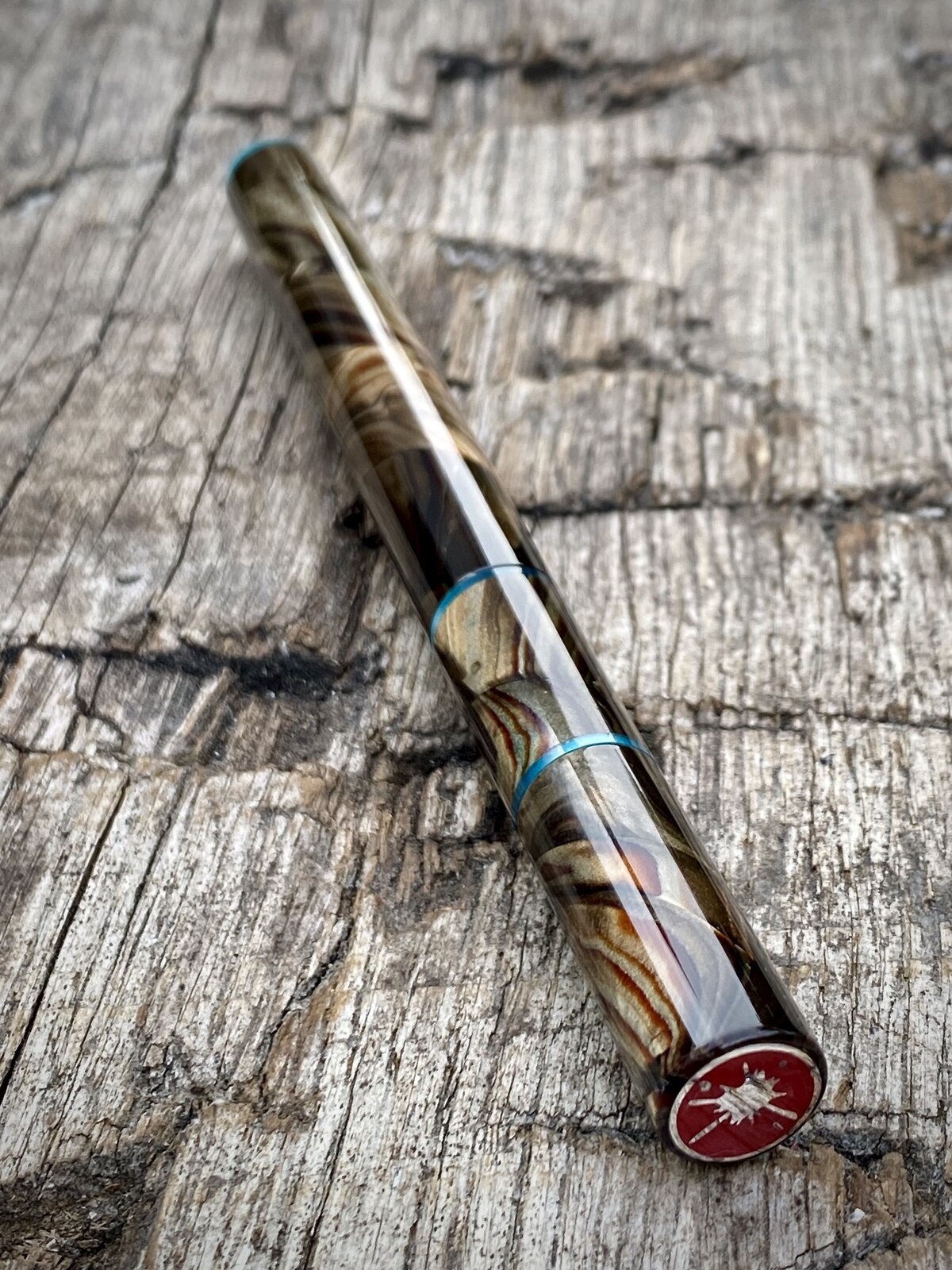

You could make a pen with 12mm threads and have a contrasting colour cap like this (I matched the finial and section to the cap):

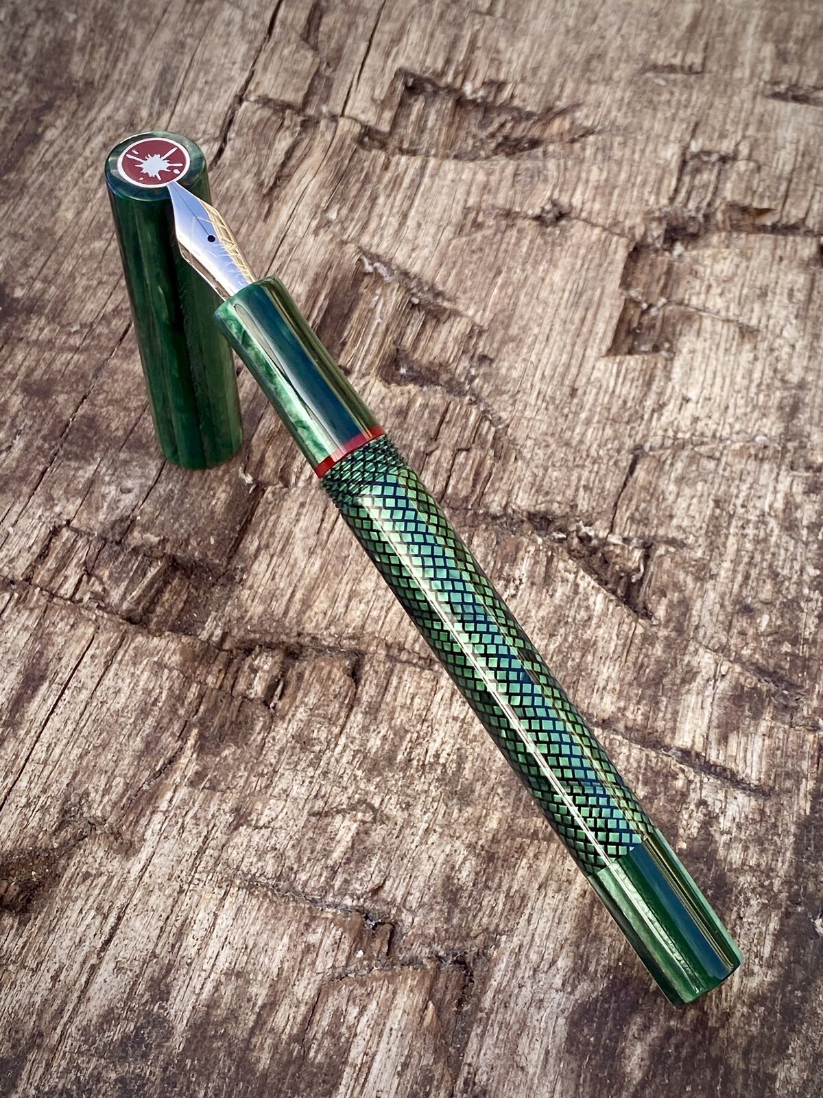

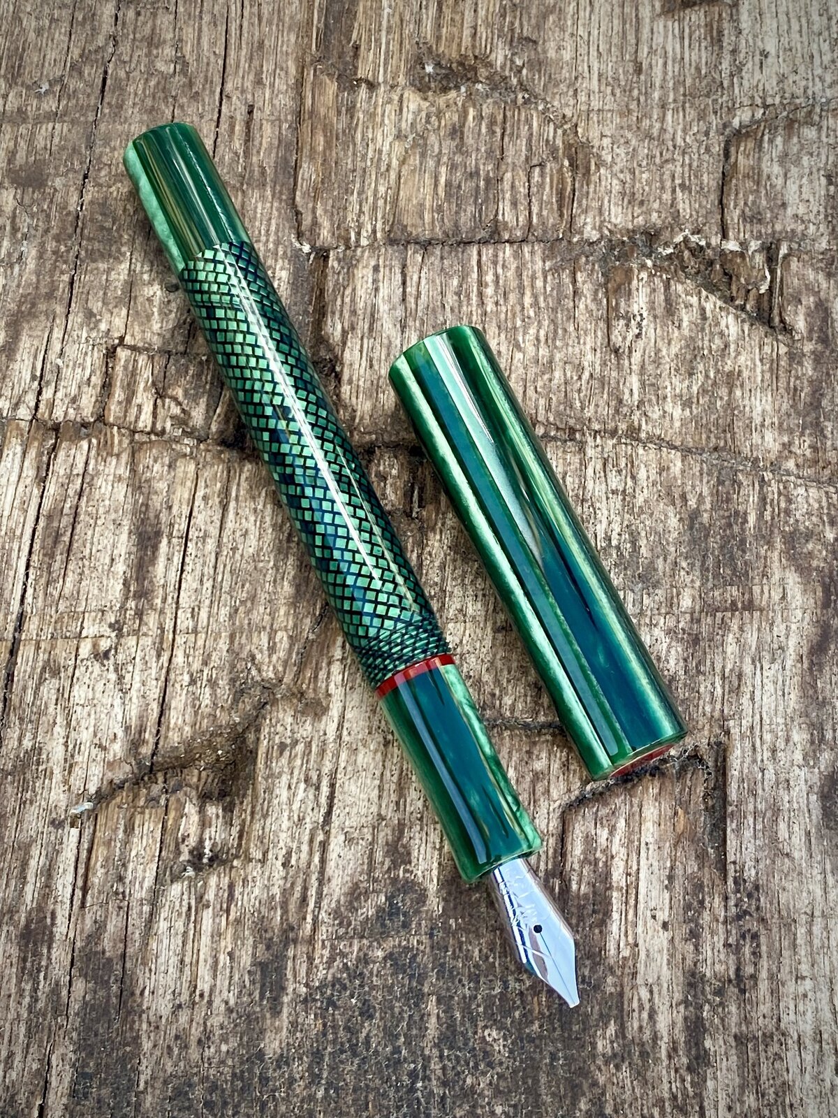

Alternatively you could front thread the pen so the cap doesn't envelope the section but just covers the nib. Like the old fashioned safety pens. This is what I did with thin stock here. It's a bit of work to get the section made but the overall effect is quite nice.
